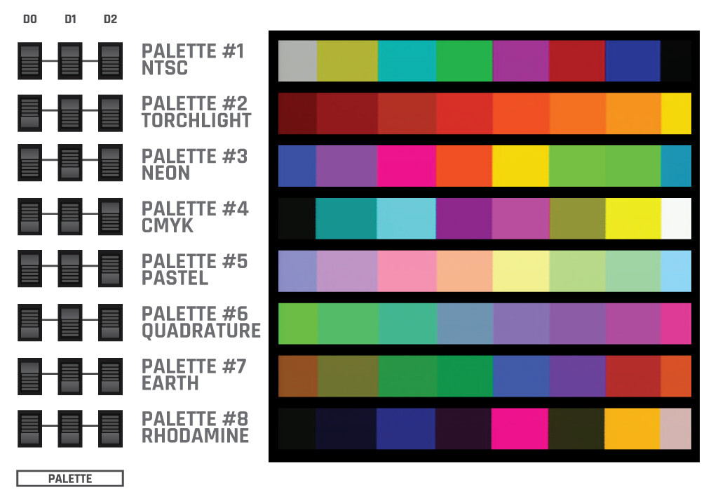

#14 — bentoncbainbridge · 2020-11-10
Question on the palettes… Can these be modified beyond the preset options? Any chance of a Castle Color LUT module for dialing in palettes ?
#15 — Z0NK0UT · 2020-11-10
The Fortress palettes are preset. You could of course modify with Mapper or other processing.
#16 — bentoncbainbridge · 2020-11-10
I’m currently experimenting by pairing Fortress DAC output with Octal Quantizer and Topogram before sending through Mapper and Color Chords.
Any chance that the CPLD pins allow for customizing the palettes?
:wink:
#17 — Rik_bS · 2020-11-10
Could you take the DAC output, put it through a Castle ADC then the 3 outs of that in to a Color Chords or other RGB Matrix?
#18 — bentoncbainbridge · 2020-11-11
I’ll try that, @Rik_bS!
I’ve found many ways to change the colors post-Fortress. I like the specific look of the colorization of the 8 preset Fortress palettes, I’d just like to be able to program my own palettes.
#19 — joem · 2020-11-11
Unlikely… LZX (understandably) don’t usually release the code to their modules (they just release the compiled firmware when necessary). They’d probably need to release the code in order for you to add custom palettes to Fortress’s CPLD.
