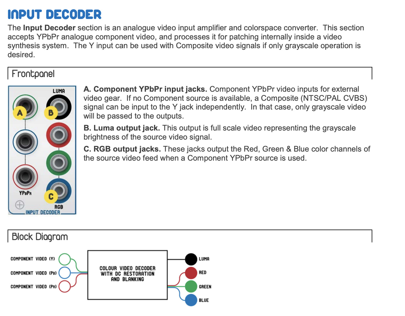

This section of the Visual Cortex:

be recreated in code on VCV Rack? Load a video, then output luma / RGB where each of the four outputs are a 0-1V signal? My mental model of what that bit of Cortex is doing is to “decode” the video signal into its parts, then output each part as a separate simple wave, with sync on its own channel as well. Analog video signals are luma - color - sync, just all encoded cleverly in a analog signal (Wikipedia is awesome).
I’m positive I’m oversimplifying something or maybe missing some big chunk of concept…but…maybe this is possible in code? Vizzie / Max is doing something or other when they turn video into Max signals…so…seems like something VCV could do, with the bonus of outputting it into modular via ES-8/9. That would be neat.
Yes, this is basically correct. For a composite signal (where all the video information is encoded on a single wire) Visual Cortex basically extracts the sync pulses and averages out the color subcarrier to extract the luma, all done with high frequency analog circuitry. This is basically also what some electronics in the Vidiot do to get a 1V luma signal from a composite camera input. YPbPr decoding is somewhat different, this is more like sync extraction + color space conversion to get Luma + RGB from a Luma/Chroma representation.
However even a single extracted luma signal contains information at very high frequencies for a CPU or audio DAC to handle: LZX signal paths are designed to handle signals from DC to 10 MHz, as images with a lot of horizontal detail can wind up having frequency content up to several MHz, and there’s no way VCV can do real time processing at a sample rate that high. A computer is probably always going to have to deal with emulating analog video behaviors via digital image processing tricks, rather than working with video-rate signals directly. Something like Memory Palace is also working with whole video fields or frames internally so that it can do image processing via matrix arithmetic rather than having to process native analog signals.
Your best bet for getting digital imagery out of the PC and into your LZX system is probably to use an HDMI output and an HDMI to YPbPr converter box, then sending YPbPr to Visual Cortex for decoding into patchable full color video. This works quite well for me! The converter box just shows up to my computer as another display.
Basically computers generally don’t bother with modeling video signals that advance one scanline at a time, they instead operate on whole frames. This is probably also true for whatever representations Max etc use for video signals.
