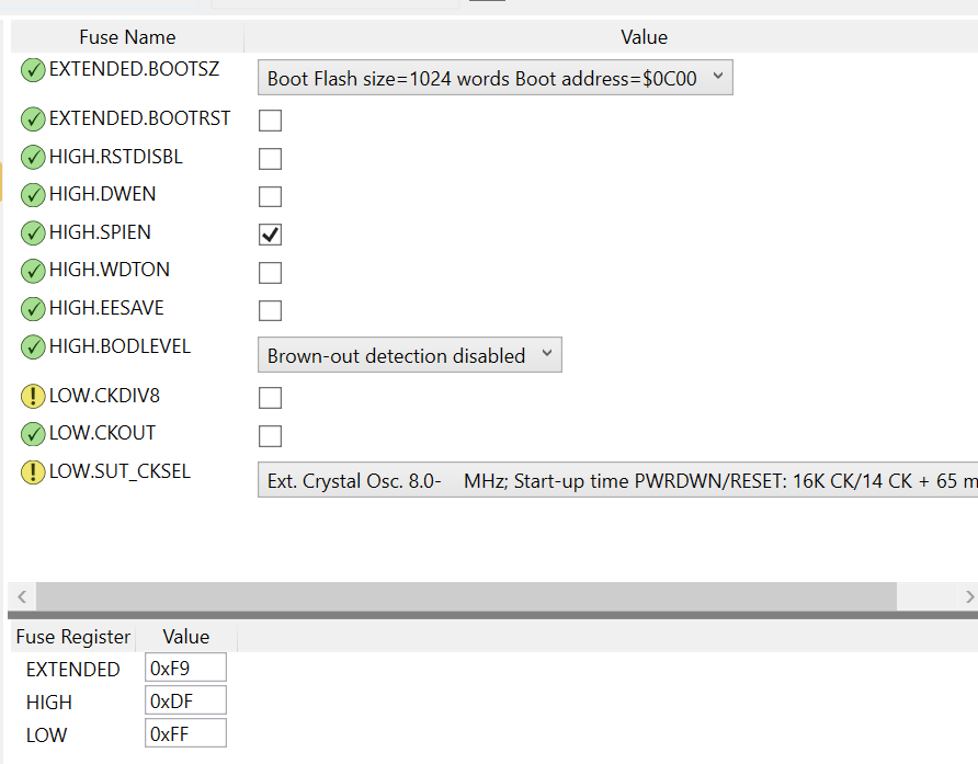

#13 — creatorlars · 2019-03-17
Sure, here are the correct settings (you can see the yellow icon on the ones that are changed vs the defaults):
fusesettings
#14 — Scan_Smith · 2019-03-18
Success on the Syn Gen! Getting 15.7 on hsync.
Here’s the command line I used for AVRdude:avrdude -V -p m88p -c usbasp -P usb -B 1 -U flash:w:LZX-C1-SW-V1.0.elf -U efuse:w:0xF9:m -U hfuse:w:0xDF:m -U lfuse:w:0xFF:m
