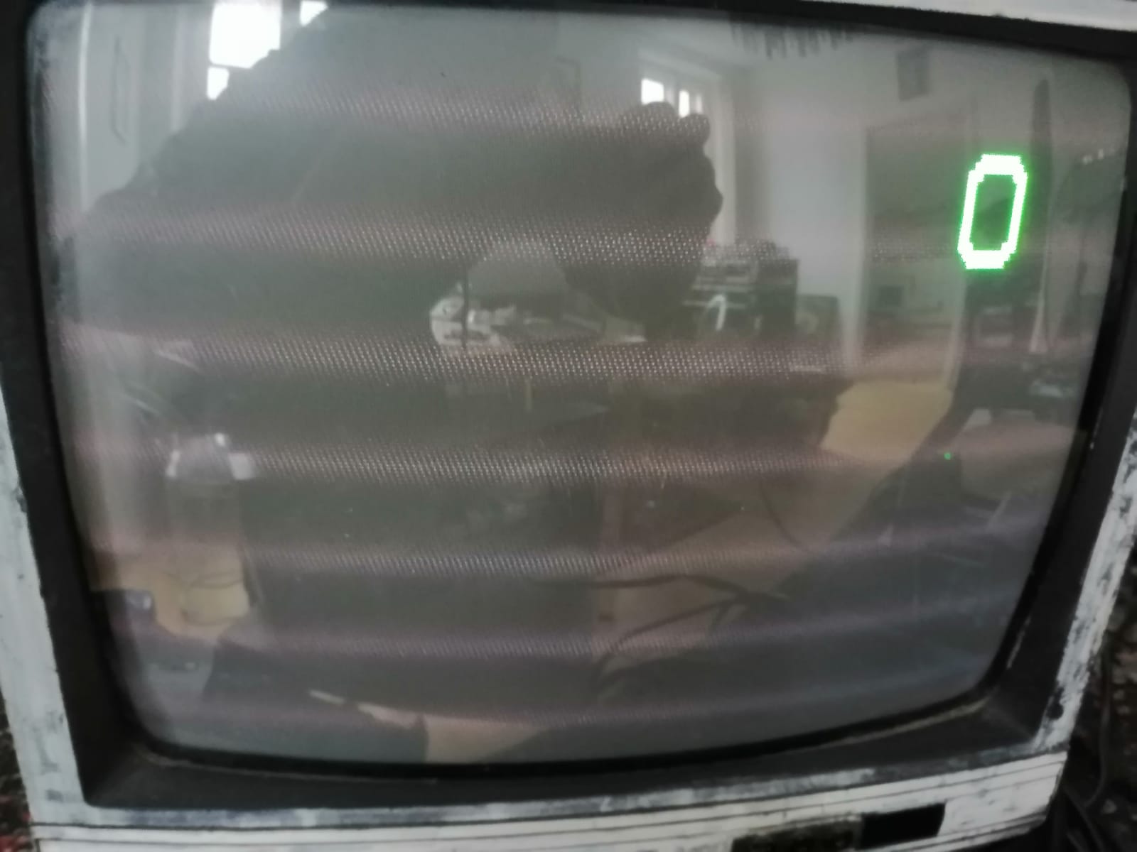

I reflowed some points on the RGB Encoder, and checked everything around the rbg to composite encoder and the crystals. The parts placed seem to be correct and i got something like this:
02
The image quality is kinda crap sorry about that, i was in a rush. Those are not white bars they are rather reddish/pink. But im still getting only this output, it does not matter in which color i plug the vco.
Next up im going to check everything again according to the BOM and Schematic and reflowing every single spot.
