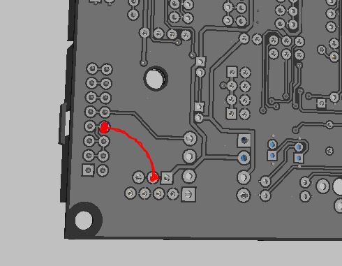

#5 — creatorlars · 2019-04-21
Looks like you’re correct! C2/C6 and the EuroRack connector are missing a GND connection on the C2 PCB. And Joe is totally on the ball here with his theories. This is a bit of a nonissue in terms of correct operation for most, because you’re always going to be using this module with the 14-pin sync ribbon, and will receive system power and sync ground through the power ribbon and sync ribbon on those modules (which is explains why we never noticed this.) Still bad practice though of course, because you want those return ground connections going back through the ribbon with the power connections. Here’s an easy wire lead kludge for your C2:
Capture
I’ll make sure we clean this up in the next revision.
