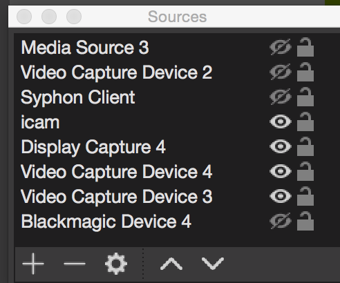

OBSOBS
with OBS you can do a good deal of keying (chroma and Luma) to an incoming signal
you can also create feedback by doing a display capture and then centering the window over the workspace
video looping is as easy as drag and dropping then setting the loop
it can also be used for streaming and recording inputs from syphon or otherwise
58%20PM
OBS feedback

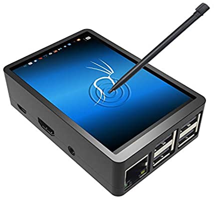

Raspberry PiRaspberry Pi based video devices have been popping up in several places
Hardware to get you startedraspberry pi 3b,
keyboard, microsd card,
MIDI controller (korg nanokontrol 1 or 2 work well),
USB thumb drive, USB camera (this is what I use works across the devices), USB input device (this one works across all devices for me), composite output cable (this isn’t the one I bought but I can’t seem to find it anymore sometimes you may have to use the red output instead of the yellow if you are having trouble)

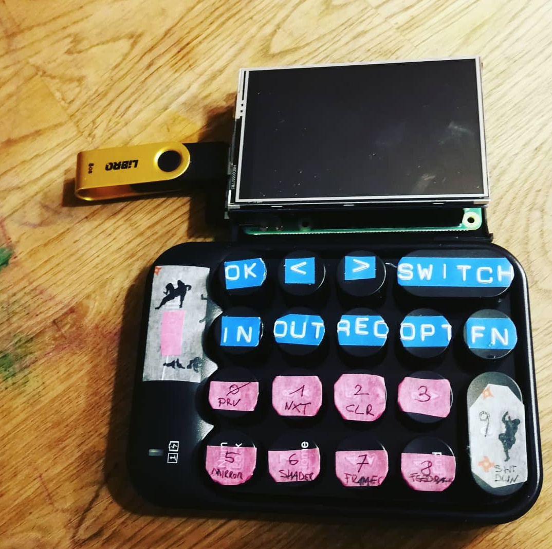

Extra info & moving forwardThere are several different people working on these projects all of which are open source I believe. I’m trying to use similar MIDI device and layouts as the other people too so that you can easily switch between things. Additionally I’ve bundled what I’m doing with one of the other makers as we have a similar hardware footprint.
So if you go the the scrawl readme (github) there are links for an image file which contains installed versions of scrawl, spread, spectral mesh, and waaaave_pool and an easy way to switch between them via mouse and keyboard.
I’ve got another app to put out soon here based on a variable quadrants/mirror/multi type effect then i’ll bundle the newest waaaave_pool and chromatic aberration
We will just keep growing this ecosystem of free video gear based on the raspberry pi
I know once I get all my pieces I’d like to put together a larger system that contains my drawing, colorizer, quads, and a strobe one I haven’t started on yet as I would really like to do a whole V4 type effects section with extras that would need a larger/different controller though

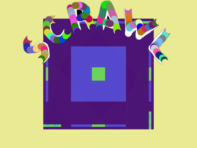

Scrawl
scrawlbackground3
you can find the image linked in the github readme with some instructions
if you are loading the latest image it will include several other apps installed (all also listed here) with .sh files on the desktop to switch between them (press escape to get to the desktop once it has booted)
or you can download the source and load it up on an older image if you already have one
Scrawl is a standalone RGBA shape generator/positioner with painting capabilities, full MIDI/keyboard and some mouse control for the Raspberry Pi (currently using 3b+(old hardware version)/3b).

Spectral_Mesh
Screen Shot 2020-04-22 at 11.16.24 AM
(picture by https://www.instagram.com/andrei_jay_creative_coding/)github for all your information
manual

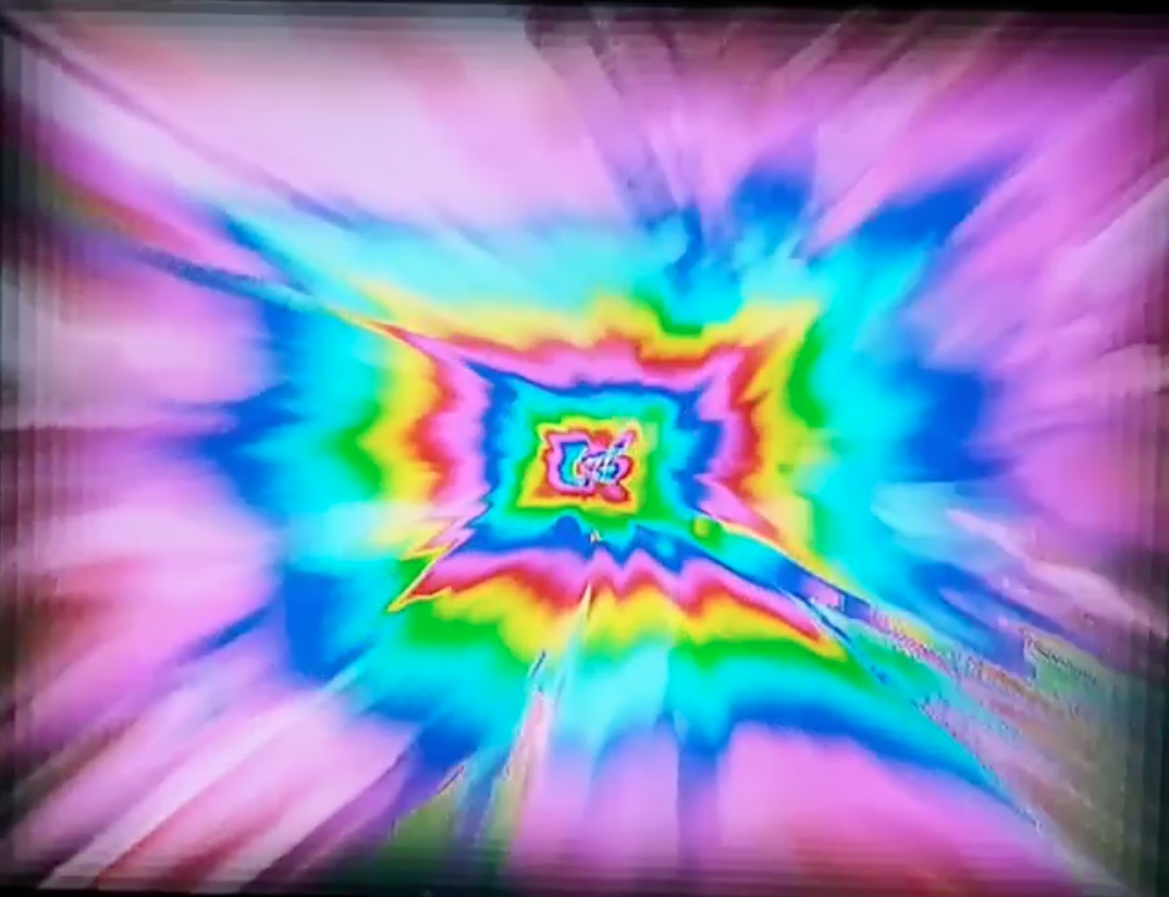

Strange Loop
Screen Shot 2020-04-22 at 11.05.58 AM
(picture from https://www.instagram.com/melt_dream_/ )a fantastic video feedback machine with joystick control
github
Etsy
strangeloop hashtag not all related

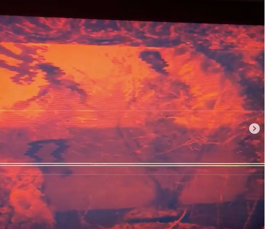

r_e_c_u_rA feedback/shader player/sampler with a neat interface
Screen Shot 2020-04-22 at 11.02.17 AM
(picture from https://www.instagram.com/lesz2537/)main github for all your information
facebook group
r_e_c_u_r hashtag
Recurboy
Screen Shot 2020-04-25 at 9.53.05 AM
(picture by https://www.instagram.com/altable/)I haven’t played with this one at all but it seems like an awesome workshop version of recur with physical controls!
info github instagram

#7 — Genlok · 2020-04-25
There are several good ones on Amazon, I suggest getting the ones that come with the screen in you plan on using r_e_c_u_r.
I use this one
amazon.com
https://www.amazon.com/dp/B07N38B86SBuy for Raspberry Pi 3 B+ 3.5 inch Touch Screen with Case, 320x480 Pixel Monitor TFT LCD Game Display [Support Raspbian, Ubuntu, Kali, RetroPie System]: Computer Components - Amazon.com ✓ FREE DELIVERY possible on eligible purchases
Link: Amazon.com: for Raspberry Pi 3 B+ 3.5 inch Touch Screen with Case, 320x480 Pixel...
#8 — wednesdayayay · 2020-04-25
https://www.amazon.com/gp/product/B07D5FVLGN/ref=ox_sc_act_title_2?smid=A2NBN5PD2G7LDZ&psc=1 these basic ones are my favorite that I’ve gotten so far
#9 — Genlok · 2020-04-25
I have that one too! Great case.
