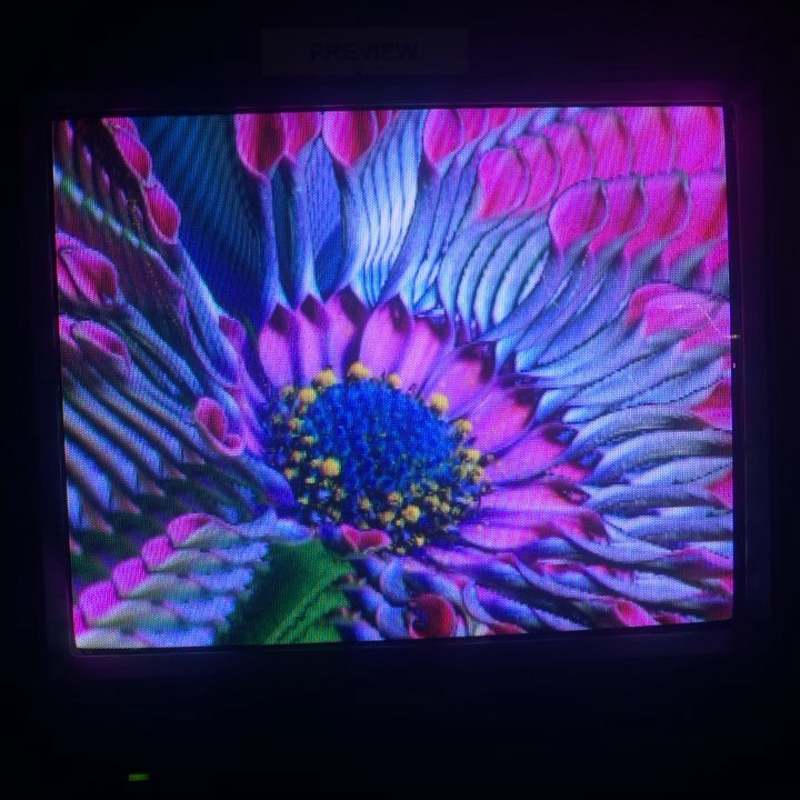

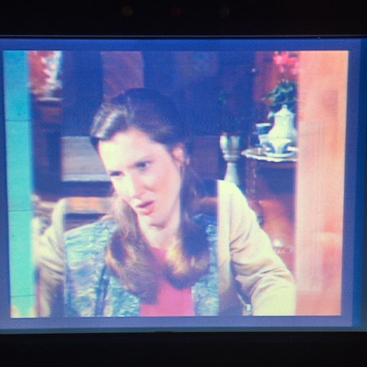

memory palace loves incoming video signals
I will say starting out with something like a single ramp helps to understand some of the basic functionsI haven’t tried tempo syncing anything so I can’t really speak to it
instagram.comhttps://www.instagram.com/p/BxjXEPUhnNX/image
https://www.instagram.com/p/BxjXEPUhnNX/38 Likes, 0 Comments - Nichole Pichon (@nicholepichon) on Instagram: “#lzxmemorypalace #sleeproutine #flowers #lzxindustries #lzxvisualcortex #brownshoesonlyvideogrip”Link: Nichole Pichon
as you can see in this video though MP responds to incoming CV nicely I was using the X axis of a joystick for both the zoom and (and inverted version of the X axis) rotation
