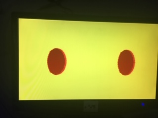

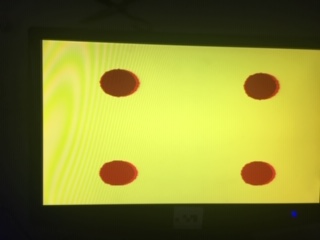

#4 — pong · 2019-07-15
regarding to the first patch in the video : as i understand there’s no need vor navigator if i just want to scale a shape… but do i need the cholor chords? does it sum up the h and v output of shapechanger again?
my shape is really chaotic and not that clean if i patch it like that:
V.C. h, v ramp out >>> S.C. h,v ramp in >>> S.C. h,v ramp out >> bridge mixer>>BR.mix out>>V.C. channel b in
… if i use S.C. gradient out>>>V.C.channel B in, the shape isn’t that clean either…
So what is the missing part? And is there a way to get the same results just directly out of S.C into V.C?
thanks a lot !
modulargrid_52787
#5 — pong · 2019-07-16
okay peopz, figured it out by accident! it works this way! the missing ingredient was to switch on both x and y mirror on shapechanger… and depending on the ramp mode on visual cortex the shape is between one in the middle, 2 or 4 near the edges…depending on the ramp mirrors.
