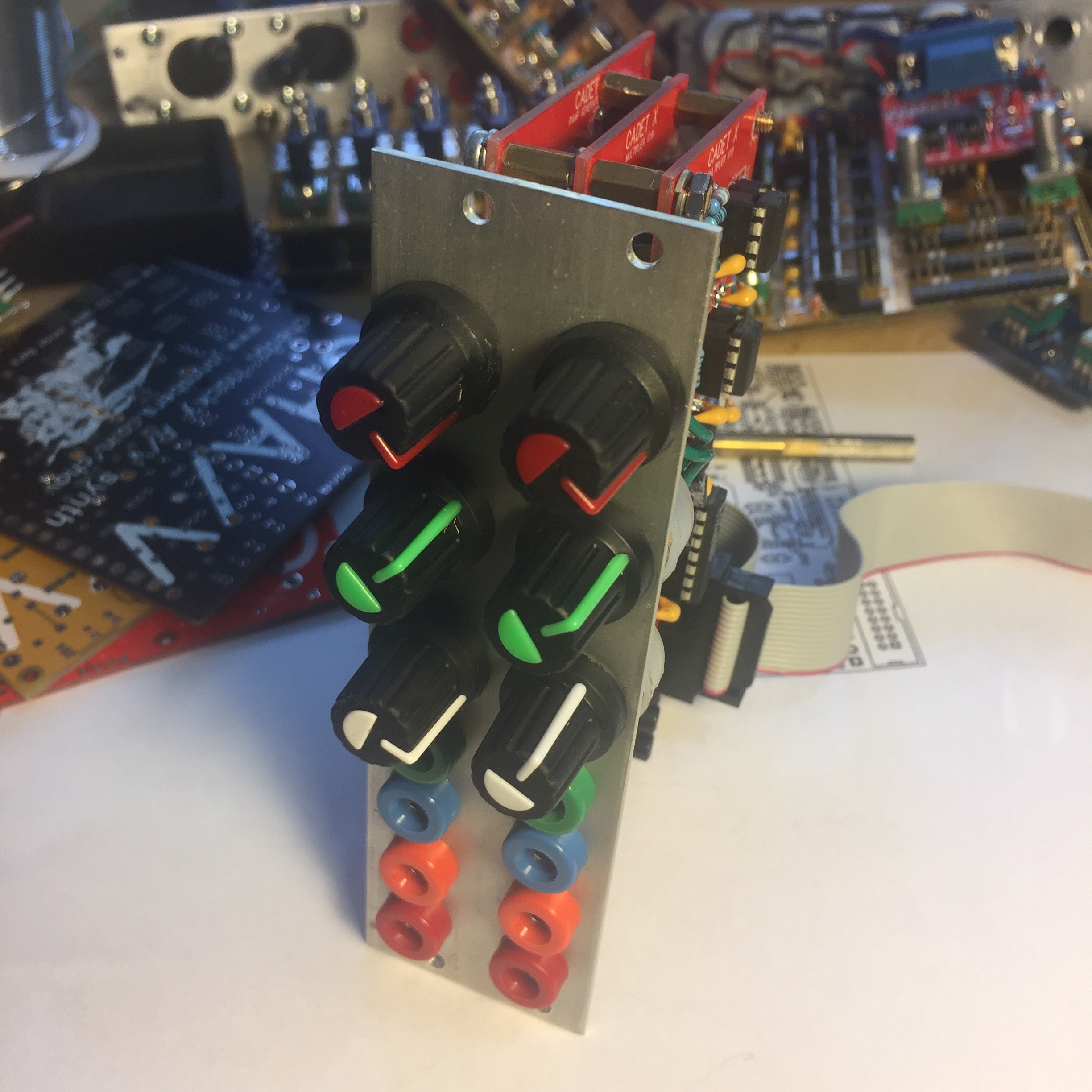

I’ve been busy working on all sorts of other things, but I haven’t forgotten about this. Here’s a mockup made from a stack of cadets that I’m going to play with for a while and think about. It’s a pile of a C4 and two C10s with some other doodads tacked on. The controls are global amplitude, multiply, and bias. The I/O jacks are voltage control for the multiplier bias (not a stock feature of the C10), multiply out (morph between triangle and circle), ramp out, and triangle out.
IMG_6491
#25 — joem · 2019-09-29
That’s bananas.
:smile:
