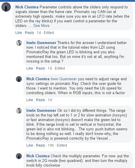

https://www.facebook.com/groups/lzxindustries/permalink/1234029640101687?sfns=xmwaHello, I just receive the MemoryPalace and it is working great so far. I also own a PrismaticRay and I wanted to get it working with the MP. Is that possible ?
I tried to use the Prism to control...
Link: Irwin Quemener

Hi guys, and thank you for the answers.
I’m still not able to have the green light blinking. I’m using some RCA cable (the yellow one) which are maybe not good enough. I haven’t bought the one from LZX so the sync is apparently not working. Are the needed RCA for sync specific ?
PS. It’s me on facebook as well. I posted on both, sorry for duplicate. His suggestion doesn’t make it here also…

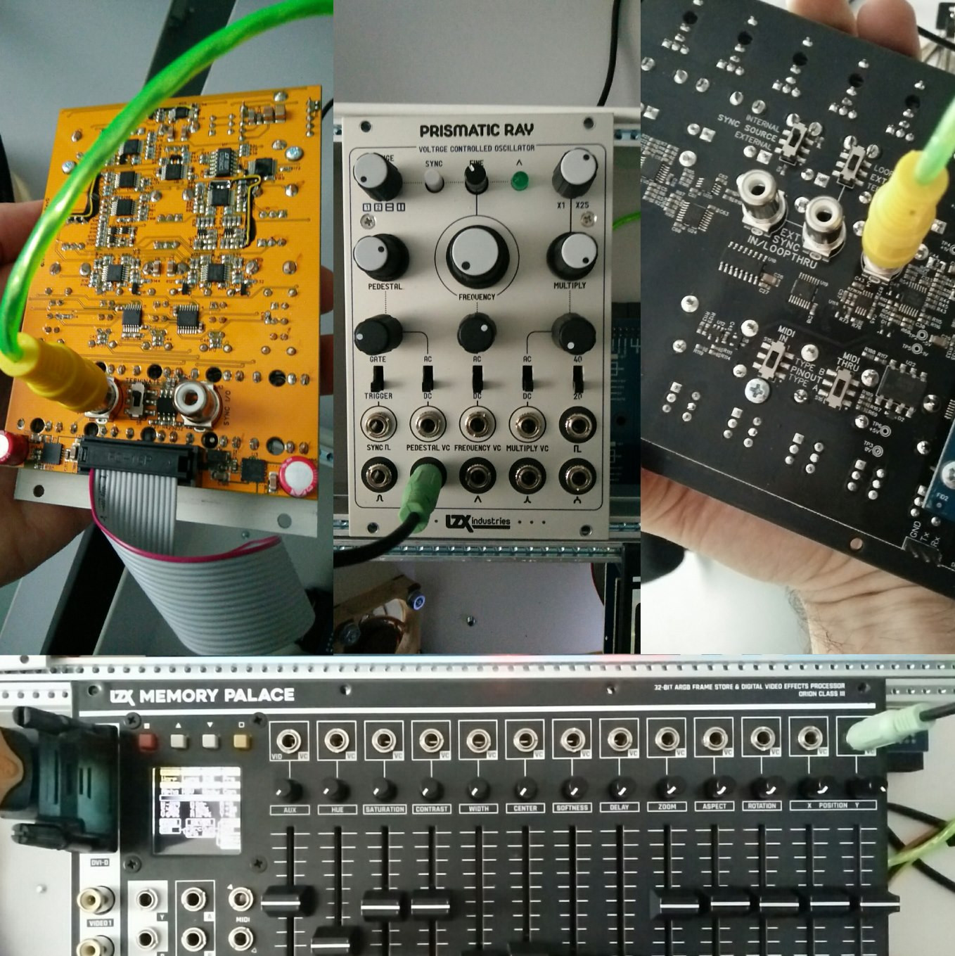

#7 — lecloneur · 2019-07-05
Here is a photo of the current cable setup. Anything wrong you think ?
Thanks! Pouet%20Pouet|499x500
#8 — Z0NK0UT · 2019-07-05
The sync connection looks correct. Does the Prismatic Ray’s LED light up in any configuration? If not, it might be dead. Where did you get it?
