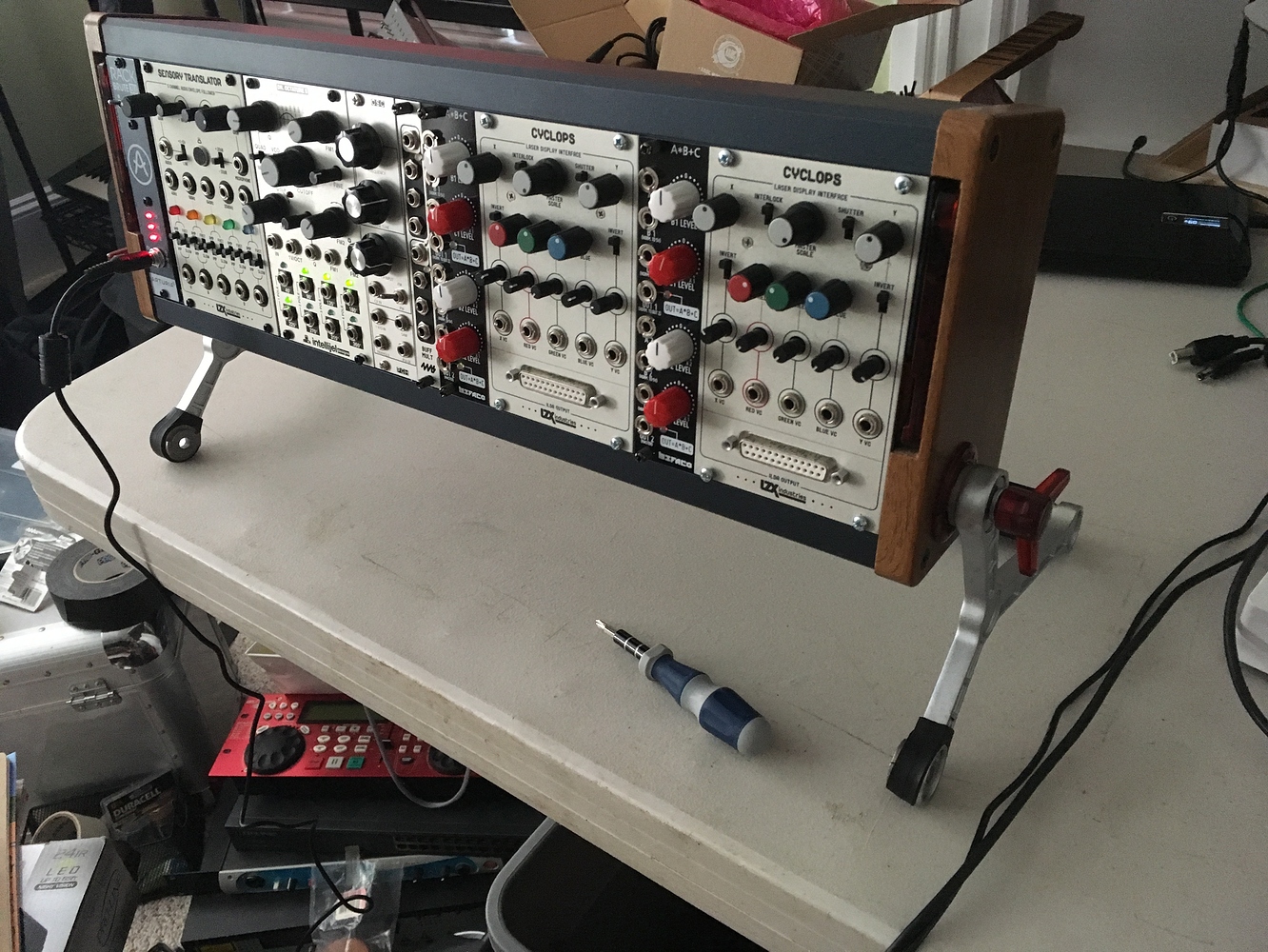

Cyclops settings I’m honestly clueless on… couldn’t find the manual online. On the back are set to 1v and protection on. Front I stole settings from the rack setup photo@Dewb uploaded (Cyclops on the right w/ switches up, scale maxed, colors off from center X VC slightly left, Y VC slightly right).

I wouldn’t take too much advice from the positions in that photo because I have A*B+C scalers in front of X and Y and I was probably doing something at the extreme edge of the projector’s range.
