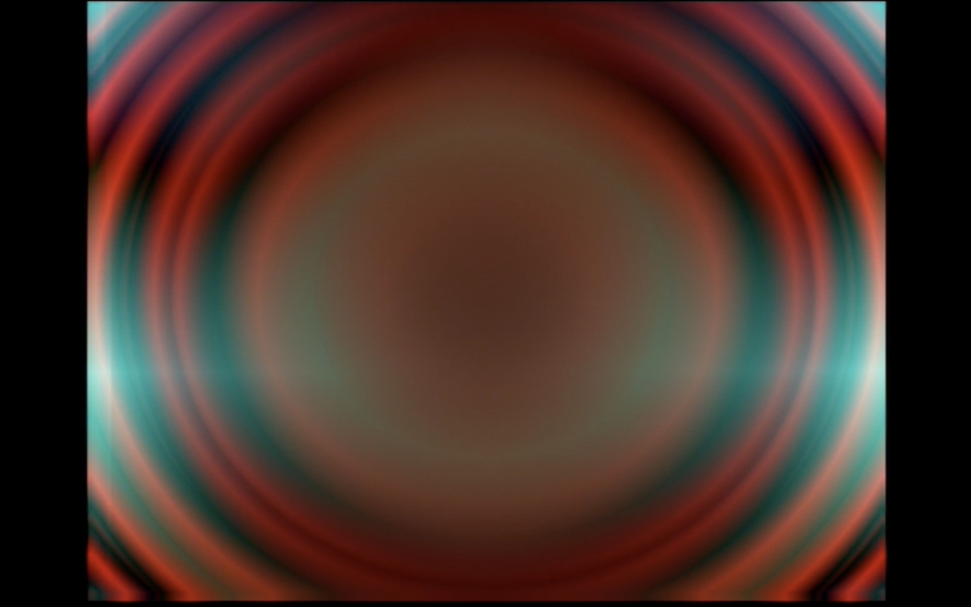

Now I noticed a visual issue. Its not the Vidiot, because I see it with it connected and not, it does it with the Visual Cortex. It is a line on the left side of the screen and the bottom of the screen that is alway there. Does anyone know what could cause it? I wanted to try to have a consistent symmetry with the imagery and this trows it off for me. It smudges the pattern a bit. You can see it in this screen shot.

That is odd. Is it there no matter if you are just using the Cortex on its own, patched internally?
#9 — creatorlars · 2019-07-12
Do you see the same issue on multiple displays/recording devices?
#10 — efp3 · 2019-07-13
I broke it all down and patched it back up with just the VC and don’t see the lines. I will run it back again through the Vidiot and see. Might have bee my Blackmagic too. That thing is a bit quirky.
