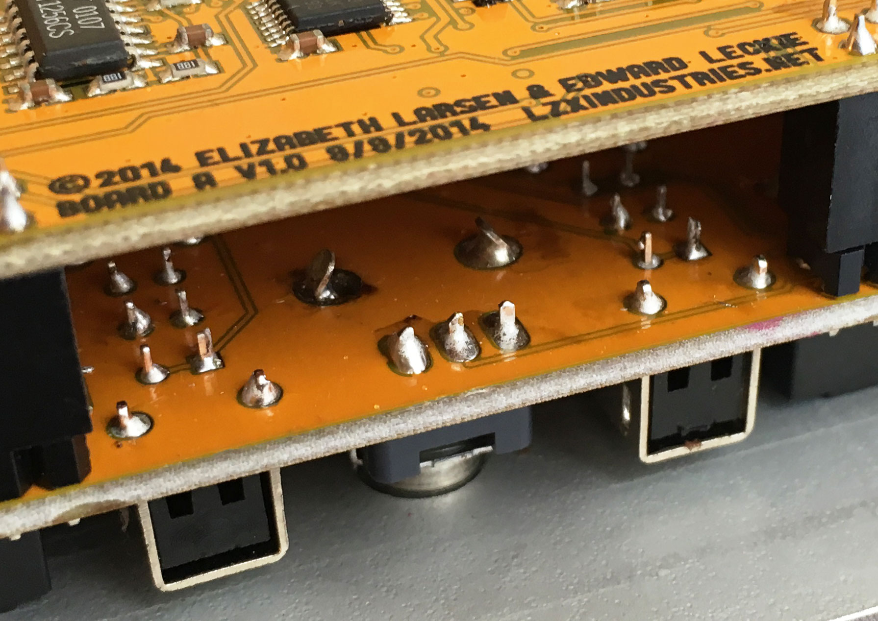

Cortex
Ah, yes, now that I look more closely at it, definitely appears to have a bad solder joint.
Looks like maybe a reasonably easy fix…? (I am by no means an expert solderer, but have built several of the Cadets and Castle successfully, so one joint should be doable.) Will obviously have to remove the rear board to get to it, but can I get away with leaving the front panel on? Or is that a bad idea?

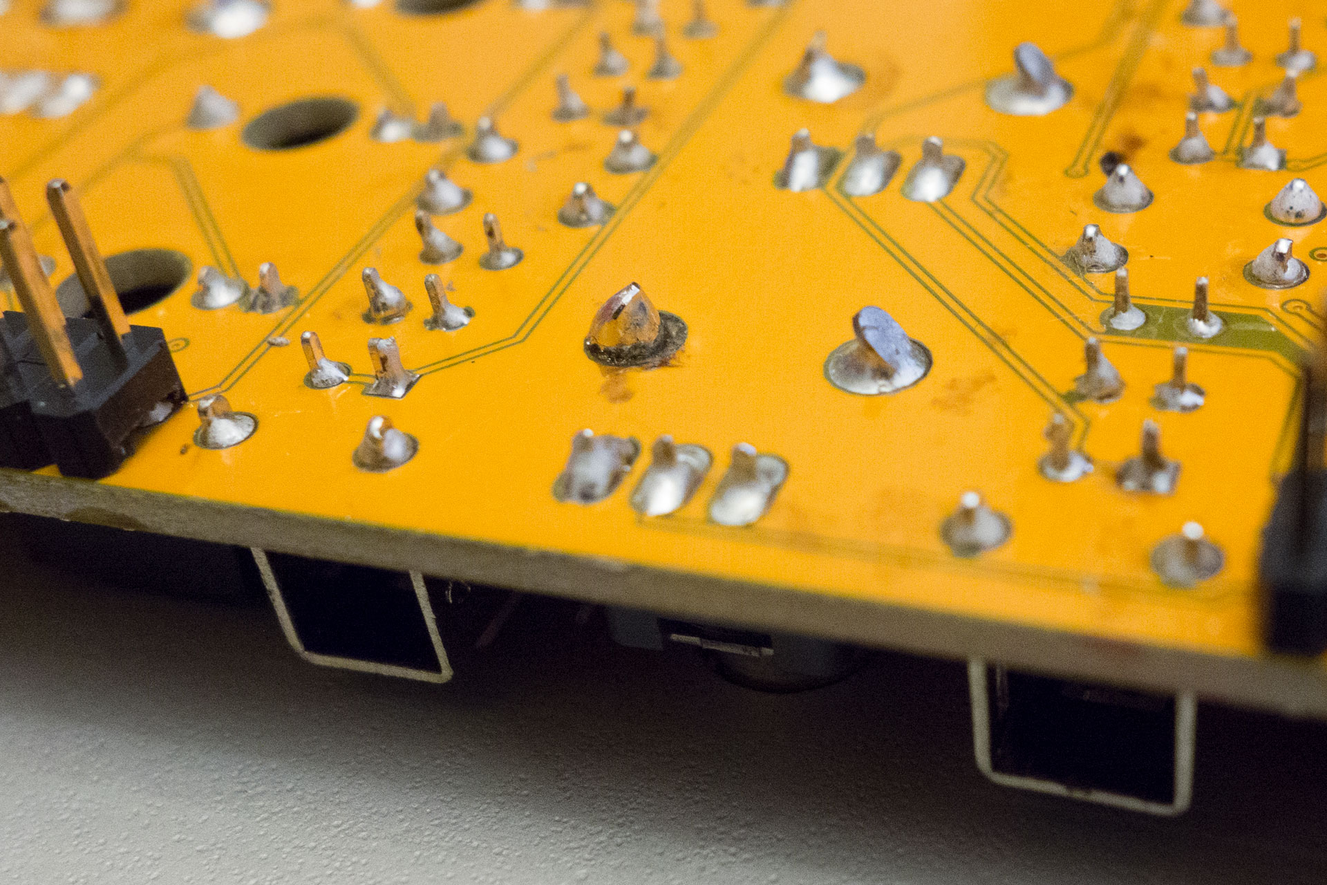

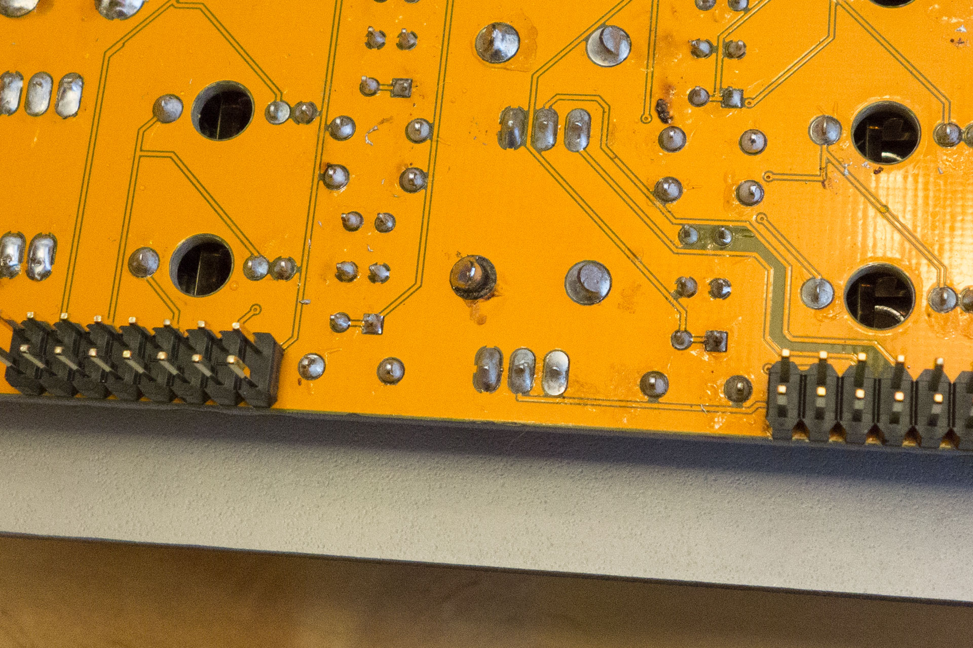

Well, gave it shot today but seems like maybe the board itself is not in the best shape. Couldn’t get a clean solder connection between the board and the pot leg. Didn’t seem to be much of a solder pad left. All the solder just beaded up on the leg.
Thoughts? Suggestions?

#12 — reverselandfill · 2020-03-27
you don’t have to solder that pin. it holds the pot.
It can help prevent things though.
I thought one of the (that row of 3) pins - of that potmeter, looked weird (the right one?).
If it does not wants to flow, it might be a lead free pcb. you can try lead free tin.
The pins have some solder, so reflowing might help as well.
maybe @Z0NK0UT can confirm this?
#13 — sean · 2020-03-27
Ah, I did wonder about that, as I was under the impression that those two larger pins were mechanical rather than electrical connections. Was just the obviously messed up–looking thing, so I assumed I was wrong.
…Let me take a closer look at the other pins.
#14 — Z0NK0UT · 2020-03-27
Yes, those pins are mechanical connections. If the mechanical connection is not secure, you could be flexing the electrical connections when you push on the pot.
Tech Phil says,
“I can’t tell for sure If that board is missing a pad or not. All I can say is that non-leaded solder does not like being reworked too much. I’d recommend a good deal of flux to help file an the joint and facilitate a solid connection, and maybe even hitting it with a little lead solder if it is an option.”

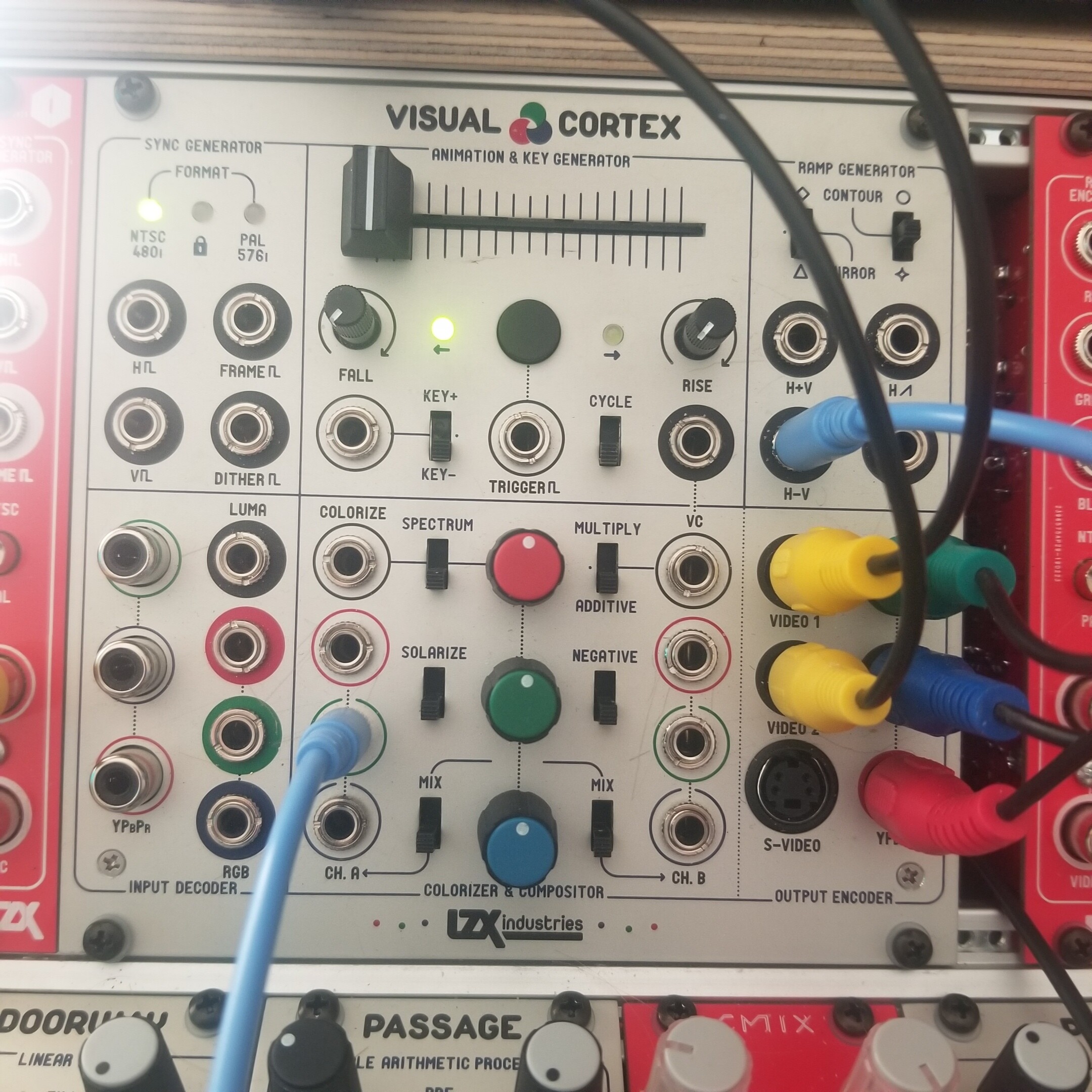

Hi!
My visual cortex just started giving me modulated noise on Green & Blue inputs.
Here is a pic of a VC ramp patched into Green. Same problem occurs when into Blue, but the same patch into Red is not throbbing with modulations,
Appreciate any help here. My VC sends sync to sync THRU on Diver. I’ve never seen this problem before today. Wondering if something has fritzed out inside VC, because nothing else has changed in my rig.
Thanks-
jim
20210227_090119
sample video for LZX Forum- Troubleshooting Visual Cortex modulated noise here:
#19 — jimfetterley · 2021-02-27
Thanks- Diver is out of the equation and I’m still getting the throbbing.
#21 — jimfetterley · 2021-02-27
Ok, thanks again for your patience. Switches returned to default (middle) position and it’s still happening.
When I patch the ramp into RED, and flip MIX, adjusting the Green and Blue knobs add the throbbing to the RED input, which was perfectly still and B & W as normal, without MIX ON.
I am slow with all of this and have taken some time to read the forum posts to learn as much as I can to grasp the most basic concepts, but maybe I am just missing something. Love this community and the modules just wondering if I have never noticed this before. Are Ramps patched into Green and Blue supposed to behave like this, and I have never noticed? Could be since I am the kind of learner that just starts plugging things together to get results without really fully grasping the theory/ math behind it. I just don’t ever recall this much throbbing and noise in these Green and Blue inputs. Could I have done anything or incorrectly patched to have caused this? Was proceeding as if there wasn’t anything I could damage patching any OUTS to any INS. Again, really appreciate any thoughts!

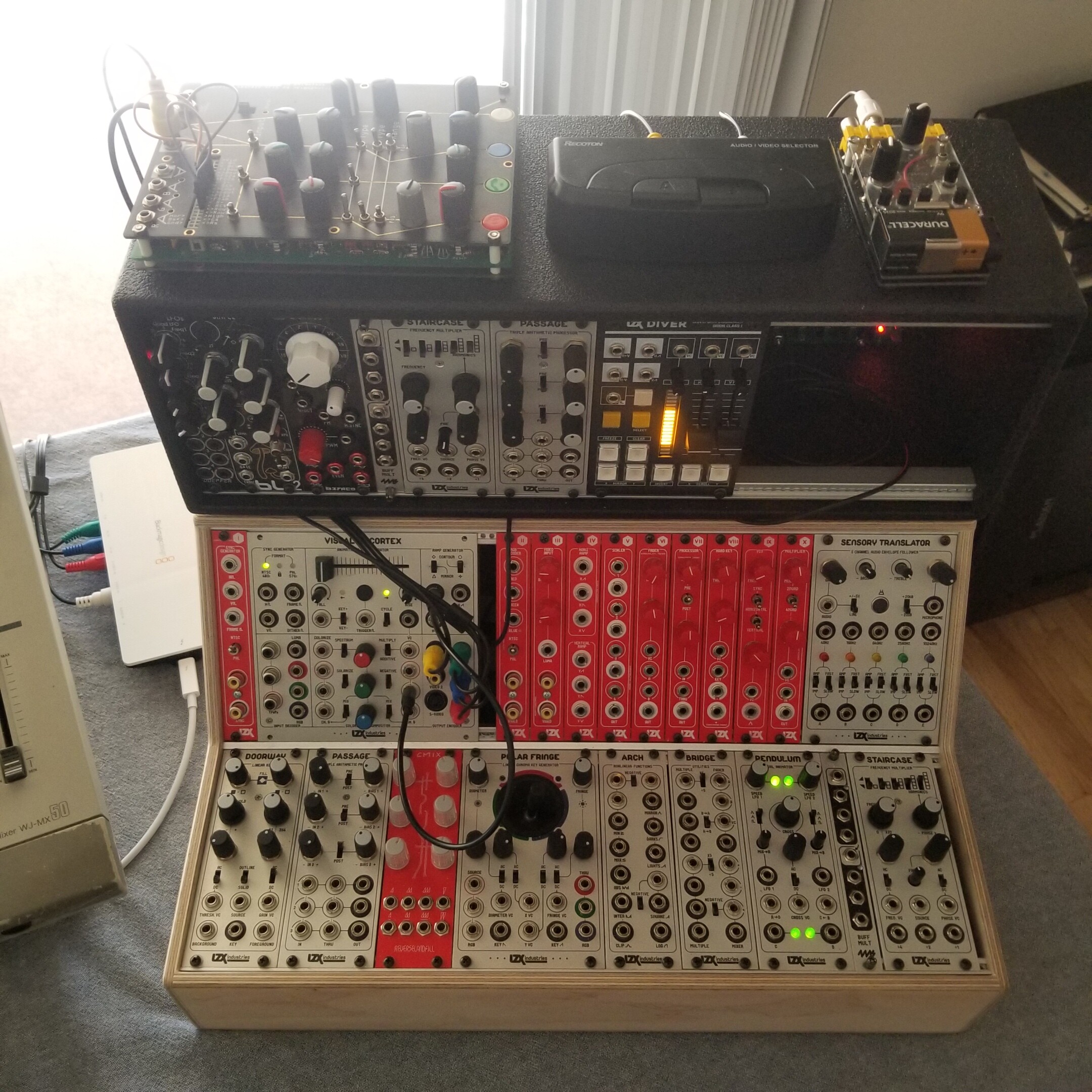

#22 — Z0NK0UT · 2021-03-01
Could you post a photo of your whole system? What power supply are you using? Could you try unplugging everything but Cortex from your power bus to see if the module misbehaves on its own?
#23 — jimfetterley · 2021-03-01
The VC is powered in a Doepfer A-100LCB (wood case in pic)
The Diver is powered in a Doepfer A-100LC3 (black case in pic)
I have placed the VC and powered it in Doepfer A-100LC3 (same as the Diver) unplugged sync out to Diver and the throbbing noise still appeared.
I then unplugged all modules except VC in the Doepfer A-100LC3 and I’m still getting the throbbing noise.
I have found clean recordings prior to last week of Ramps patched into VC’s Green & Blue inputs and they look clean didn’t have this problem. Here is a pic of full rig.
March_2021_rig
#24 — jimfetterley · 2021-03-01
