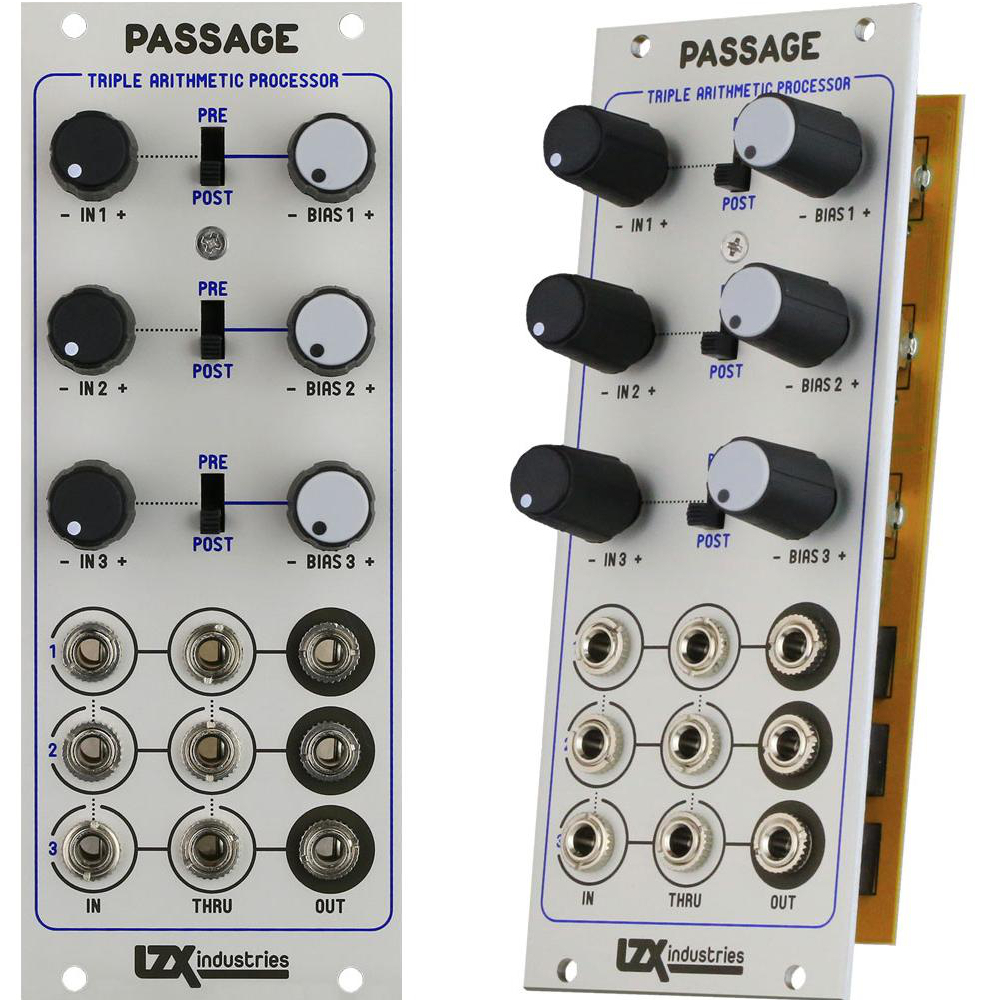

Passage is a triple channel wideband signal mixer and voltage processor. The signal path is suitable for mixing any type of signal, including video, audio and low frequency sources.
Each channel of Passage applies a fixed bias and gain to the IN signal, where the bias can be added before (PRE) or after (POST) the gain, then sums this processed signal with the THRU input.
