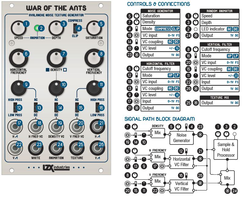

In many European countries television static noise, or “snow”, is described using the visual metaphor of a war between swarms of black and white insects. War Of The Ants is our first dedicated noise and texture generation instrument for video synthesis. At its core is a wideband full spectrum noise generator based on amplification of the avalanche noise characteristic found within certain diodes. With the ability to modify and filter the separate spectral characteristics of horizontal, vertical, and low frequency noise, War Of The Ants is capable of generating textures that range from blinking starfields to buzzing grayscale grain to thrashing clipped snow.
Specifications
- Width, 16HP
- Mounting Depth, 32mm
- Power +12V @ 100mA
- Power -12V @ 100mA
User Reference
Videos
Patching Tips
- Make sure to connect to a sync source to activate the module’s Animation and Speed controls.
- Patch the horizontal and vertical components of your shape,
whatever their source, into the horizontal and vertical filter VC
inputs on War of the Ants. Patch the H and V mix, or a variation of
it, into the Density VC input. Adjust the VC level controls for the
desired look. - Use a mixer module such as Color Chords, Passage, or Bridge,
to combine the Texture output with the H and V mixed shape.

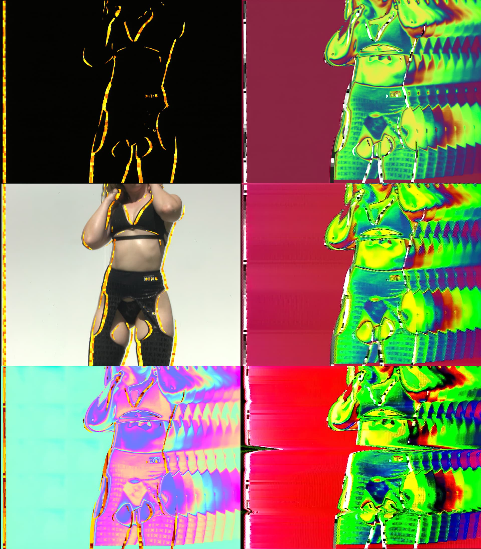

Well as a thought experiment, let’s try to imagine a purely Expedition series small system.
Diaspora of the Ants System
- Visual Cortex, main system IO and RGB compositor.
- Curtain, luma high pass / outliner extractor.
- War of the Ants, static texture source.
- Bridge or Arch or Passage. Utility mixing, mainly of modulators.
- Pendulum and Prismatic Ray, modulation sources for War of the Ants and Curtain
- An external video source – this system is all about modifying the edges of something.
The Patch
- External video source RGB is patched straight to Visual Cortex A channel (the Background.) And the video source LUMA is patched directly to Curtain input.
- Curtain is either patched to the Key input or the Fade VC input or the Colorize input on Visual Cortex. Three different worlds to explore there. Patch it thru a free channel of a Passage to gain some extra fine tuning capabilities.
- War of the Ants is patched to Visual Cortex B channel (the Foreground.)
- After setting up the basic patch, dial in the edge settings until you see the WotA texture appearing inside the edges of your source footage. Play with Visual Cortex RGB controls and blending mode settings until you like it.
- Now start focusing on the texture synthesis – modulate War of the Ants with Prismatic Ray and Pendulum, or use utility mixing to combine all the outputs in interesting ways.
