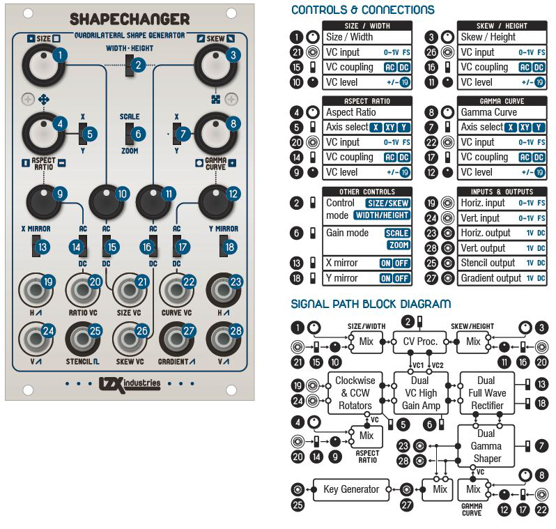

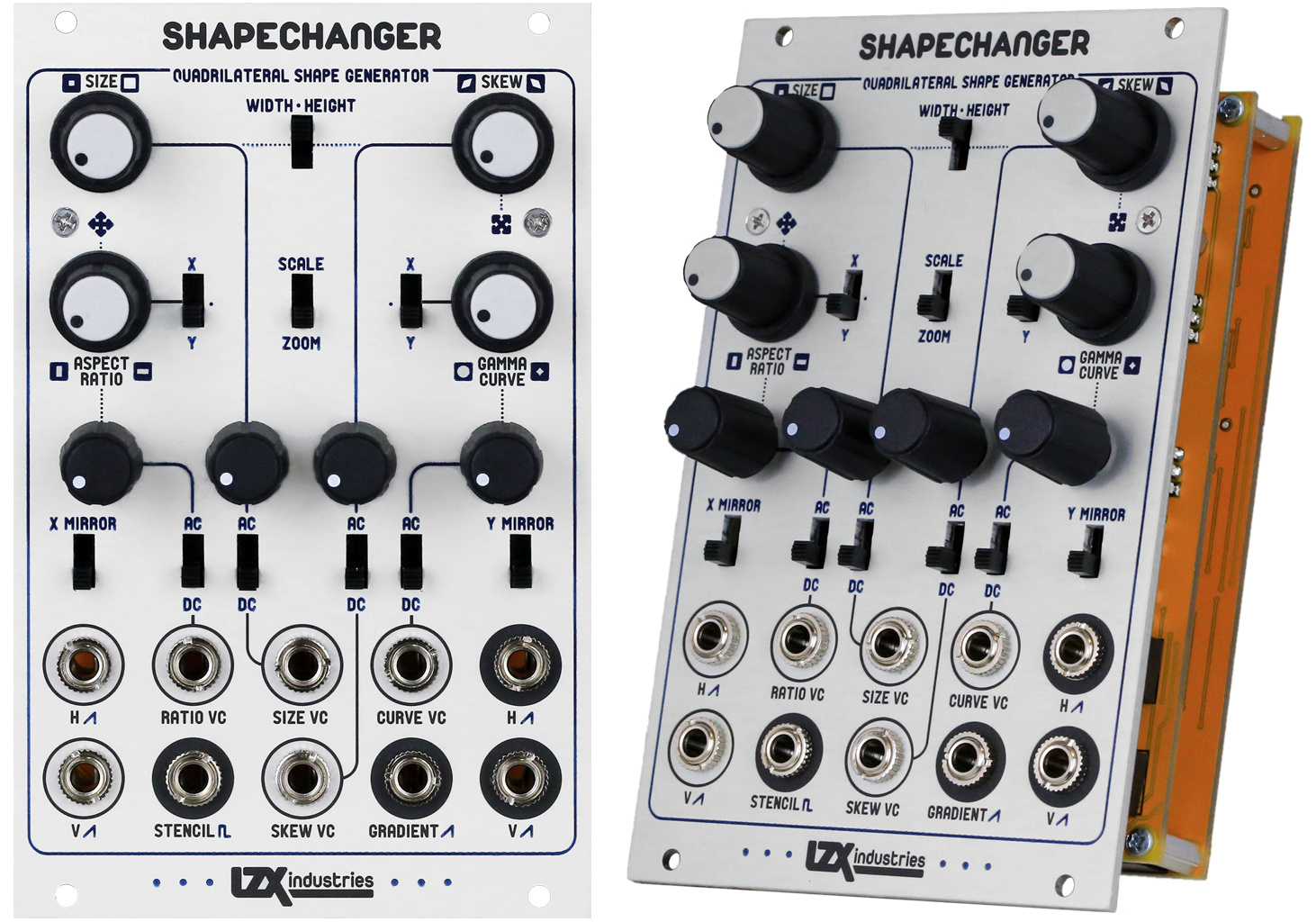

Shapechanger is our most ambitious analog computing module to date. Designed to take two continuous input voltages representing X and Y points on a display, Shapechanger processes the size, width, height, aspect ratio, symmetry, and curve of a resulting quadrilateral figure.
Specifications
- Width, 16HP
- Mounting Depth, 45mm
- Power +12V @ 220mA
- Power -12V @ 220mA
User Reference
