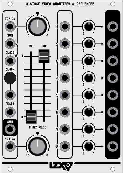

8 Stage Video Quantizer and Sequencer
primary functions: amplitude classification, sequential multiplexing8 stage video quantizer & sequencer is a complex key generation and high speed switching module. it consists of eight high speed analogue switches, only one of which is active at any time. each switch has an independent input and output, along with a bias control which is summed with the input. there is also a global sum input which feeds a signal to the inputs of all eight switches, and a global sum output which shows the output of the currently selected switch.
the quantizer takes whatever signal is input to the classify input and splits it into eight amplitude bands distributed evenly between upper and lower threshold points. the upper and lower threshold voltages also have control voltage inputs and attenuverting controls for modulation. the output of the quantizer is a number between 0 and 7.
the sequential clock also has eight steps from 0 to 7 and functions separately from the quantizer. when a clock pulse is received, the sequential clock counts upward by one. when a reset pulse is received, the clock resets to a value of 0.
the values of the quantizer and sequencer are summed together and wrapped around, the value of this sum determines which of the eight video switches is currently active. for example, if both the quantizer and sequencer have a current value of 0, then the selected switch is also 0 (0+0=0), which is the first switch. if the value of the quantizer is 2, and the value of the sequencer is 7, then the sum wraps around and the currently selected switch is the second switch (7+2=9, 9-8=1.)

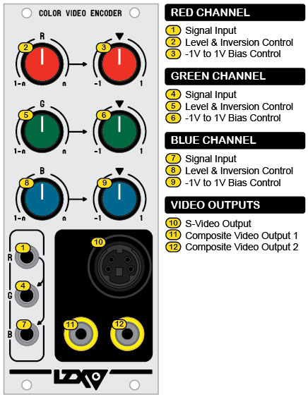

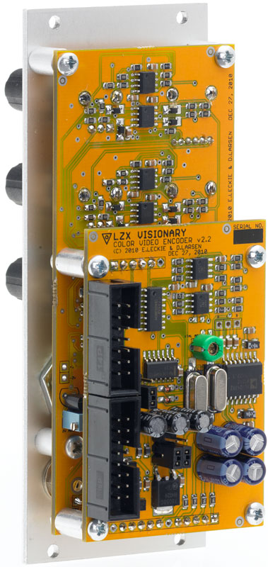

Color Video Encoder
unlike audio, a video signal requires special information to be encoded into it in order to be displayed or recorded. synchronization signals tell the target device when to display a new frame or a new line. in addition, it’s important that the signals which create the chroma (color) and luminance (brightness) information are within the valid ranges allowed according to video standards.
the color video encoder (cve) module is one of two required modules in the lzx visionary system. the cve performs the function of taking signals from three separate color input channels: red, green & blue, conditioning and encoding them so that you always see valid yuv output video in composite and s-video formats. any input signal between 0 and 1 volts becomes viewable video, while the rest is safely clipped off.
color channel inputs:
for each color channel, a bias control allows you to adjust the relative amount of this color that is added or subtracted from the input signal, and for each input an attenuverter allows you to adjust the level and inversion of the input signal. while inverting the signal by turning the attenuverter knob counter-clockwise from its center position, a positive 1v bias is also added to the signal. the inverted input signal is subtracted from 1v, which ensures the input signal is still within the 0-1v viewable range.
input normalization:
to simplify patching workflow, the green & blue channel inputs are automatically connected to the red input. this connection to red is broken when a plug is inserted into the green & blue jacks. this switched structure allows you to send a single input signal into the red input instead of using extra cables and a multiple to send the same signal to all three.
video sync generator connection: the cve requires master synchronization signals from the video sync generator module, which are passed by a special 14-pin sync cable. care must be taken that this connection is made correctly, or else the module will not function. further information can be found on the module installation page.
video outputs:
the cve can easily be configured to produce valid video output for both pal and ntsc formats by repositioning a jumper on the circuit board. you can install as many cve modules in your lzx visionary system as you like all of which can derive synchronization signals from a single video sync generator module. the cve has three video outputs, two composite and one s-video. the multiple signals are useful for situations in which you want to send one signal to a preview monitor and another to a projector or recording device.
specifications:
- width: 10hp
- maximum current draw: 100ma
- MSRP $379

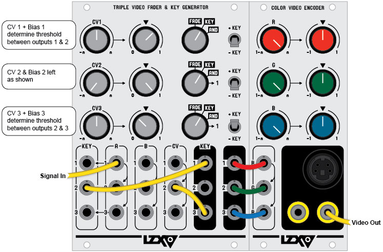

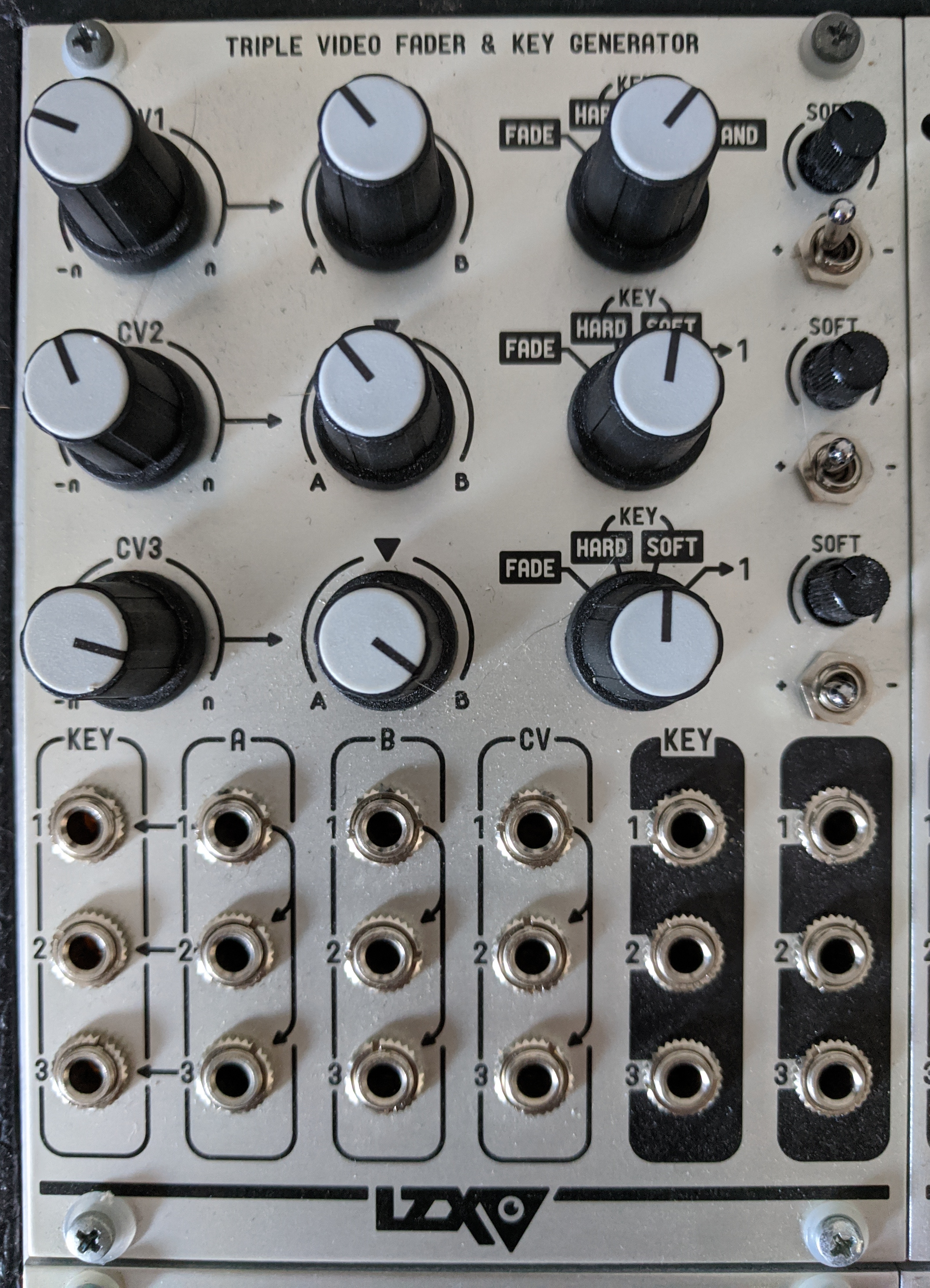

Triple Video Fader & Key Generator
the triple video fader & key generator (tvf) is a versatile signal processing module which includes three separate voltage-controlled crossfaders and three separate voltage comparators (key generators). cascaded input columns and selectable crossfader control source modes allow complex operation for a variety of purposes such as crossfading, multiplication, luma keying, chroma keying, window comparison, simple comparison and amplitude classification.
control voltage inputs and bias controls:
control voltage (cv) inputs have corresponding level/inversion controls, allowing both addition or subtraction of the input signal from the additional 1v bias controls. once the cv input and bias level are summed, they control the key generator’s comparator threshold. depending on the crossfader control source mode, they may also directly control the corresponding crossfader.
faders:
signal inputs to a and b channels of the voltage-controlled crossfaders are accessible via the frontpanel. mode switches allow selection of the control voltage source for the crossfaders. the fade mode enables the summed cv & bias voltages to control the crossfader directly. the key mode enables the the corresponding key generator output to control the crossfader directly. the and mode enables a logical and generated from all three key generators to control the crossfader directly. in addition, crossfaders 2 & 3 can select crossfader 1’s control source for use as a master control. crossfader outputs are accessible on the right side of the frontpanel.
Voltage-controlled crossfader with two inputs and one output. When control source is at 0 Volt, channel A is completely on. When control source is at 1 Volt, channel B is completely on. Voltage levels between 0 Volt and 1 Volt represent a proportional mix of channels A & B. With signal inserted to channel B only, the fader behaves as a traditional voltage-controlled amplifier.
KEY GENERATOR
High speed voltage comparator serving as a key generation source. When the key generator input is greater than the voltage represented by the sum of the CV input and bias controls, the key output is 1 Volt (on). Otherwise, the output is 0 Volt (off). Inversion switches select between non-inverted and inverted versions of this logic signal.
CONTROL SOURCE
Control voltage (CV) inputs are processed by level and inversion controls and then summed with a variable 0 to 1 Volt bias. This sum serves as the threshold level for the key Generator, and as the control source for the fader while in FADE mode.
PATCHING TECHNIQUES:
Single Threshold Comparator
Insert a signal into any key input. Associated 0 to 1 Volt bias control determines the voltage threshold for the key signal appearing at the associated key output. Key inversion toggle switch can select positive or negative logic. In positive mode, key output will be 1 Volt when the Key signal is higher than the threshold level. In negative mode, key output will be 1 Volt when the Key signal is lower than the threshold level. Another signal can be inserted to the associated Control Voltage (CV) input, and the associated level and inversion control adjusts the amount the external signal adds to the keying threshold.
Multiplier/VCA (voltage controlled amplifier)
Insert any signal into B input of a fader channel. Switch associated fader control source switch to FADE. Amplitude of the input signal is then controlled by the sum of the 0 to 1 Volt bias control and any signal input to the CV input. This can be used to multiply two video signals together, or as an automated fader.
Automated Crossfading
Insert any two signals into A & B inputs of a fader channel. Switch associated fader control source switch to FADE. Associated 0 to 1 Volt bias control determines the proportional mix between A & B inputs appearing at the fader output. When bias control is at 0 Volts, channel A will be 100% amplitude, with channel B at 0%. When bias control is at 1 Volt, the opposite is true. Another input signal can be inserted to the associated Control Voltage (CV) input, and the associated level and inversion control adjusts the amount this signal adds to the bias. In this way, a low frequency modulation signal can be used to smoothly fade between the two signals.
Luma Keying
Patch up the single threshold comparator patch as described above, but take the output from fader output instead of key output. Insert the input signal to A channel input (which will be automatically be connected to the associated Key input.) Switch the associated fader control source mode switch to KEY. Now the input signal will be keyed in and out based on its own brightness level. A second signal can be inserted to “B” channel to switch between two sources.
RGB Fader
This patch uses all three channels to fade between two RGB signals. Configure the automated crossfading patch as described above, sending red, green & blue signals to A & B inputs of all three channels. Switch channels 2 & 3 to ->1 mode in order to select channel 1 as the master control source. Chanel 1?s CV & Bias controls will now identically control crossfading between all faders.
Window Comparator
This patch uses two channels together in order to generate a single key or switched signal with an upper and lower threshold. First, patch up the luma keying patch as described above, and patch the fader output of this patch to the key input of a second channel’s key input. Switch key inversion toggles on either channel to opposite positions and adjust key thresholds appropriately. Bias controls and CV inputs can modulate upper and lower thresholds separately. Additional note: If desired, the patch can be expanded to control “width” and “position” instead of upper and lower thresholds by using a third channel as a VCA to control the gain of the incoming modulation signal, which can then be applied equally to the two upper and lower thresholds.
Chroma Keying
Set up RGB fading patch as described above, but switch channel 1 to AND mode. Boas controls, key inversions and CV inputs on all three channels now determine the amount each color of channel A contributes to the Chroma key switching logic. With time spent finding the desired settings, any specific range of color can be targeted as the key source in variable degrees.
3-Band Amplitude Classifier
An amplitude classifier splits an input signal into different amplitude ranges and is useful for colorizer patches where you want control over the shared points between multiple bands rather than independently variable comparators. This patch uses all three channels. Switch all channels to Key mode. Switch channels 1 & 2 to -Key, and channel 3 to +Key. Insert signal source to A1 jack. Patch Key1 Out to Key2 In. Patch Key3 Out to CV2 In. Turn CV2 control fully counter-clockwise. Turn channel 2 bias control fully clockwise. Ensure that Bias1 is higher than Bias3. Now fader outs and key outs represent three split amplitude bands, with channels 1 & 2 controls and CV inputs representing the threshold points between bands 1 & 2, and bands 2 & 3.Cascaded Crossfaders
Since each of the there CV crossfaders can function independently, they can be used to create several types of voltage-controlled signal mixes. One method is to take the outputs of crossfaders 1 & 2 and send them to the A & B inputs of crossfader 3. Up to four signals can be input to crossfaders 1 & 2 inputs, and crossfader 3 is used to crossfade between the outputs of the first two.
Max/Min Selector
This patch compares two input signals, and outputs whichever one is highest (max) or lowest (min) at that point in time. It can be replicated on all 3 channels to work on two triple colorspace (RGB) signals, or cascaded to multiple channels to add additional signals to the max/min selection. Input signal #1 to A input (which gets automatically connected to corresponding Key input). Input signal #2 to B input, and use a mult or stacking cable to send this same signal to corresponding CV input. Set CV control fully CW. Set bias control fully CCW. Set channel mode to “Key”. Positive logic selects “Min” response, negative logic selects “Max” response. Fader output jack represents the Max/Min selection.
Voltage Controlled Panner
A panner allows variable gain of 1 input signal to 2 separate outputs (as opposed to a crossfader, which allows variable gain of 2 input signals to 1 output.) This patch uses two channels of the TVF&KG. Input signal to B1 input (it will consequently be connected via switched jack to B2 input). Input CV source to CV1 input (which will consequently be connected via switched jack ot CV2 input.) Turn CV1 fully CW. Turn Bias 1 fully CCW. Turn CV2 fully CCW. Turn Bias 2 fully CW. Input signal will be panned between fader outputs #1 and #2 based on the external control voltage source.

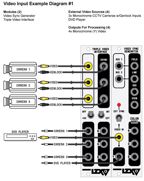

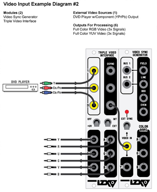

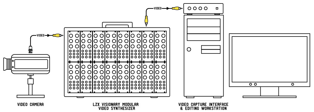

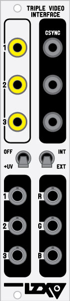

Triple Video Interface
triple video interface is a wideband analogue input module for external video sources and serves multiple use cases. input sources are dc restored, sync clipped, and scaled to proper voltage levels before output for processing and patching throughout an lzx visionary video synthesis system. in addition, three composite sync outputs can be used to feed genlock inputs on external devices for synchronizing purposes. also included is a yuv to rgb colorspace converter - with this feature, an external component (yprpb source) can be translated to the rgb colorspace internally.
please be aware that this module does not include time base correction, frame synchronization, or composite color decoding features. if those features are required, you will need the color time base corrector module.
please note: this module requires connection to the video sync generator by means of a video sync distribution chain cable which must be purchased separately.
external video input example diagrams
Specifications
- width: 6hp
- mounting depth: 1.75 inches
- lzx sync cable required? yes
- MSRP $279

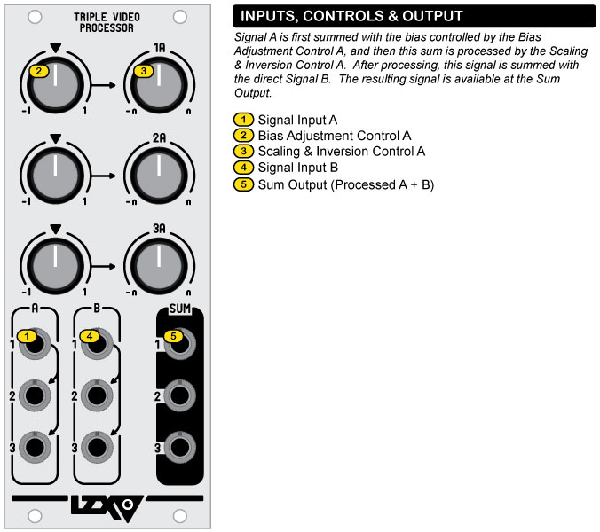

Triple Video Processor
the triple video processor is a wide bandwith signal processor suitable for adjusting the gain and bias of three simultaneously processed signals, while also allowing secondary signals to be summed into the final output mix. triple video processor was designed specifically to address common use case scenarios within the video synthesis system. since the bias is applied to the input signal before its scaling & inversion control, the cross-over point at which the signal is inverted can be adjusted, enabling bi-polar voltage mixing when the signal is summed with the b input channel.
Specifications:
- width: 10hp (2 inches)
- mounting depth: 1.25 inches
- bandwidth: 40mh
- MSRP $199

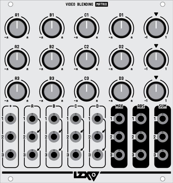

Video Blending Matrix
the video blending matrix is a versatile signal processing module used for mixing input signals in various mathematical input and output modes. cascaded input columns allow each of the vbm’s three 5-channel dc mixers to operate either independently or combined in various input matrix configurations.
signal inputs:
each mixer has five dc-coupled signal inputs which can be used for any type of signal, from low frequency modulation to full bandwidth video. four have associated level/inversion controls and inversion mode switches, the remaining one is a direct summing input for chained operation between multiple vbm modules. with the combination of the level/inversion control and inversion mode switches, three different variable input functions are possible: addition, subtraction, and inverted addition. with no signal input, each control can function as a variable 1v bias control.
mix outputs:
two separate mix output functions are available for each mixer: sum and absolute. the sum output is the sum of all input signals. the absolute output is the absolute value of the sum (negative signals are inverted and become positive.) the absolute outputs enable techniques such as frequency multiplication and the creation of solarization and color difference effects.
matrix operation:
matrix configuration is achieved through the normalization of input columns between the three independent signal mixers. with a single signal patched into the topmost input of mixer 1, this signal is applied to the corresponding input on mixers 2 & 3. within a patch utilizing triple colorspace (such as red, green, and blue channels), this feature allows a single signal to be mixed in varying amounts to each channel.
Specifications:
- width: 22hp
- maximum current draw: 220ma
- MSRP $599

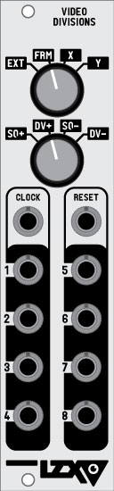

Video Divisions
video divisions is a high speed digital logic processing module with several complex modes for generating horizontal and vertical bars, and dividing other signals. it is capable of processing signals throughout the video bandwidth. each of the two inputs includes a high speed comparator which converts any input signal into key logic around a threshold of 0.5 volts. as with all modules in the lzx visionary line, the inputs can therefore receive any type of signal not just binary logic pulses.
video divisions includes four preset modes and four count modes.
ext mode
in ext mode, the eight outputs represent eight divisions of an input signal put into the clock input. the current count is reset via a pulse at the reset input. when in sq+ count mode, the outputs count one after the other in a ring, so that only 1 output is high at any time. this function is similar to a gate sequencer. in dv+ count mode, the outputs represent binary divisions /2, /4, /8, /16, /32, /64, /128, /256. while in ext mode, the sq- and dv- modes are identical to sq+ and dv+, except that the input clock is blanked so that clock pulses outside the viewable area of the screen are ignored. this is useful for correcting glitches in horizontal patterns.
frm mode
in frm mode, the eight outputs represent divisions of the system’s frame rate clock. the count is reset via a pulse at the reset input. when in sq+/sq- count modes, the outputs count one after the other in a ring, so that only 1 output is high at any time. this function is similar to a gate sequencer. in dv+/dv- count mode, the outputs represent binary divisions /2, /4, /8, /16, /32, /64, /128, /256.
x mode
in x mode, the eight outputs produce vertical bars. the clock and reset inputs control a secondary counter which offsets the primary counter, to achieve modulation. when in sq+/sq- count modes, the outputs count one after the other in a ring, so that only 1 output is high at any time. this function is similar to a gate sequencer. in dv+/dv- count mode, the outputs represent binary divisions /2, /4, /8, /16, /32, /64, /128, /256. in sq+/dv+ modes, the secondary counter shifts the vertical bars to the right. in sq-/dv- modes, the secondary counter shifts the vertical bars to the left.
y mode
y mode is identical to x mode, except horizontal instead of vertical bars are produced by the outputs.
Specifications:
- width: 6hp
- MSRP $269

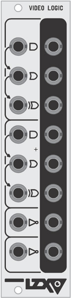

Video Logic
video logic is a high speed digital logic processing module with multiple boolean and inversion functions. it is capable of logical combinations of video rate signals throughout the video bandwidth. each of the eight inputs includes a high speed comparator which converts any input signal into key logic around a threshold of 0.5 volts. as with all modules in the lzx visionary line, the inputs can therefore receive any type of signal not just binary logic pulses.
there are two boolean functional blocks with 3 inputs and 3 outputs each. the outputs represent the logical and, or and xor combinations of the 3 inputs signals. additionally, there are two inverter functions. the output of these inverters represents the logical inversion of the input signal. through patching some signals to the inverters before the boolean functions, nand, nor and xnor logic functions are made possible.
Specifications:
- width: 6hp
- lzx sync cable required? no
- MSRP $219

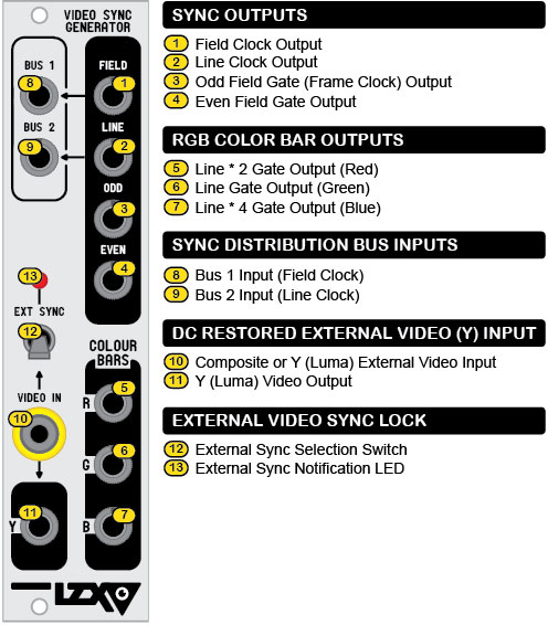

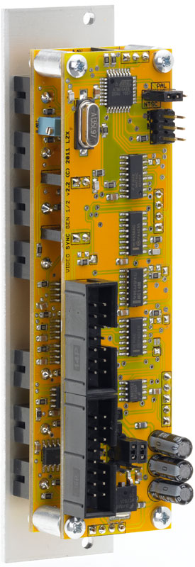

Video Sync Generator
Primary Functions Master NTSC/PAL video sync generator with external sync lock, sync bus access, RGB color bar generator, DC-restored external video input
Video Sync Generator is one of two required modules in the LZX Visionary system, and serves as a master timing and clock generator for modules throughout a system. It’s primary companion is the Color Video Encoder, together these two modules create the framework to synthesize and process Composite video in the modular environment. In addition to a video sync signal generation, other features include access to the sync distribution buses, the creation of color bar reference signals, an external video input for external sync-locking, and a DC restored output for the Luma (Y) component of the external video signal.
Sync Outputs
The four sync outputs on the front panel are 1V logic signals for Field rate, Line rate, Odd field rate, and Even field rate. These outputs can be used to sync Video Waveform Generator and other signal generator modules in order to create stable video patterns.
Color Bar Outputs
Color bar outputs are multiplications of the Line rate, and when patched directly to the Color Video Encoder can be used as a signal reference for calibration. They can also be used as logic signals to sync signal generators such as Video Waveform Generators. Unlike the other outputs, which are 1V signals, these are precisely adjusted to 0.75V to represent standard 75% saturation color bars.
Sync Distribution Bus Inputs
The Bus 1 & 2 input jacks allow patch access to two signal buses which allow distribution of sync signals to Video Waveform Generator modules and other modules that implement sync bus selection. By default, these buses are connected to the Field & Line outputs. By plugging into the Bus 1 & Bus 2 jacks, this connection is broken and a different signal can be inserted into the bus.
DC Restored External Video (Y) Input
Video Sync Generator’s synchronization timing can be slaved to the timing of an external video signal inserted at the Video Input RCA jack. This video signal is also DC restored, sync-stripped, Chroma notch filtered, and output via the Y output jack for processing throughout the system.
External Video Sync Lock
To lock Video Sync Generator to an external video input to the Video Input RCA jack, flip the toggle switch to a downward position. The LED will turn on solid if a valid video signal is detected, or flash if no video signal is detected. Since the sync lock feature implements a Phase Locked Loop to control the internal clock, the system defeats Macrovision protection, and in the case of a non-valid or undetected video signal, operation of Video Sync Generator is undisturbed.
Sync Output Timing
NTSC*PAL*Field59.94 Hz50 HzLine15.75 KHz15.625 KHzOdd/Even Frame29.97 Hz50 Hz

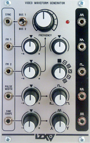

what your ear may hear as a subtle difference, your eye may see as a huge one. since the end results in video synthesis are visual: texture, pattern, and shape instead of audio, there are a number of features and controls in this vco design that take into consideration this unique application.
features:
wide range vco with 6 selectable frequency ranges from 30 seconds to 2mhz, coarse and fine tuning controls.
expanded hard sync circuit designed for accurate synchronization to video sync signals. selection switch allows normalization to sync bus signals distributed through the power header from the lzx visionary video sync generator module.
precision video op-amps used in all circuitry for accurate high speed frequency and waveshape modulation.
five simultaneous waveform outputs: triangle, sawtooth, square, pulse (rectangle) & shaped sine.
two independent waveshapers with cv inputs, cv attenuverters and bias controls: pulsewidth modulator & sine shaper. control pulsewidth and sine shape from 0% to 100%.
two frequency cv inputs with cv attenuverters. jumper-configurable options for input scaling (visionary or 1v/oct standard) and linear or exponential input.
attenuversion controls on all signal inputs allow attenuation and inversion of any input signal.
frequency notification led.
no external +5v power rail necessary, user configurable jumper allows selection between onboard +5v regulator or +5v rail on standard power header.

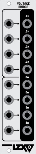

Voltage Bridge
voltage bridge is a simple, straightforward 8-channel voltage scaling module designed for conveniently interfacing with synthesizer modules and devices outside of or integrated into an lzx visionary system. four sets of inputs/outputs attenuate a signal by 20% (5 volt scale to 1 volt scale), and another four sets of inputs/outputs increase the gain of a signal by 500% (1 volt to 5 volt scale.) this module can be used for any type of signal: audio, control voltage, logic, video, etc. aside from its utility purposes, it can be used to achieve various effects as well.
Specifications:
- width: 6hp (1.2 inches)
- MSRP $99

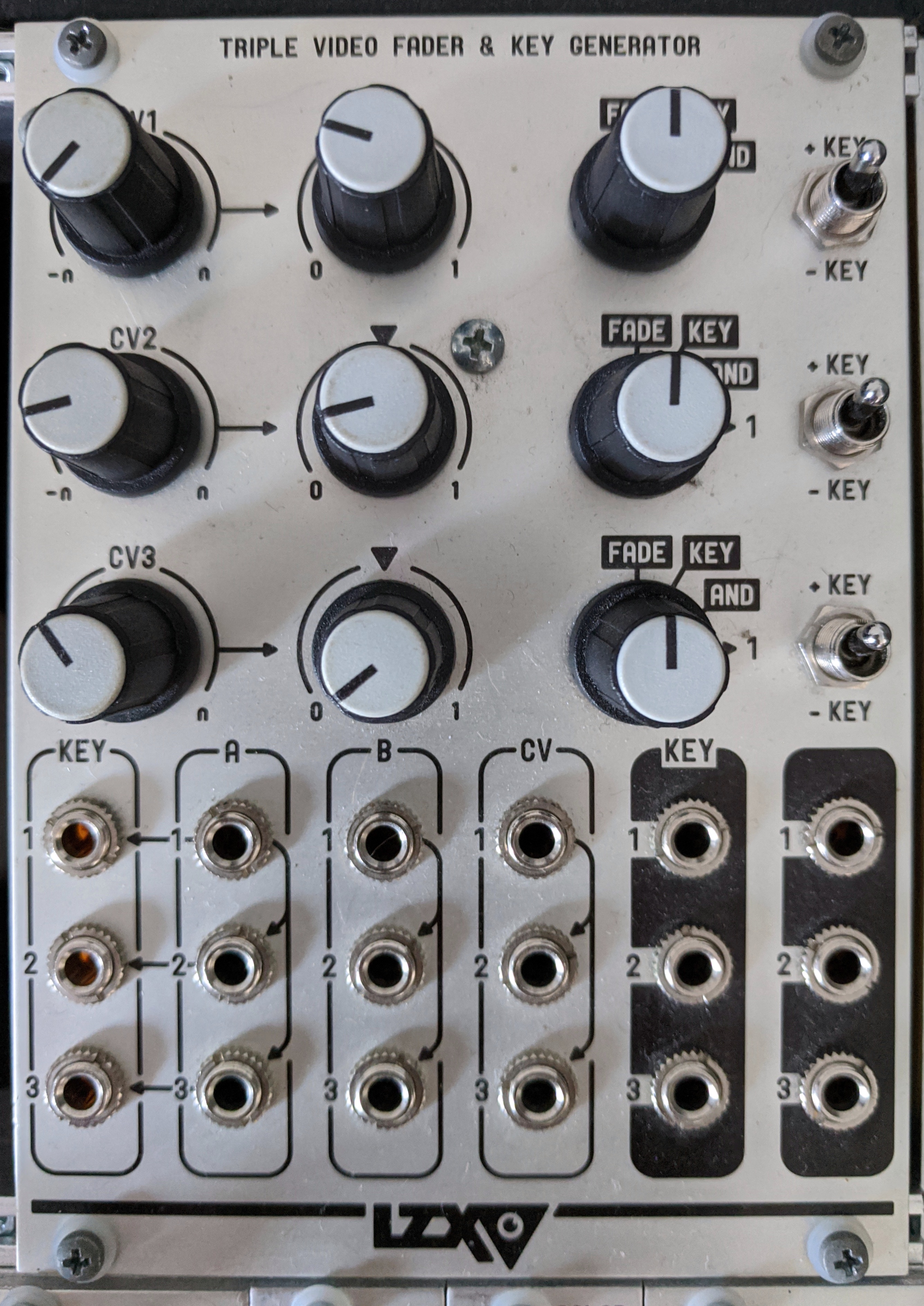

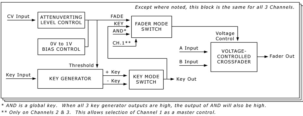

#6 — bentoncbainbridge · 2020-08-10
I have two versions of the Triple Video Fader & Key Generator. Are these v1 and v2? Or, is one of them a prototype?
#7 — Z0NK0UT · 2020-08-11
The version with the soft keyer is TVFK MK2. Only 50 units were manufactured.

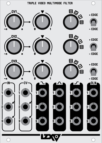

Z0NK0UT wrote:
Triple Video Multimode Filter
Details on TVMF from Muff’s thread
Lars – What is the OLN output on the filters?
That stands for outline. These outputs offer three rectified variants of the high-pass output, for edge extraction – selectable by the three-position toggle switch:
- EDGE (top position): half-wave rectifier, rising (left) edges only, falling edges are clipped
+/- EDGE (middle position): full wave rectifier, falling and rising edges are both positive signals
- EDGE (bottom position): half-wave rectifier and inverter, falling (right) edges only, rising edges are clipped
It’s worth adding to the above, that the high pass output is a bipolar signal, with rising edges becoming positive spikes and falling edges becoming negative spikes. If you add this signal to the original image, it will increase the brightness of the rising edges, and decrease the brightness of the falling edges. Adding any of the “OLN” outputs to the original image will only increase the brightness of the edge selected.
Triple Video Processor makes a great companion to TVMF for edge enhancement/manipulation. For example, sending the original image to the TVMF input and TVP B-channel input, and then the TVMF output (of your choice) to the TVP A-channel input, you can now add, subtract or otherwise manipulate the left and right edges of the source image.
