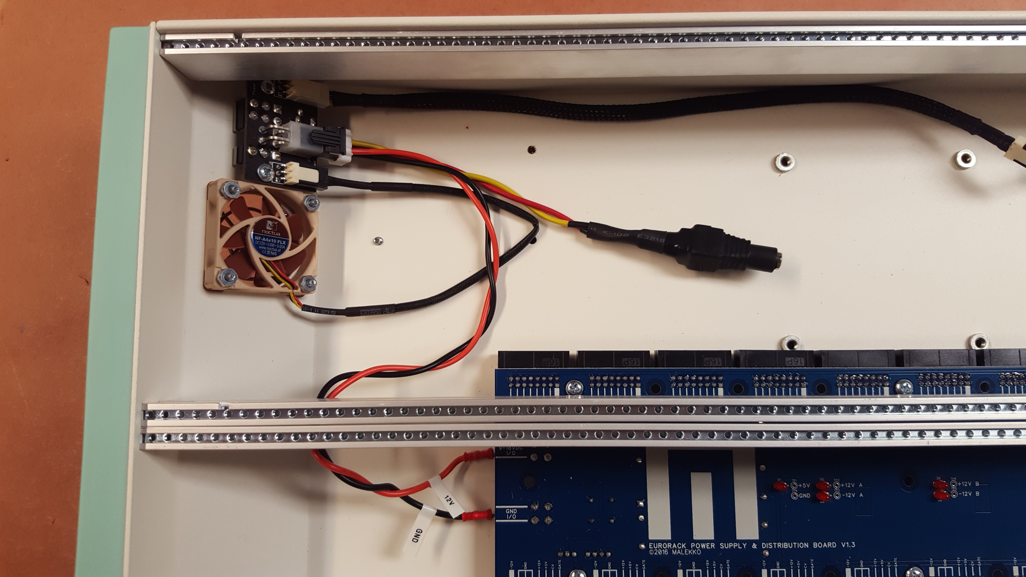

If you ordered a Vessel in 2019 we will be sending you a DC barrel adapter to replace the existing wire harness in your unit. To install the adapter, remove the existing wire harness and install the adapter as illustrated in the photograph below.
20190726_105953
This adapter will allow you to chain +12V input power to your Memory Palace, Structure, TBC2 or Liquid TV straight from the power brick. If you don’t need to power these modules, you don’t need to install the adapter.
