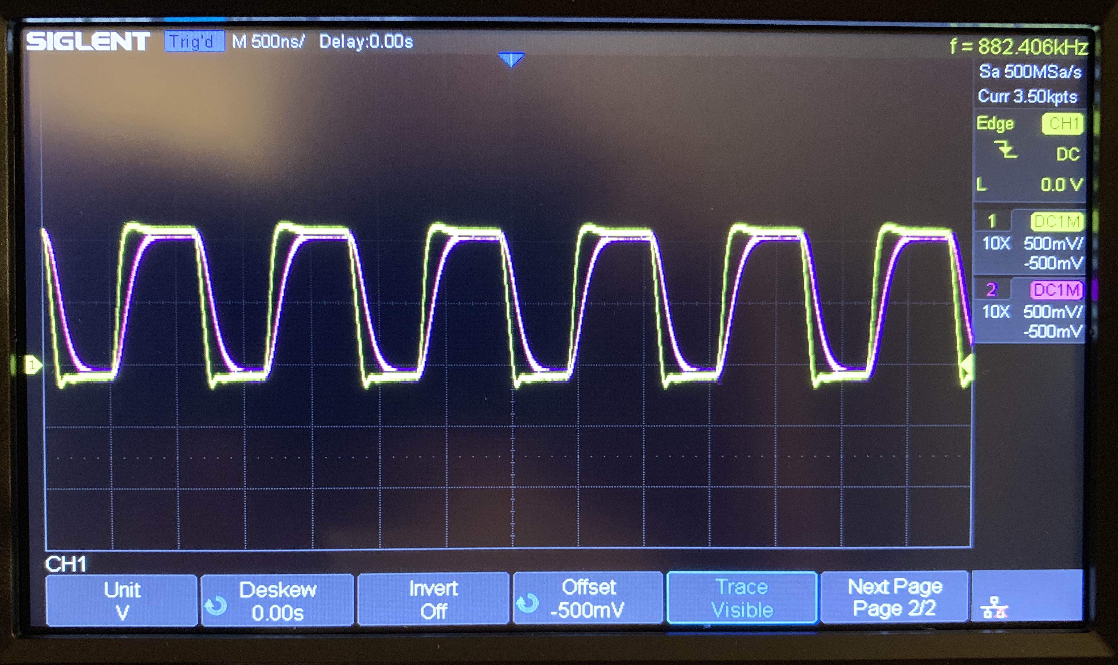

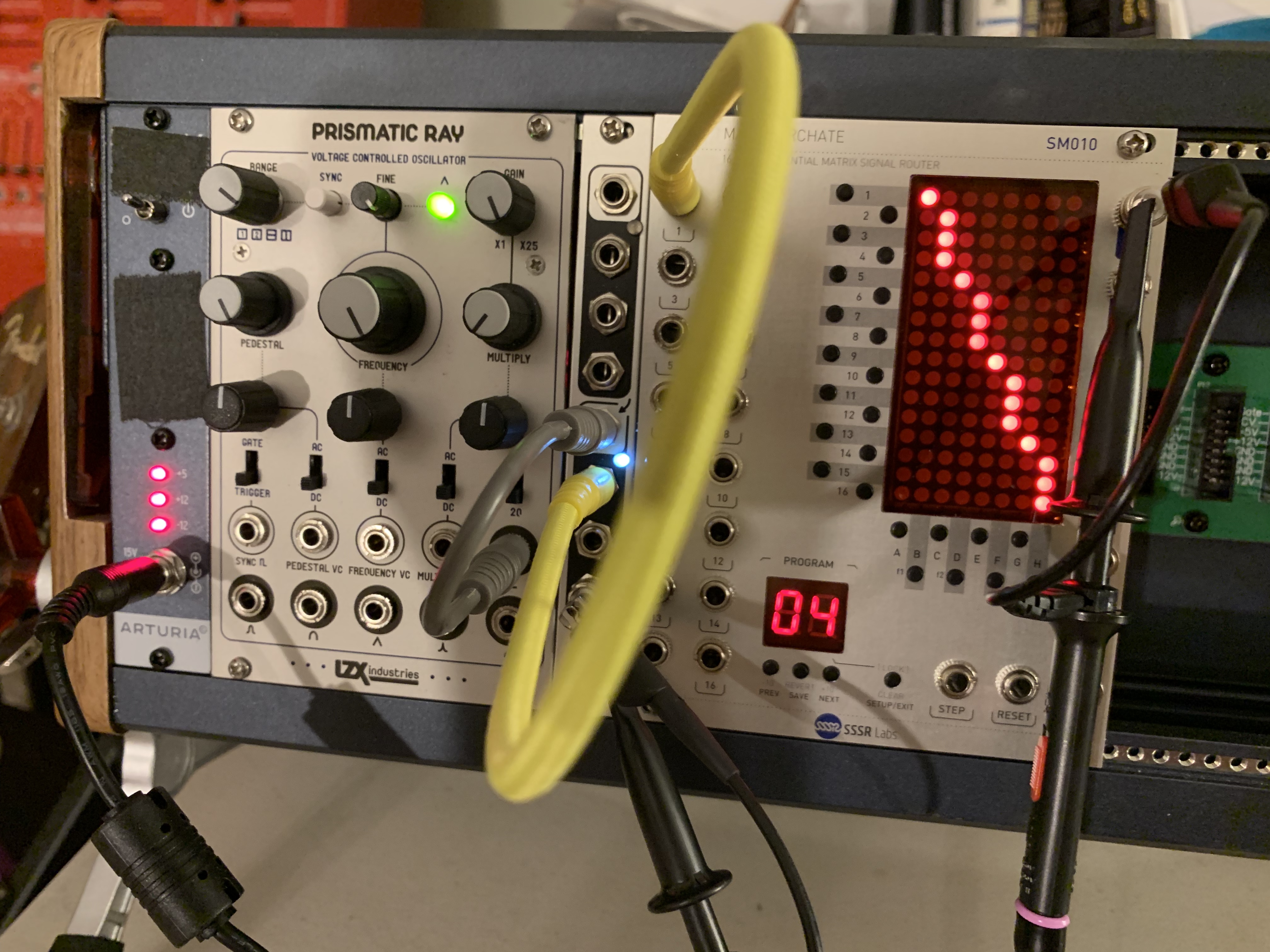

The bad news is that it doesn’t pass the oscilloscope test and it will blur your crisp edges. I finally upgraded my home studio scope so I didn’t have to lug modules to the lab for testing. Here’s a Prismatic Ray square wave at max frequency (yellow) routed into a 4ms Buffered Mult and into Matrixarchate input 1, and the resulting wave appearing at output A (purple.)
Something else in the design must be attenuating higher frequency signals. That doesn’t mean it’s not useful, but now people can make an informed decision!

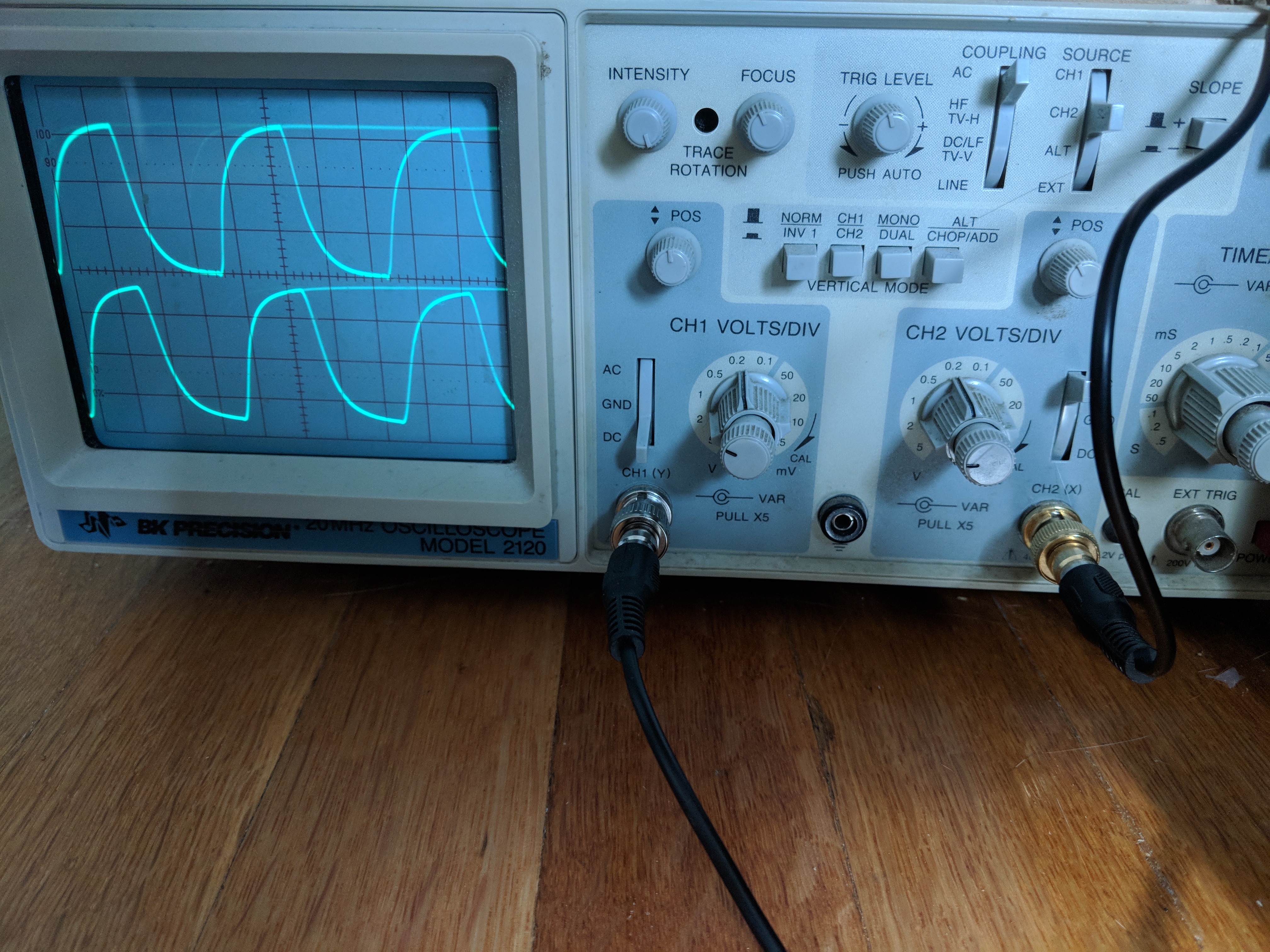

I also just got one of these, intending to primarily use it with video. I haven’t found edge blurring to be a problem visually so far and can’t see any difference between the waveforms with this patch (using Bridge as a buffered multiple), though I’m using a 20MHz analog scope.
IMG_20190828_084011

Are your probes set to 1X or 10X? I went through this same journey (using 1X probes, not using a buffered mult) and folks on Discord gave me great feedback on accurately measuring the PR square wave
But yes I agree, if the effects aren’t noticeable with your style and system then it’s quite useful!

Ah, yeah, that probably explains why these don’t look nearly so square. These aren’t scope probes at all, just minijack/RCA cables -> RCA/BNC adapters -> scope, no doubt a wild journey in impedance mismatch. I’ll patch something up tonight to do some more A/B testing with hard keys / video sources.

Yeah, it’s annoying that there isn’t an off-the-shelf euro solution for high-impedance probes (that I’ve found.) I just use bare 1/8” plug ends and clip a normal probe to the solder points.

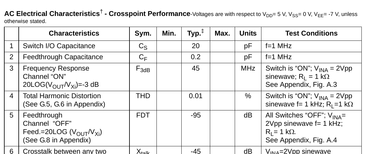

If you search for the datasheet of the MMT8816
https://www.microsemi.com/document-portal/doc_download/127038-mt8816-datasheet-sept11
you will see that on the electric specs it claims to have 45Mhz somewhere on the frequency response
Screenshot_2019-09-18_10-34-33
its fast, but not fast enough as shown on the scope pics of the first post.
