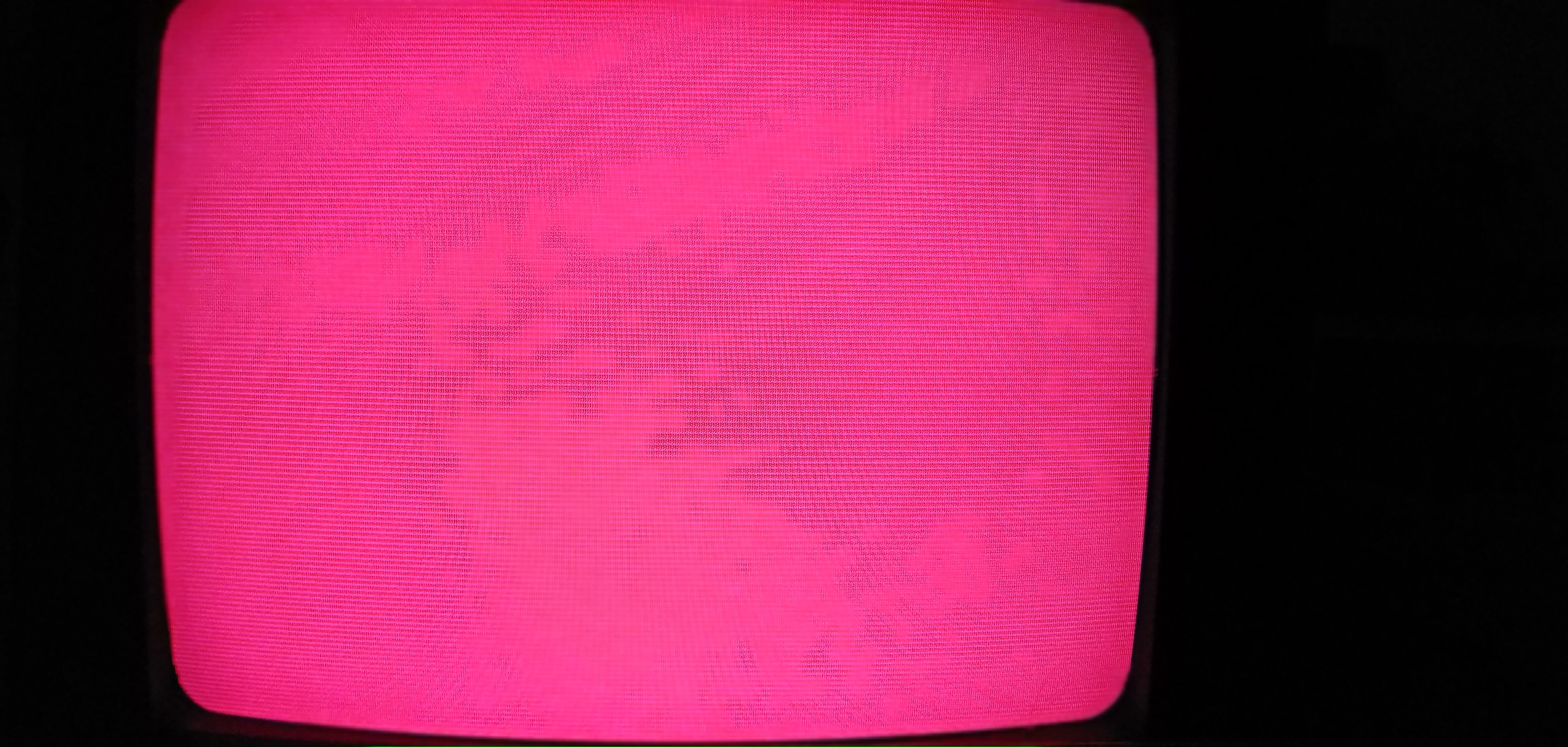

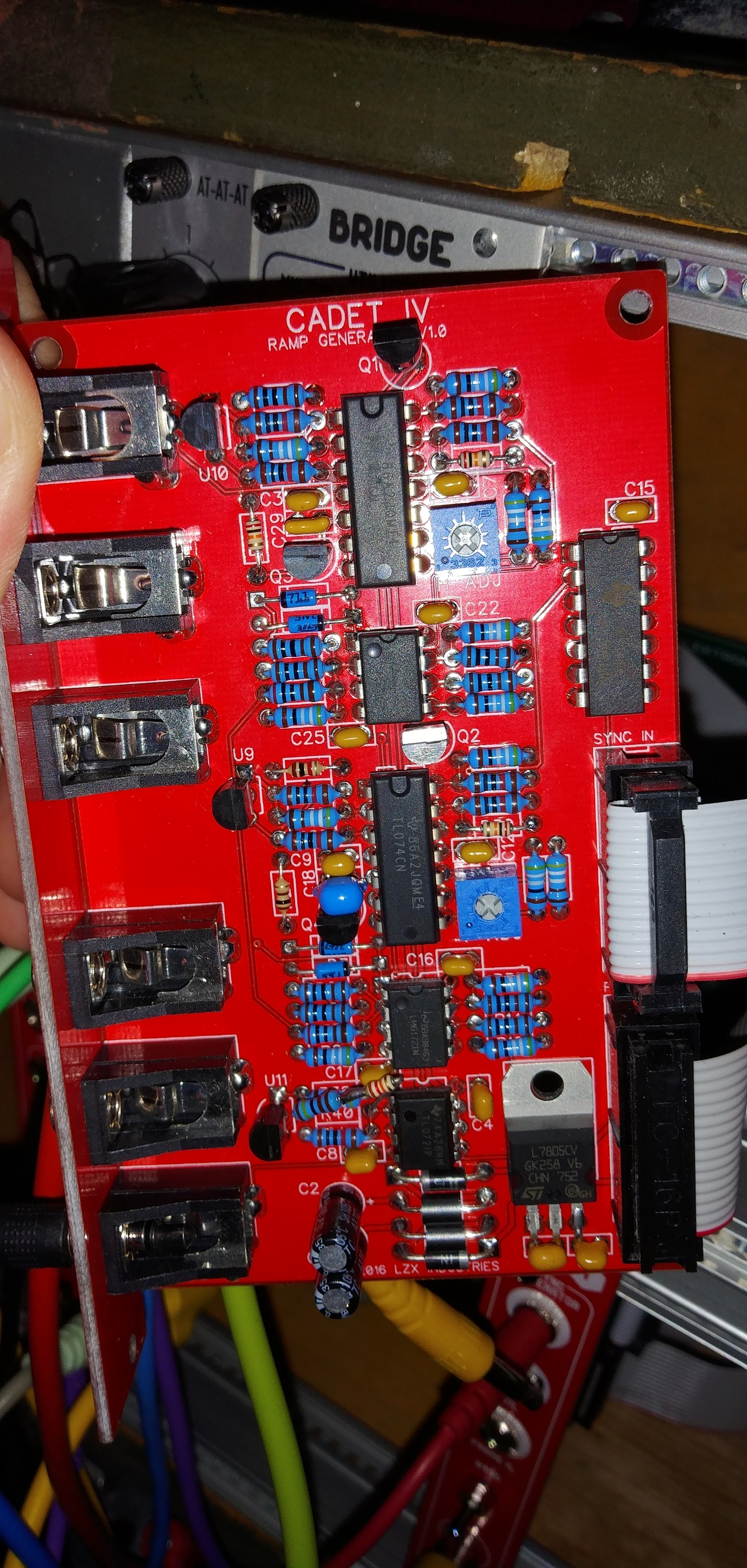

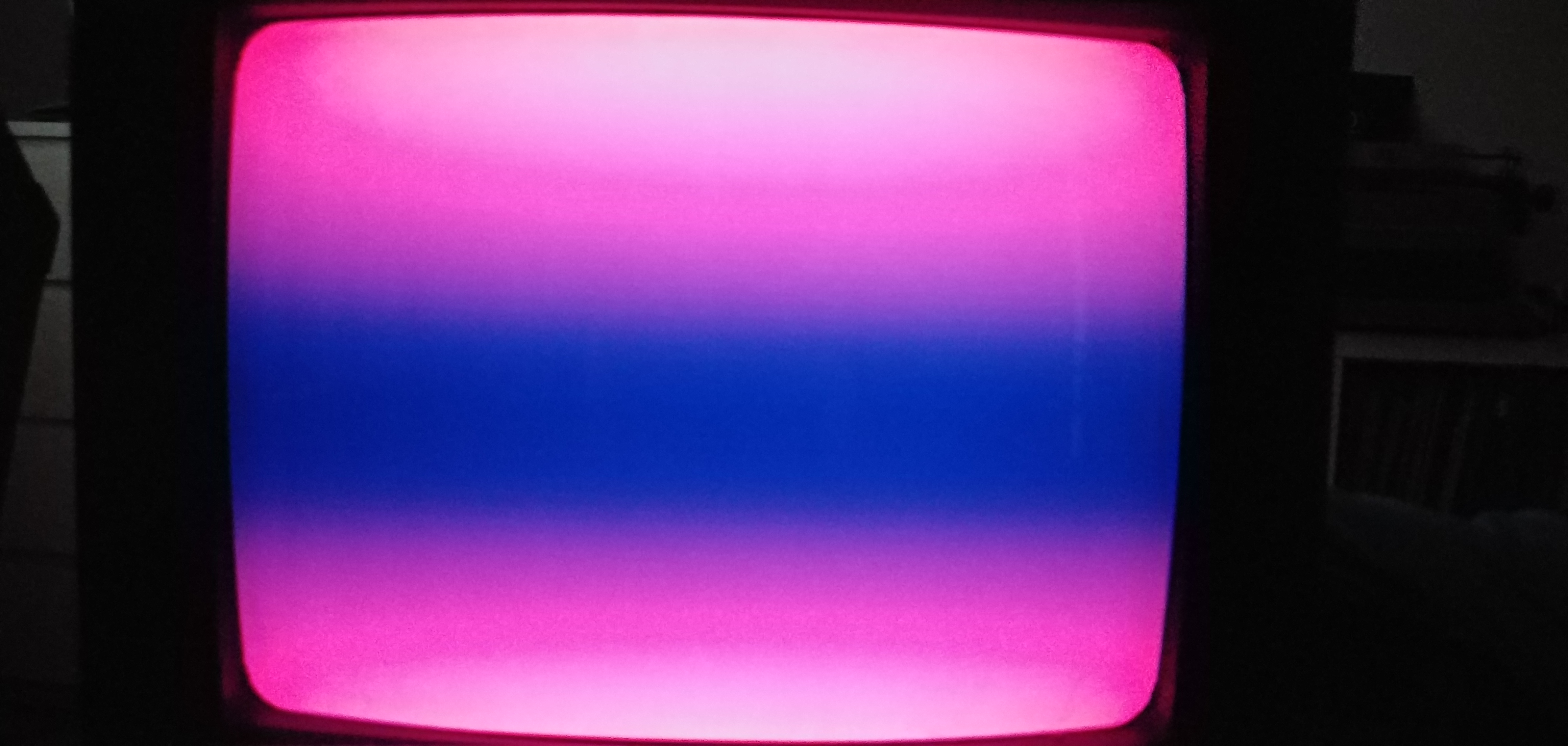

My Cadet IV Ramp top horizontal section outputs only two “full” outputs (no lines or seperations visible even when attenuated) and one output does not work at all - the trimmers do not seem to change anything either. The bottom (vertical) section puts out horizontal bars though which are a bit confusing as well - are not these supposed to be the other way round?
The trimmers can adjust the width and position of them well in that bottom section. I have taken photos of the outputs and the board as well.
H output:
20190827_164958
V output: 20190827_164927
Board: 20190827_165128
Thanks in advance!
#2 — reverselandfill · 2019-08-30

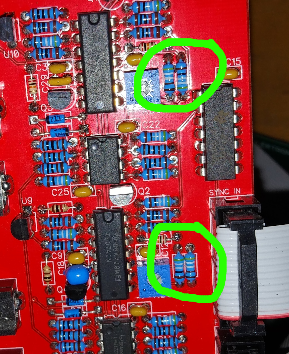

1st thing I notice: what is going on with the clutter of resistors in the lower left corner?
I will check it against my Ramps later.
#3 — banyek · 2019-08-30
I was going to add this too - it was basically a compensation of resistor values, since we did not have the proper ones and sorted out the problem this way. And to tell you the truth the bottom section does work, it is the upper section that does not.

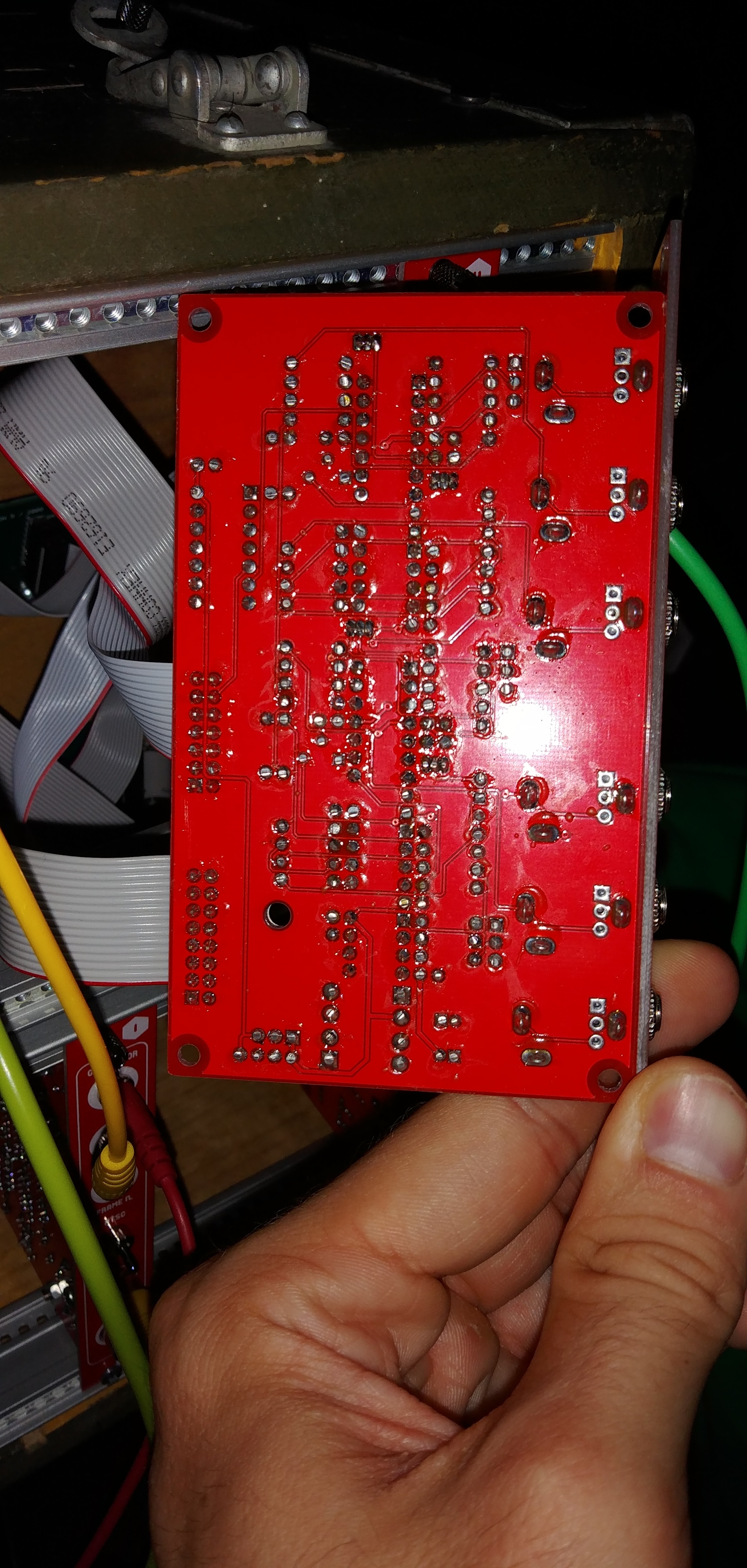

#4 — reverselandfill · 2019-08-30
can you also post a pic of the backside?
#5 — banyek · 2019-08-30
Here we go:
20190830_090607
#6 — reverselandfill · 2019-08-30
these two should be the same value (100r)looks like different values on your board

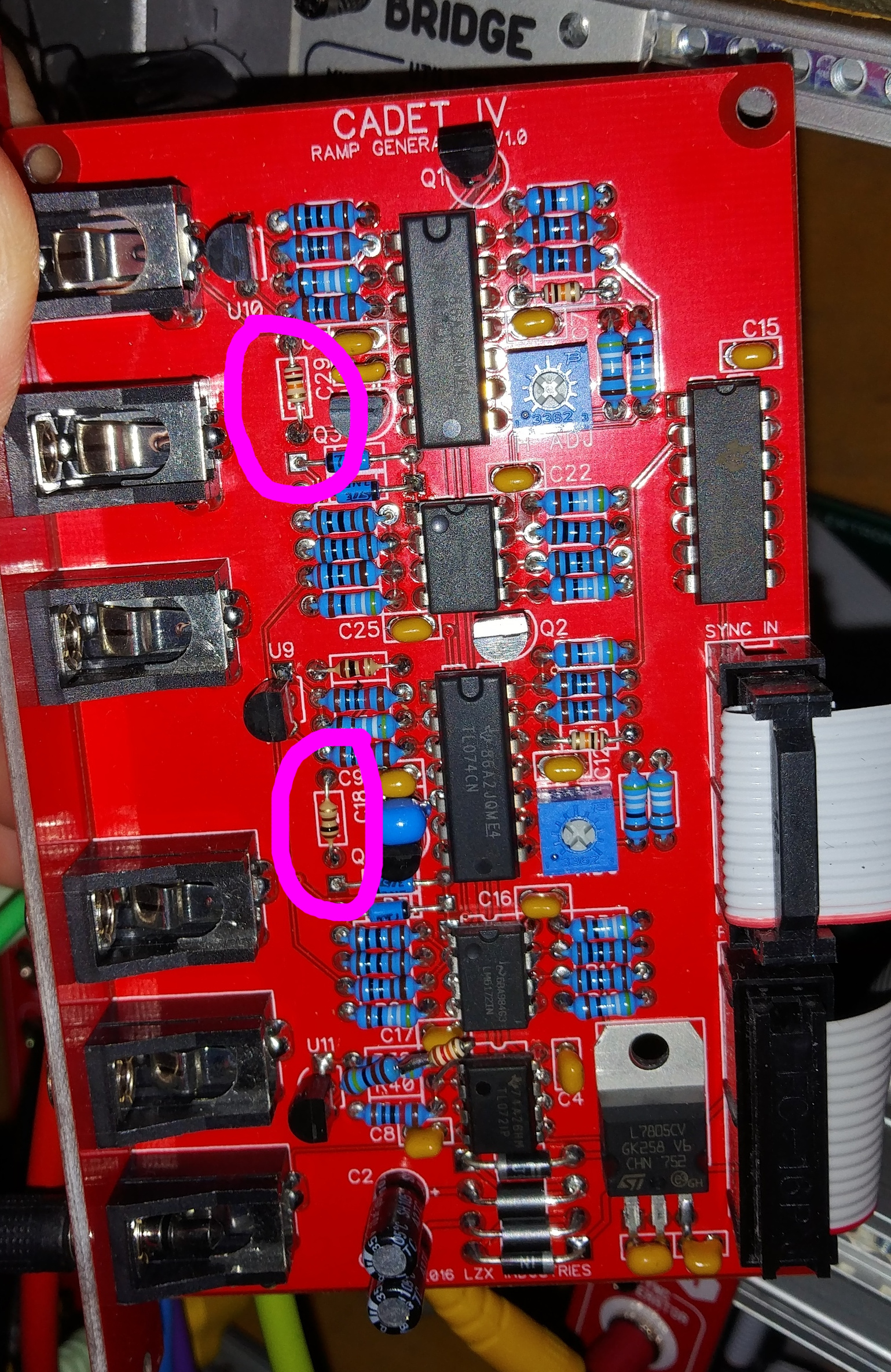

#11 — reverselandfill · 2019-09-05
disregard the picture with green circles for now. they might be correct
I don’t have a pic of the bare pcb so the value codes are hard to check
the other things are more important:
desolder the cap and make sure the 2x 100r is correct (pict with the purple circles)
