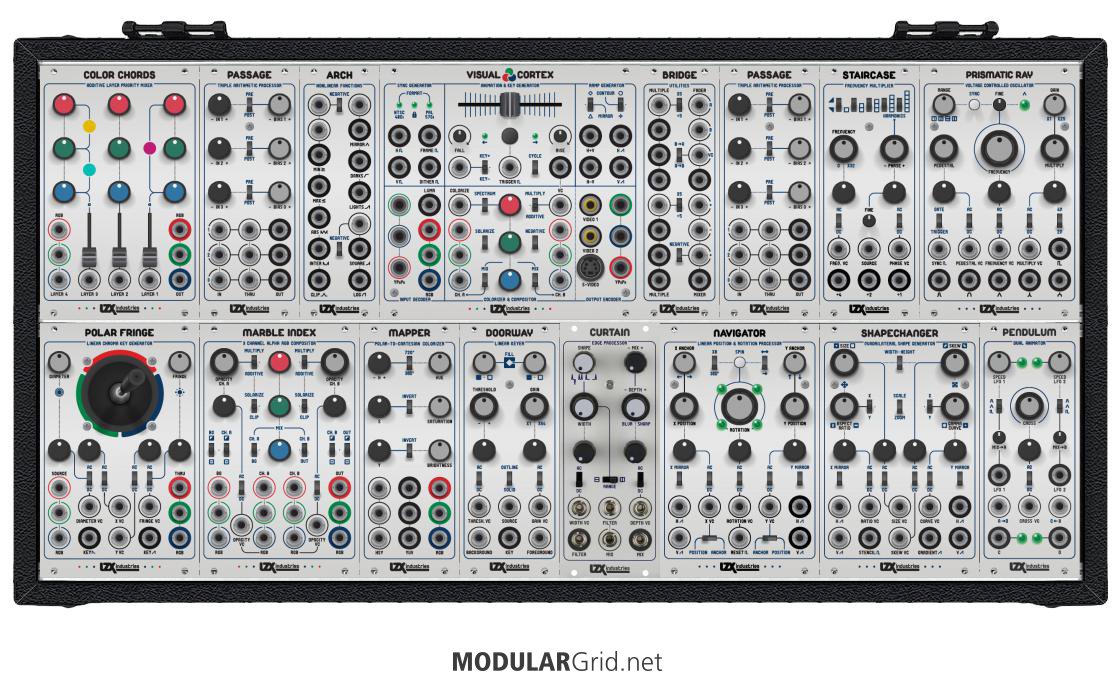

In theory, I’m a big fan of symmetry. I liked laying out and installing this system:
https://www.modulargrid.net/e/racks/view/650169Alternate Single Vessel - Eurorack Modular System from 337is
Link: Alternate Single Vessel
With the Vessel case, it takes a bit of shuffling to fit things in. And for the longest time, I really wanted my Visual Cortex to be to the extreme right side of the case to allow for the shortest cable runs to my external gear. Eventually though, I came around to having it more in the middle of the case to allow for easier signal flow access by other modules within the case. I actually quite like this layout, but, it’s really only useful for processing, or with another case for shape generation.

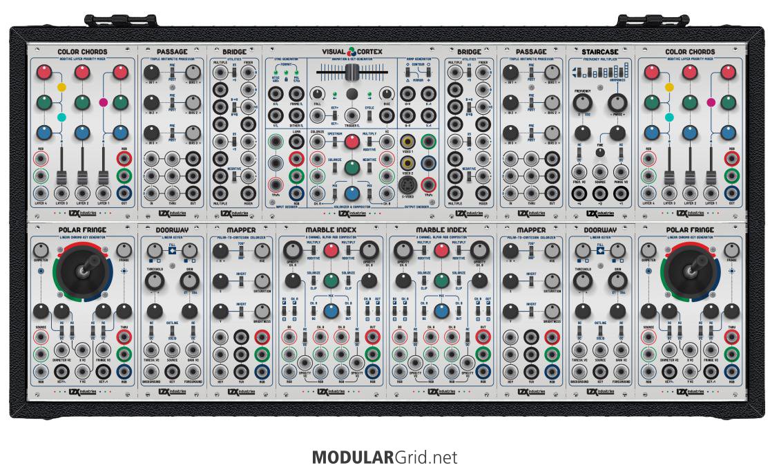

So I moved in this direction for a single case, with the idea being able to do a little bit of everything in one, easy to transport, case:
https://www.modulargrid.net/e/racks/view/658220Current Single Vessel - Eurorack Modular System from 337is
Link: Current Single Vessel
I really like this layout and it has been very fruitful in my practice.
