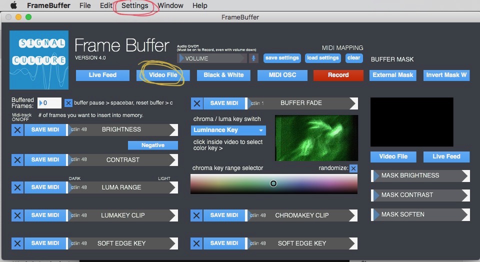

Signal Culture Frame Buffer (version 4.0) to open and playback video file (This can be done numerous ways, with any app that can output to Syphon [Max/MSP/Jitter, etc], Frame Buffer is just what I happened to be using at this time).
- Select video file for playback by clicking on Video File and navigating to your existing video file

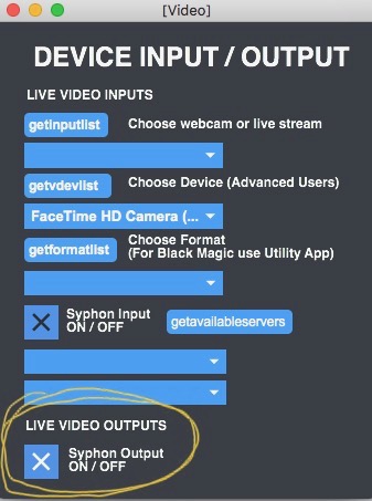

- Select Settings, Video Input/Output:
Under LIVE VIDEO OUTPUTS turn on Syphon Output:

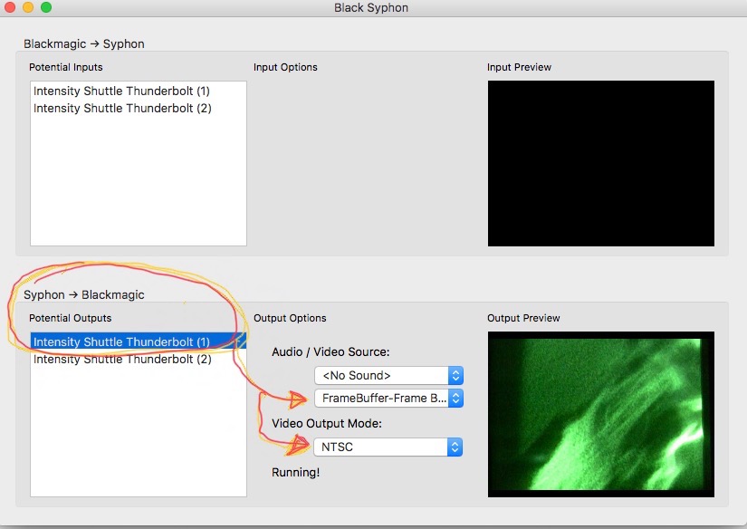

Black Syphon (version 4):
- Under Syphon → Blackmagic
- Audio/Video Source, select FrameBuffer from dropdown
- Video Output Mode, set to desired output, in my case NTSC:

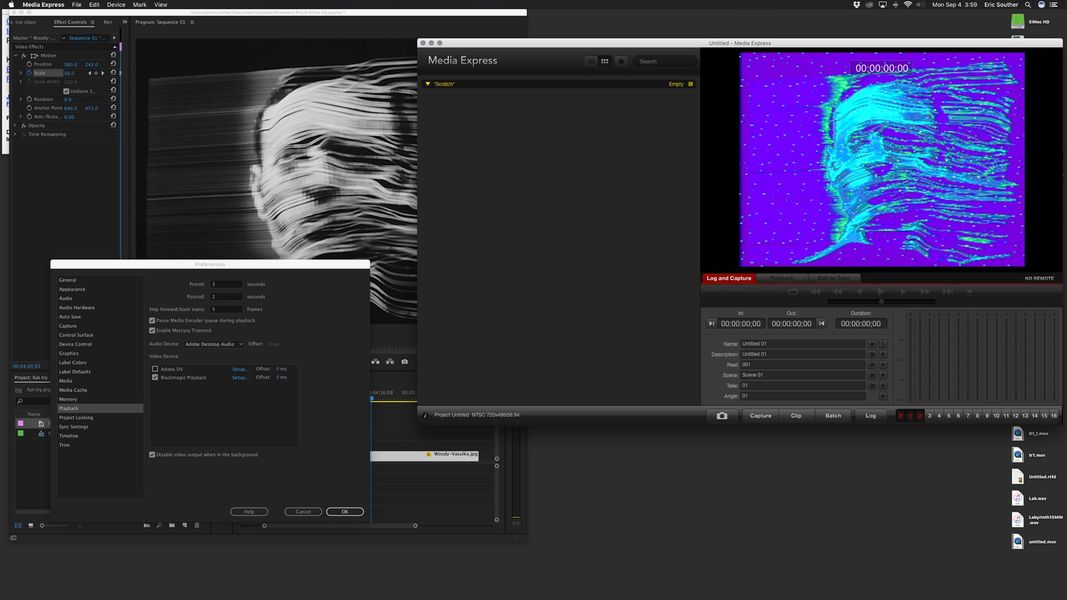

https://www.facebook.com/groups/lzxindustries/permalink/814631635374825/Leslie Rollins and I got two Blackmagic shuttles to output from CPU into LZX and back to CPU for capture. You can do it all in MAX/MSP or Premiere and Blackmagic Media Express combo. The patch...
Link: LZX Video Synth Community | Leslie Rollins and I got two Blackmagic shuttles...
Leslie Rollins and I got two Blackmagic shuttles to output from CPU into LZX and back to CPU for capture. You can do it all in MAX/MSP or Premiere and Blackmagic Media Express combo. The patch includes an xfade for feedback. (photo credit to Woody Vasulka)
