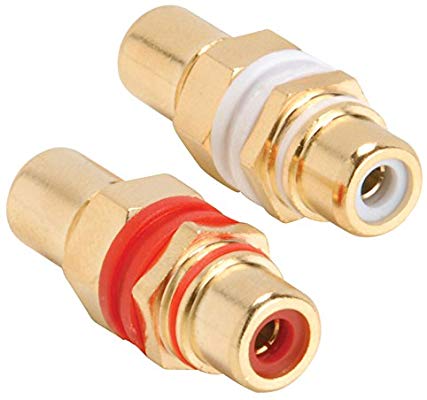

  3. If you want to send sync to rear RCA connections, you could make your own bulkhead panel using jacks like these:
amazon.com
https://www.amazon.com/Parts-Express-Gold-Bulkhead-White/dp/B0002KR3VM
RCA to RCA bulkhead female connectors. Designed to be used in our wall plate system. 1 red, 1 white.
Link: Amazon.com: Parts Express Gold RCA Jack Bulkhead Red/White Pair Hex Type: Home Audio & Theater

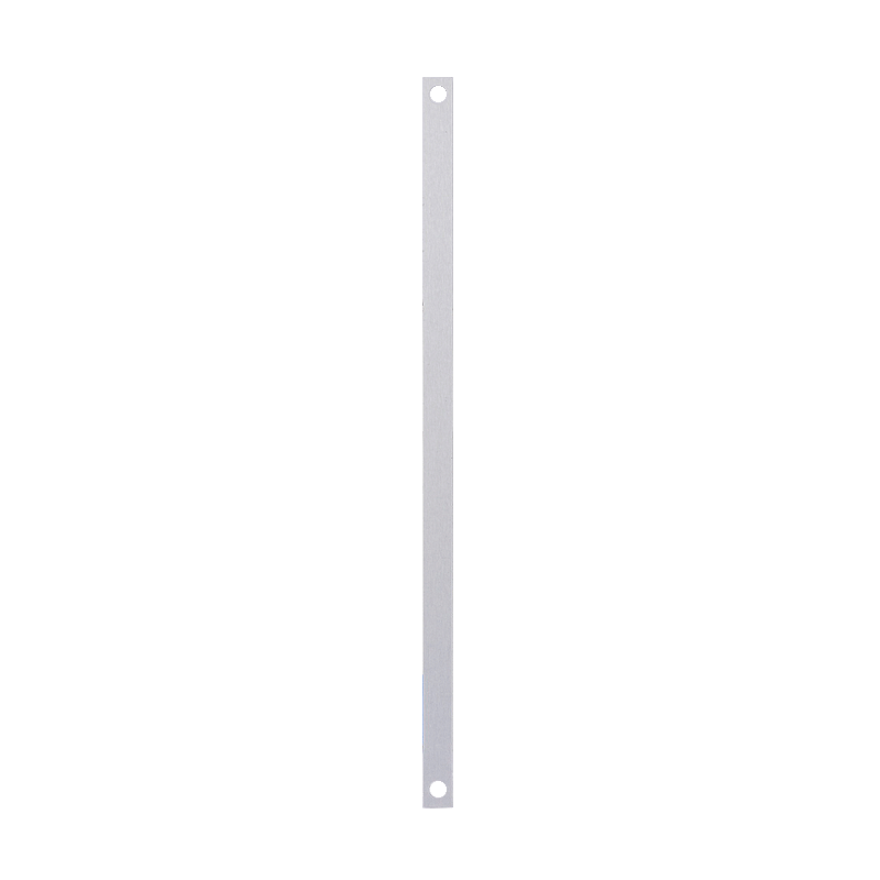

And drilling holes in a blank EuroRack frontpanel like this:
CONTROL
https://www.ctrl-mod.com/products/blank-panelBlank/blind panel in sizes 1HP thru 48HP, select drop down from above to choose. To be used for DIY modules and as a safety fill in to a case. Screws not included. Height: 3UMaterials: Anodized AluminumMade in the USA
Price: From $3.50 USDBrand: Control
Link: Aluminum Blank Panels 1HP thru 48HP
