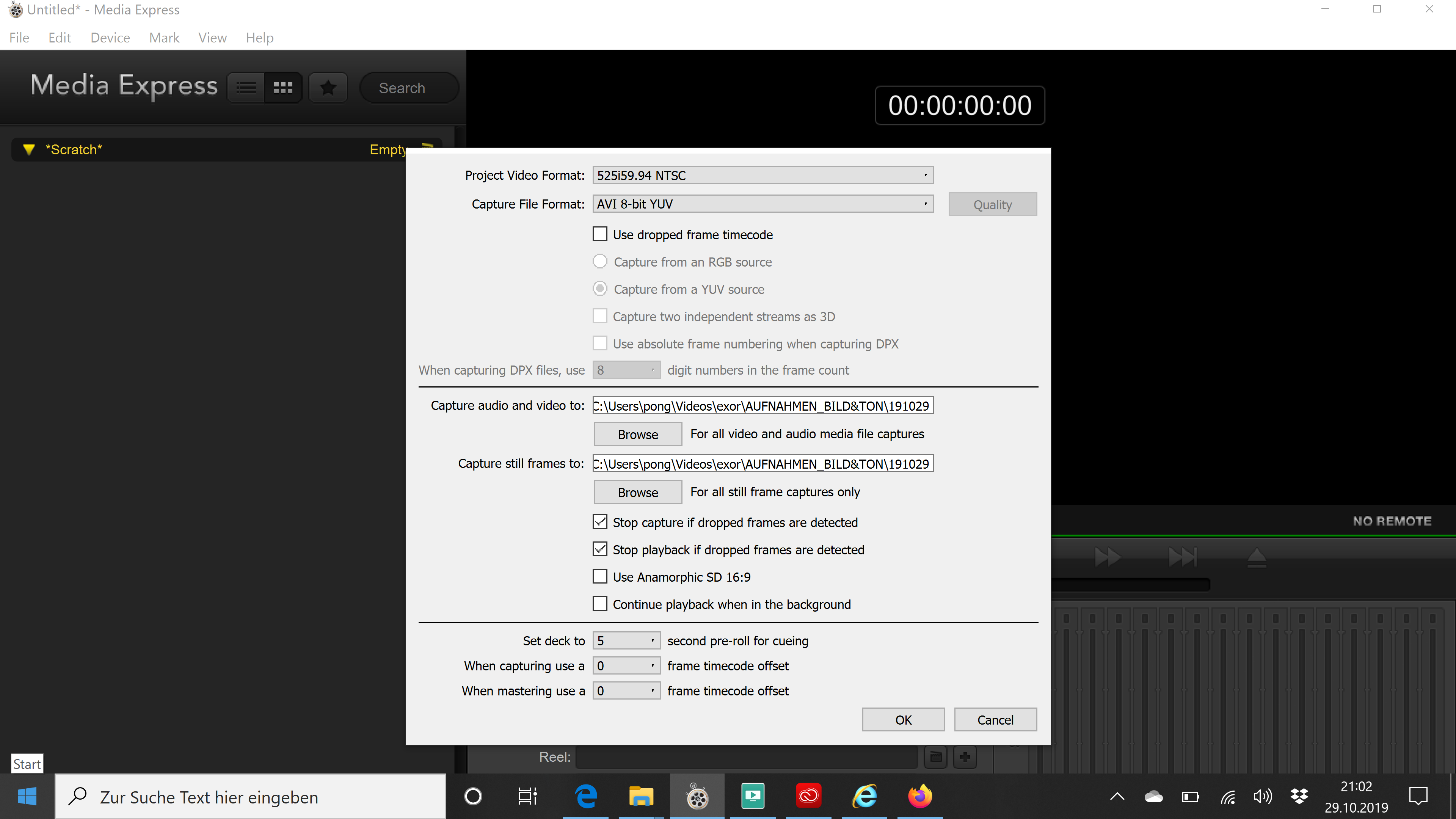

heres my workflow for capture a video with audio:
i capture both adio and video with blackmagic intesity shuttle…
out of shuttel comes a biiiig file, usually 4 minutes of video are like 5 GB of data ,
39
then i put it in adobe premiere and convert it into a smaller file…at the end its this:
Videocodec-Typ: MP4/MOV H.264
Typ: MPEG-Film
Dateigröße: 351,86 MB
Bildgröße: 720 x 484
Framerate: 29,97
Pixel-Seitenverhältnis: 0,9091but the quality is not that great… i mean there must be a better way between 359 mb and 4 gb is a lot of space ? someone got any andvice?

I would suggest editing and exporting at a higher resolution than 720x480. If you have the means to upscale to HD on capture, that is ideal. If not, scale in Premiere when editing.
#4 — tylerm · 2019-10-31
I’ve never been able to get the upscaling options in Blackmagic software to work at the capture stage. It feels like those options are doing absolutely nothing at all. If I want to enable that, do I need to change my project settings in BM Media Express? I’m still configuring my input on desktop video setup to accept SD video. Maybe the output needs to be set to HD, and then the project settings in Media Express need to reflect that??
