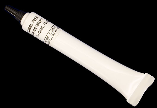

Alright folks the solution I’m suggesting here is using Nyogel 767a damping grease.
A small swath along the inside of both tracks of the joystick has improved tactile performance dramatically. Smooth travel and solid hold.

https://www.oveready.com/flashlight/nyogel-767aa-damping-grease-10g-tube/767a stays where it is put, making it the preferred lubricant for sight scopes, telescopes, microscopes, and anywhere clear viewing is a must.
Link: NyoGel 767a Damping Grease (10g Tube) - OVEREADY
