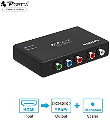

#4 — Marizu · 2019-11-08
This has converted multiple HDMI devices to standard def component for me.
The important thing is that it has a scaler to bring the output down to SD.
The Sony DSC-1024 is a good option (I have one too), but it doesn’t directly take HDMI.
