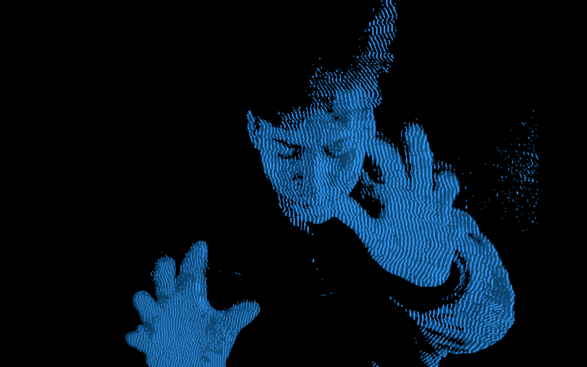

Here’s an example of the effect I’m trying to create:
LUMEN-TEST-03
This was done using Lumen, but I’m really hoping I can find an analog solution with the Vidiot. I think the result will be several orders of magnitude better if I can get it working.

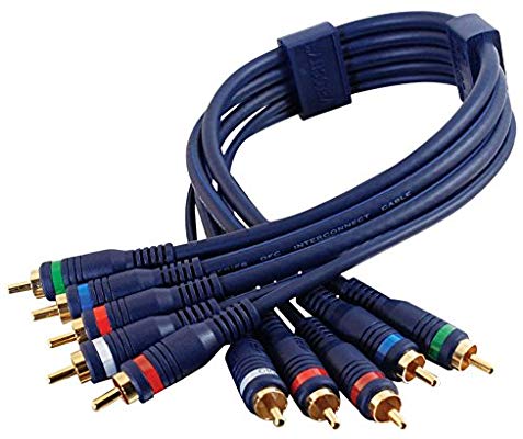

Hey guys, thanks again for the replies and all the help. I’m going to be putting together the setup Agawell suggested: 2x Shuttles, 1x Vidiot. Besides the thunderbolt cables, I wanted to double check this is the correct type of component rca cable I’m gonna need:
amazon.es
https://www.amazon.es/Velocity-Component-RCA-Type-Combination-componente/dp/B002DR4F5O/ref=asc_df_B002DR4F5O/?tag=googshopes-21&linkCode=df0&hvadid=356513084831&hvpos=1o1&hvnetw=g&hvrand=8856597782873350766&hvpone&hvptwo&hvqmt&hvdev=c&hvdvcmdl&hvlocint&hvlocphy=9061032&hvtargid=pla-672007019640&psc=1 9,37 € Link: C2G 0.5m Velocity Component Video/RCA-Type Audio Combination Cable componente...

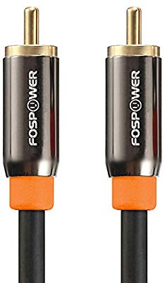

#9 — Z0NK0UT · 2019-11-20
Any type of male RCA cable will work, but I prefer cables that are not bundled together.
amazon.es
https://www.amazon.es/FosPower-Chapado-Conectores-Premium-Digital/dp/B0184PIVFI 7,99 € Link: [FosPower Cable de Audio RCA (0,9m/3ft) RCA Macho a RCA Macho 24K Oro Chapado...
