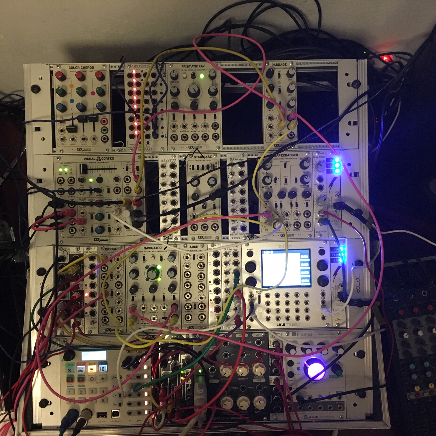

#6 — pong · 2019-11-19
here, and thanks for all your help! niceee!
it always moves from out of the center…
IMG_4125
the patch is (each ramp sperate, h=magenta, v=yellow) :
vc >>passage >>navigator>> [sh.ch. h and v in>> sh.ch. gradient out]>>vc. ch. b in
#7 — pong · 2019-11-19
heeee boyzzz and girlzzzz… I found the solution! …wow, took me some hours …
:space_invader:
:space_invader:
:space_invader:
:space_invader:
:space_invader:
:space_invader:
:space_invader:
:space_invader:
:space_invader:
:space_invader:
:space_invader:
:space_invader:
:space_invader:
:space_invader:
:space_invader:
:space_invader:
:space_invader:
:space_invader:
:space_invader:
:space_invader:
:space_invader:
:space_invader:
:space_invader:
:space_invader:
:space_invader:
theres nothing wrong with my patch, but in order to move the whole pattern (the diamond) with passage the diamond may not come from visual cortex.
that means, froms visual cortex you get a non mirrored ramp, and you create the diamond with the double mirror functionion in navigator…
that way you can move the diamond on x and y axis ! :boom:
haha now my mind can rest, and i can patch in peace … P.I.P
