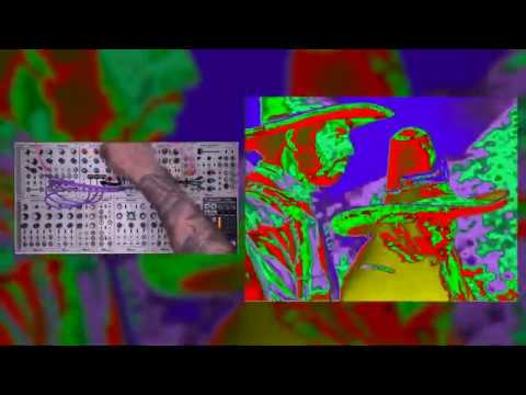

patch a single luma video source into “input”, then patch as many outputs to as many colors as possible-- going to all 6 inputs on Cortex then setting up an additive blend is a good way to get plenty of variety. set the left knob low, the right knob high. try modulating the gain with a video pattern – very unique function in this case, like modulating 5 doorways in parallel.
[Robin Burke]
Send all 6 outs from the Topogram to two Passages & then bring a Senory Translator & other modulation sources into play
[Luix Bot]
feed it a lfo (like pendulum 0v-1v) and convert it into complex multi output LFO
[Nichole Pichon]
use the thru output as feedback into the gain/upper/lower inputs
polar fringe pos/neg key outs into the upper/lower inputs makes for a crazy colorization patch basis
topogram thru output goes into doorway source in
premixing video with slow strobing CV before going to topogram input
U/V outputs from mapper into upper/lower ins. Y from mapper into source of topogram
we use a reverselandfill matrix mixer to mix 4 outs from the topogram together.
sensory translator + topogram outs going into a passage is great fun for audio reactive patching
