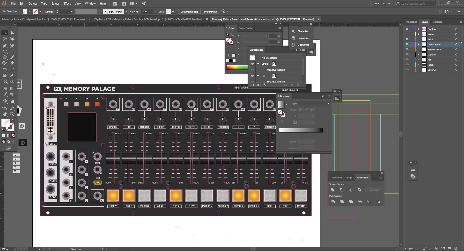

It all starts in Adobe Illustrator, where we do all our brainstorm work. Many weeks of moving things around, spacing out artwork, and creating vector illustrations of components we’ve selected leads up to a final design. We are a very visual team (haha!) and like to see a polished presentation during development. Often electronics design and PCB layout happen concurrently with this process, making Adobe Illustrator & Diptrace Schematic & PCB Layout the two most frequently used applications in our process.

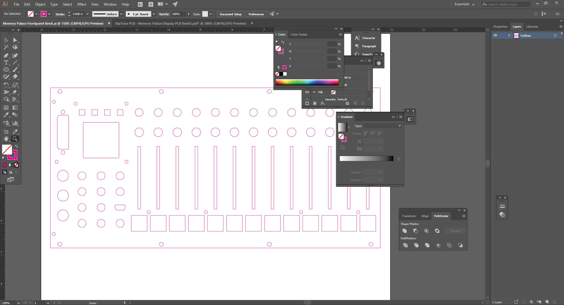

As we begin to prepare formal documentation, all part locations and dimensions are triple checked and a cut lines layer is created over the frontpanel mockup. (This art is in progress.)
MemPalFront_AdobeRender
MemPalFront_Adobe

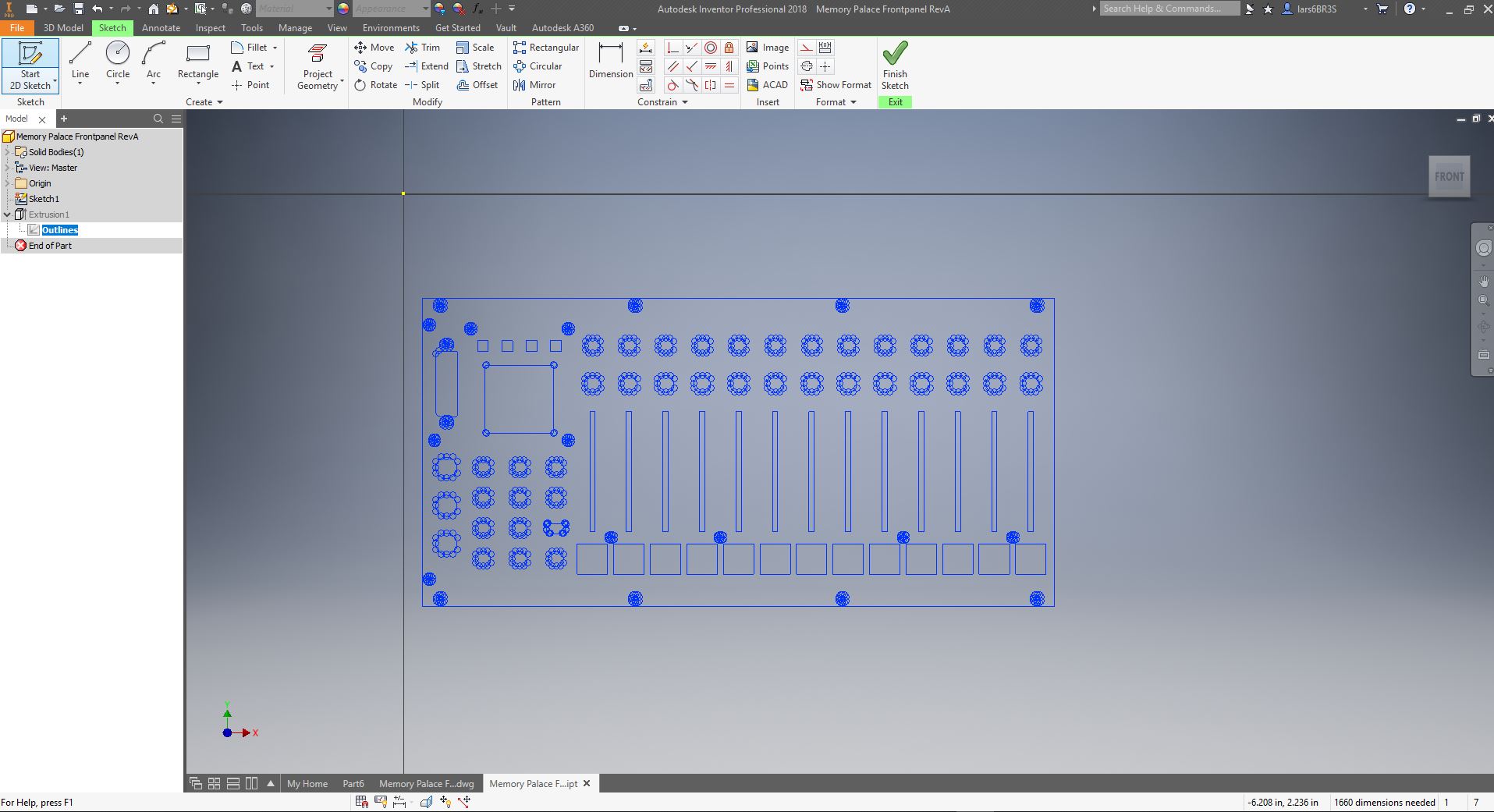

The outlines layer from Adobe Illustrator is exported as an Autocad DXF file. This is then imported into Autodesk Inventor, into a new 2D sketch.
MemPalFront_Outlines
The sketch is then extruded to make a 3D model of the part. In this case, it’s a very simple single step! When we do sheet metal boxes with bends and folds, such as we did with Vidiot and Vessel, the process gets more involved.
MemPalFront_Panel
The resulting frontpanel part is then imported into an Autodesk Inventor assembly file. Buried standoff parts from the Inventor parts library are then imported and aligned with their installation locations. In this case, we have three different lengths of M2.5 standoffs (6mm, 10mm, and 18mm.) Memory Palace is a complex assembly, which makes 3D CAD essential for virtual test fitting of all the pieces.
