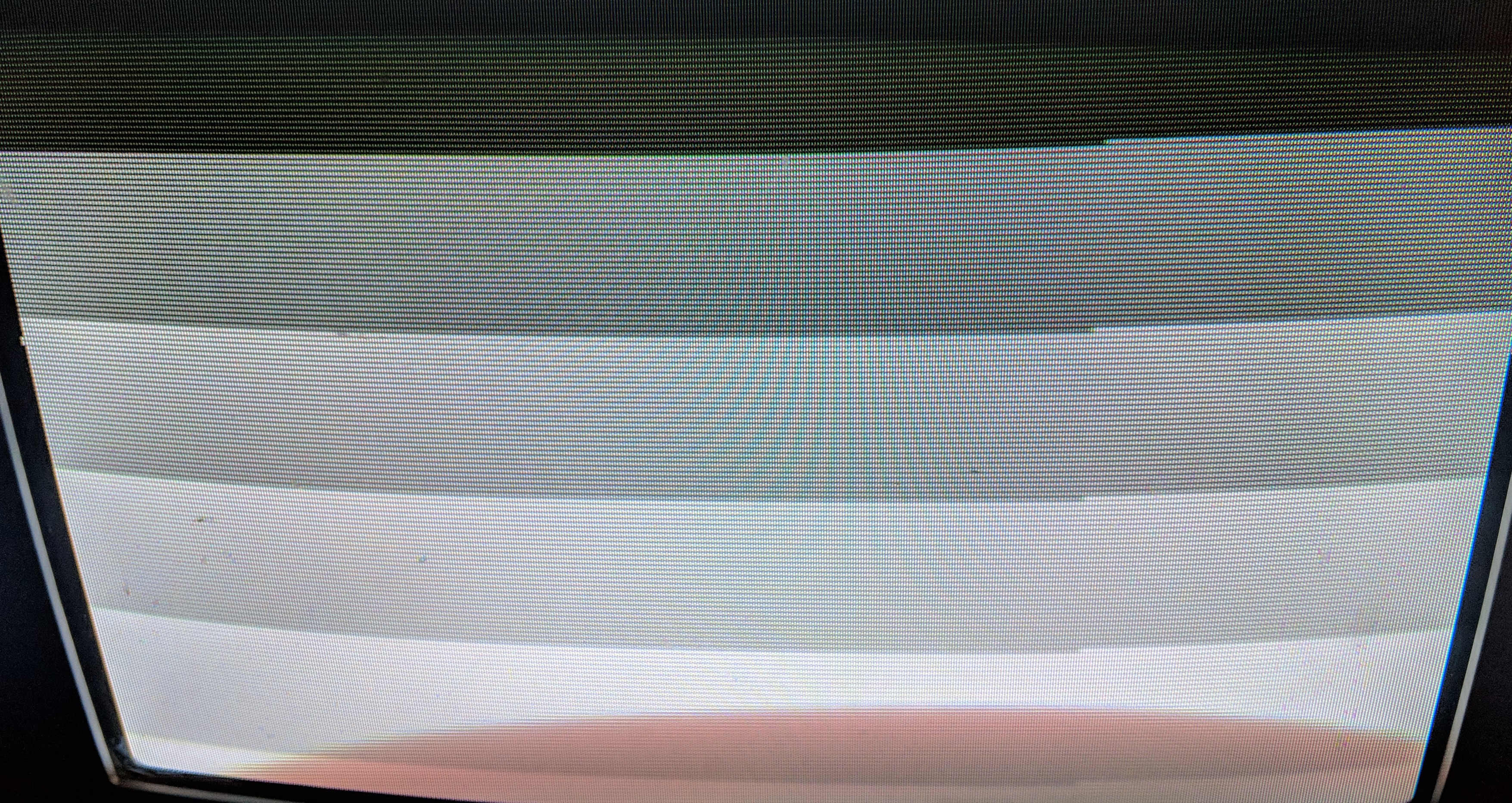

Here are some bad photos. First from a 19" consumer CRT TV:

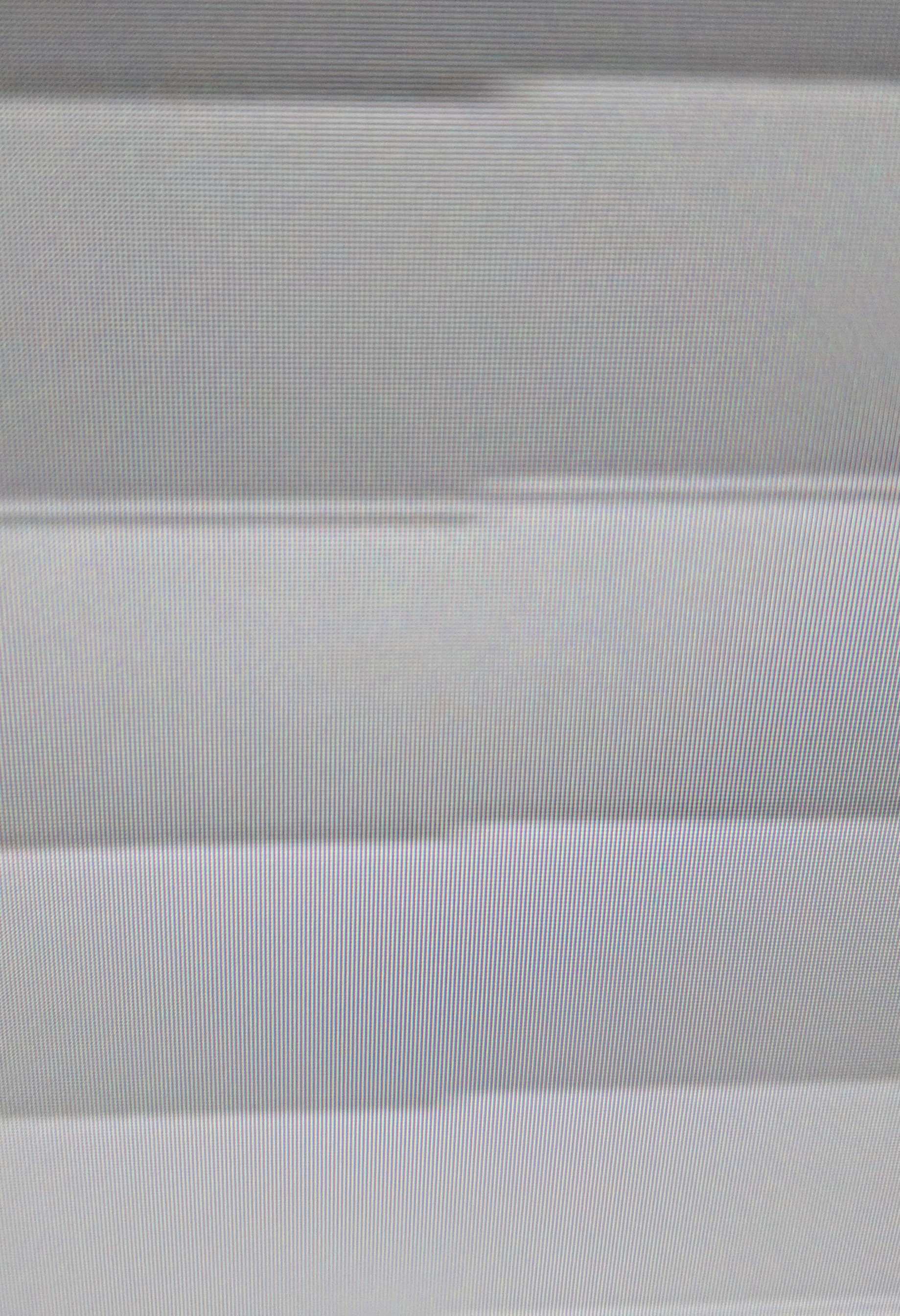

And from the same display, a closeup of one discontinuity:

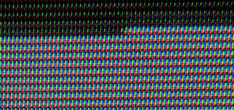

On the analog display the image also jitters quite a bit, and at these brightness transitions it seems like there is a scanline being “skipped”. I can’t really capture this photographing the analog display, you can see it a bit more clearly with this closeup photo of an LCD I have with a composite input and a less-than-great deinterlacer/upscaler.

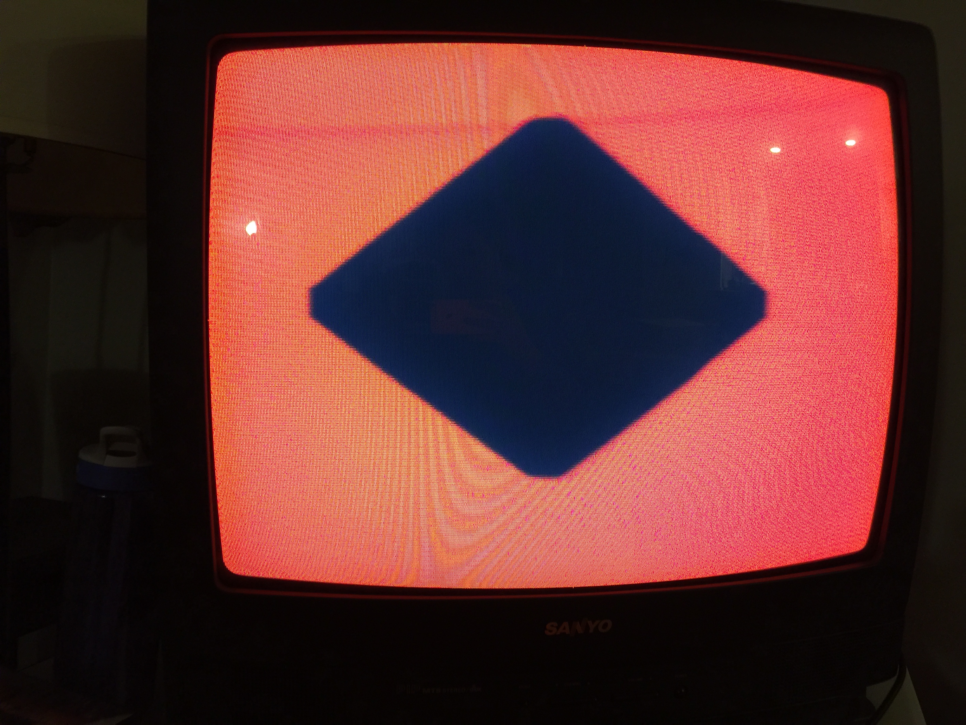

Last night while patching with Diver I noticed when I put it through doorway to get a diamond shape or circle shape using the mirrored linear and log ramps, that when I set my threshold up to make a smaller shape, I would sometimes end up with shapes that had corners cut off, so my diamond had kind of blunt square edges and the curved edges of my circle were squaring off as the shape got smaller. After 10 or 15 minutes I got nice pointed corners on my diamond and round circles without any change to my patching. I tried to reproduce the soft corners but couldn’t get it to happen by any means other than waiting and having the issue show up again. I am fairly confident this is not due to a patching error as I was just using the basic technique of feeding the mirrored h+v ramps into Source on Doorway and increasing the gain to get defined edges / using threshold to adjust the size of the shape.

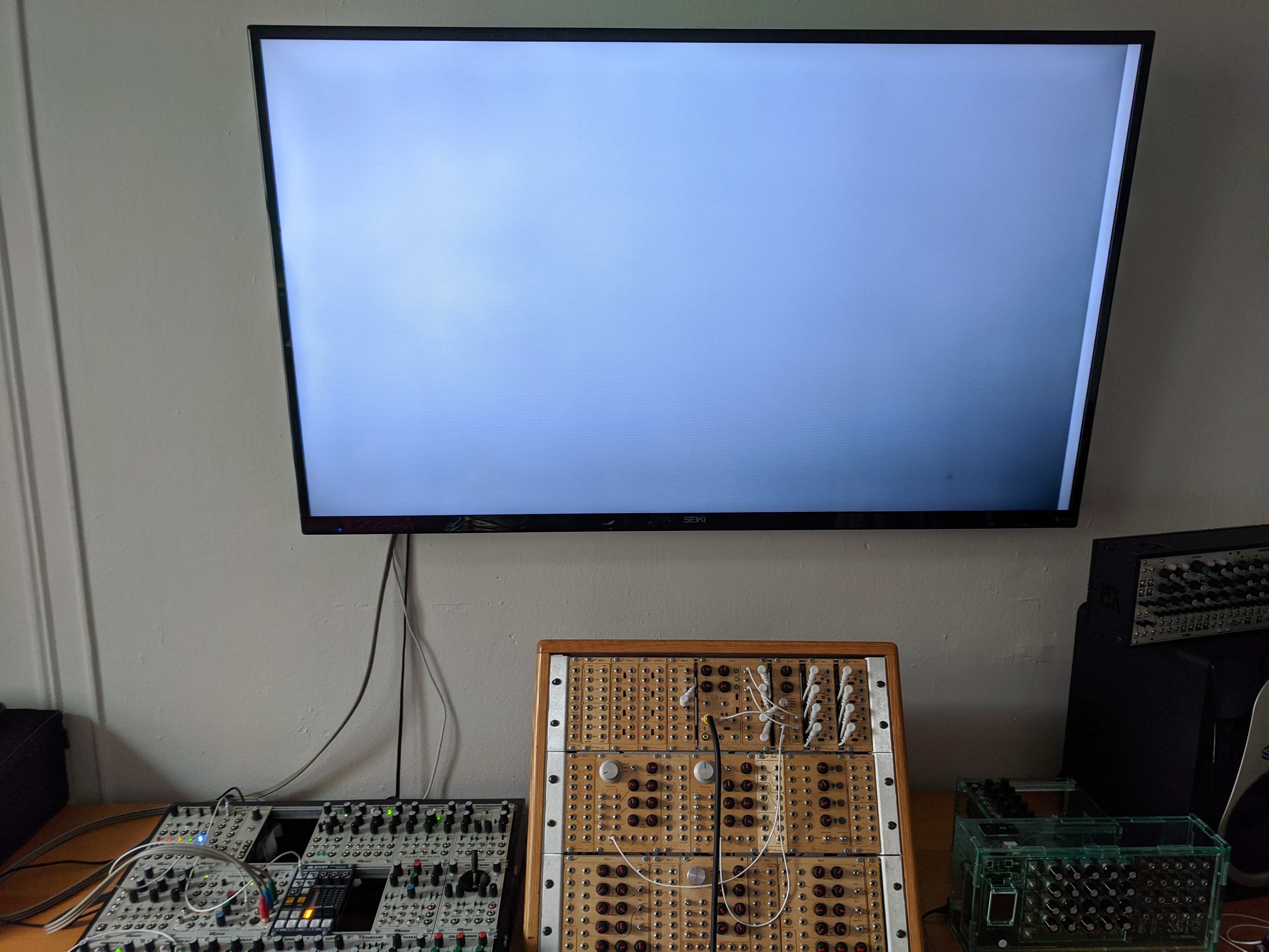

hi, I just got a Diver with an X offset issue. How may I get this fixed? thanks!
(note - in this picture, I’m inverting the H+V out through Arch to make the offset easier to spot)
