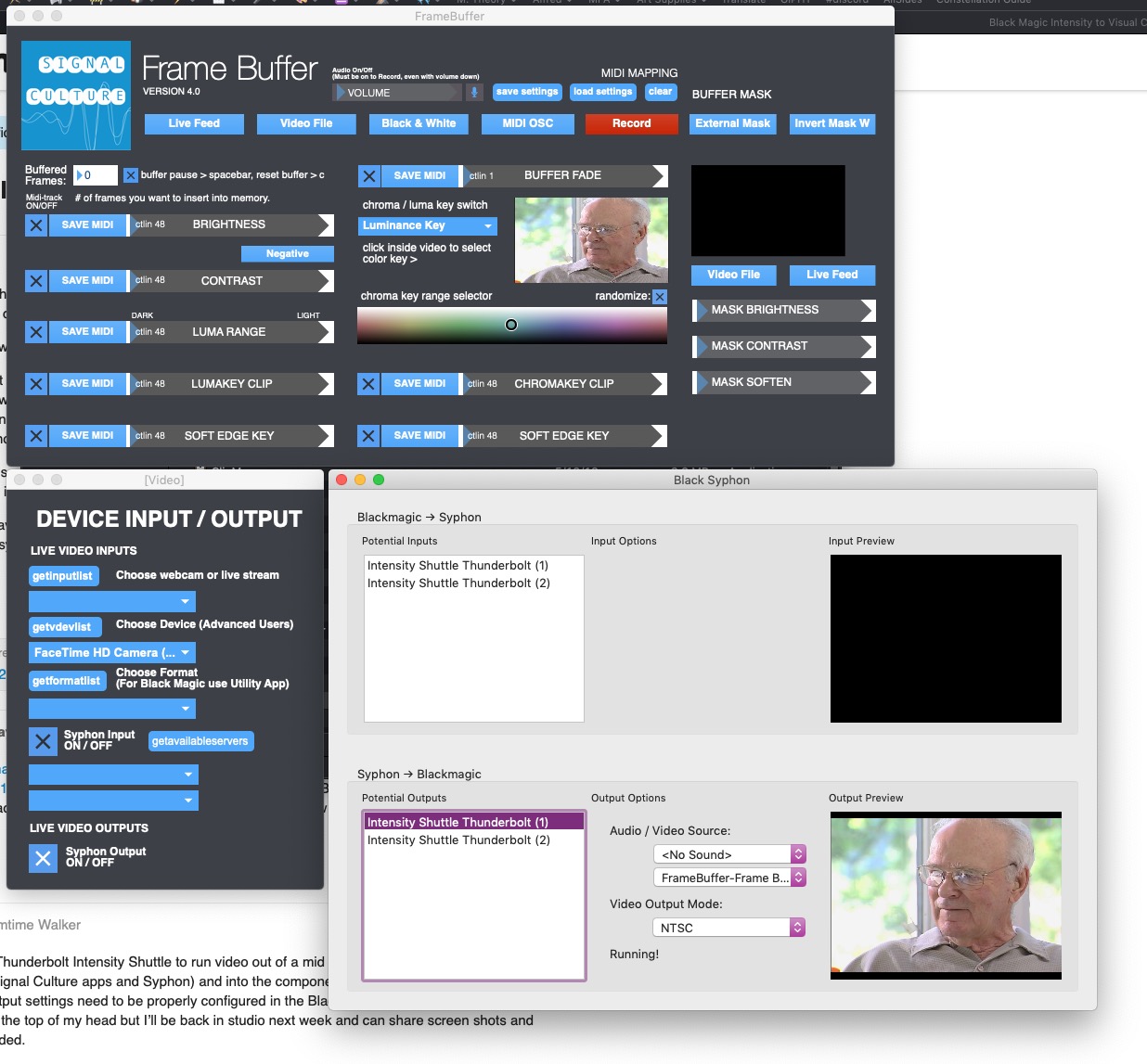

#8 — 337is · 2020-01-14
Good luck in studio tonight. I had a chance to set things up in my studio and here are some screen captures that might be useful to you.
This setup lets me play back media on my Mac through one Thunderbolt Intensity Shuttle to YPbPr Component ins on Visual Cortex, and concurrently capture on the same Mac with a second Thunderbolt Intensity Shuttle connected to Visual Cortex YPbPr Component outs.
Software and flow that I’m using for this example:
Signal Culture Frame Buffer (picked arbitrarily as a media playback device, could be any software that can pipe to Syphon):
Black Syphon:
Frame Buffer Black Syphon Output Settings

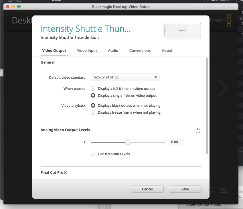

Blackmagic Desktop Video Setup:
Black Magic Desktop Video Output Settings

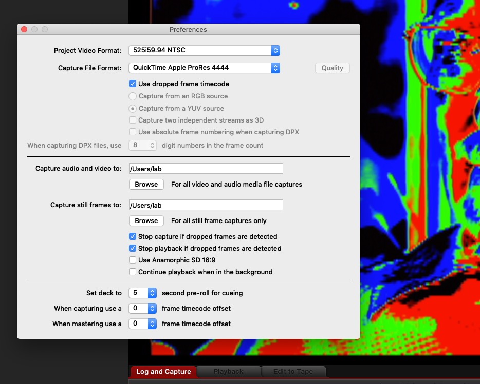

Blackmagic Media Express:
Blackmagic Media Express Input Settings
