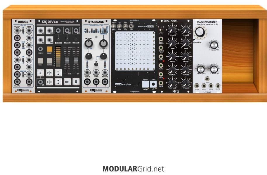

#3 — Apfelmann · 2020-01-18
Case is a döpfer lc3, sync is coming from a vidiot.
ModularGrid
https://www.modulargrid.net/e/racks/view/1009201Videorack - Eurorack Modular System from Pulex
Link: Videorack
#4 — Z0NK0UT · 2020-01-18
There could be a problem with your Diver, but it could also be that the sync from Vidiot is not sufficient. Diver is currently very sync sensitive. It might be worth waiting for the new Diver firmware to see if that helps. If not, opening a support ticket would be the way to go.
Do you happen to have a stronger sync source available? A camera or a mixer, perhaps?
