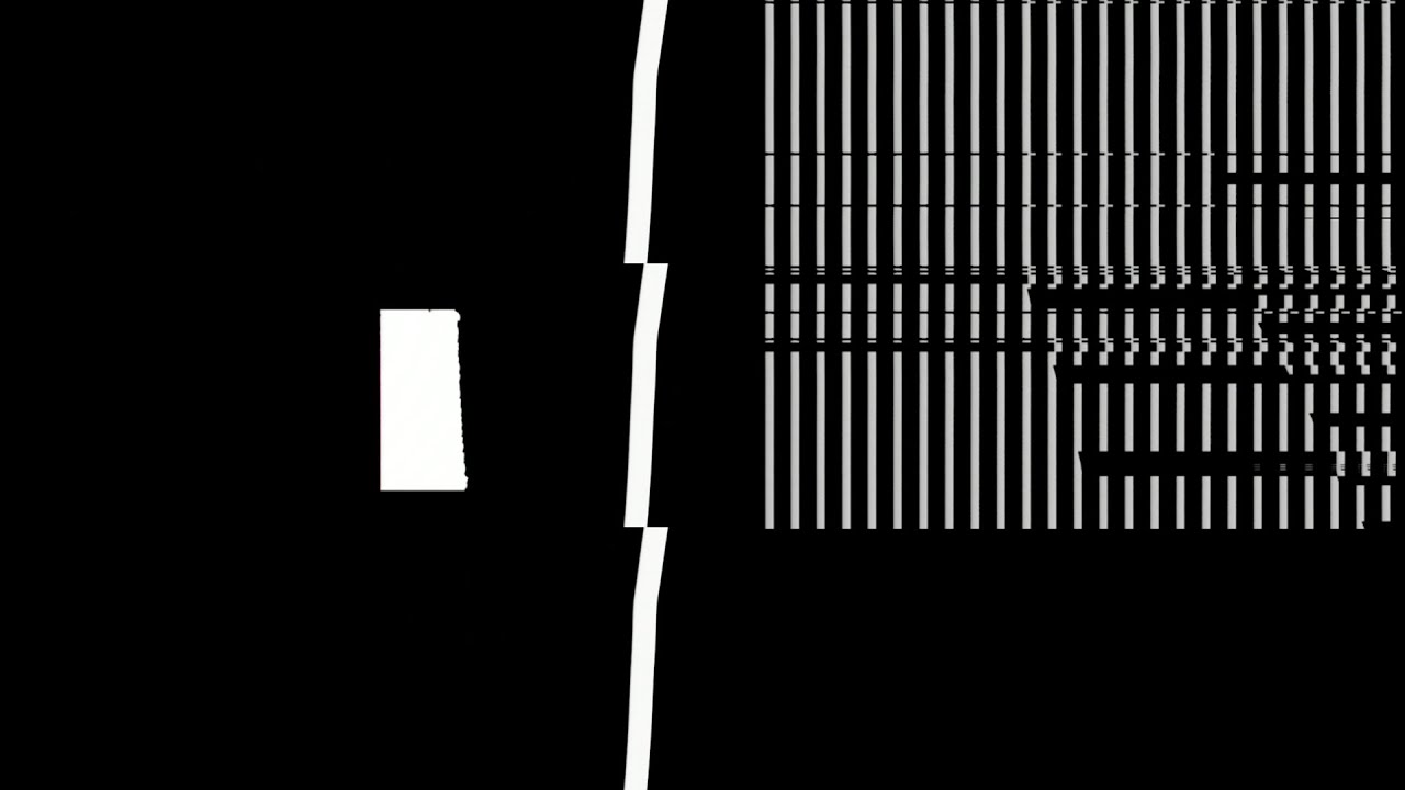

Just put together this video the other day, leaning heavily on Castle modules (especially Counter and Multi-Gate, but also Flips Flops and ADC).
https://www.youtube.com/watch?v=M9bjGDB8ZZEThough of course this is just the tip of the iceberg as far as what they can do. Wanted to keep this relatively simple, monochrome, rectilinear. I think sometimes the challenge is not to overcomplicate things.
+++ Should note, I guess, since the whole thing is composed of audiovisualization via Sensory Translator, that this is not recommended for those with photosensitivity as there is quite a bit of flashing.

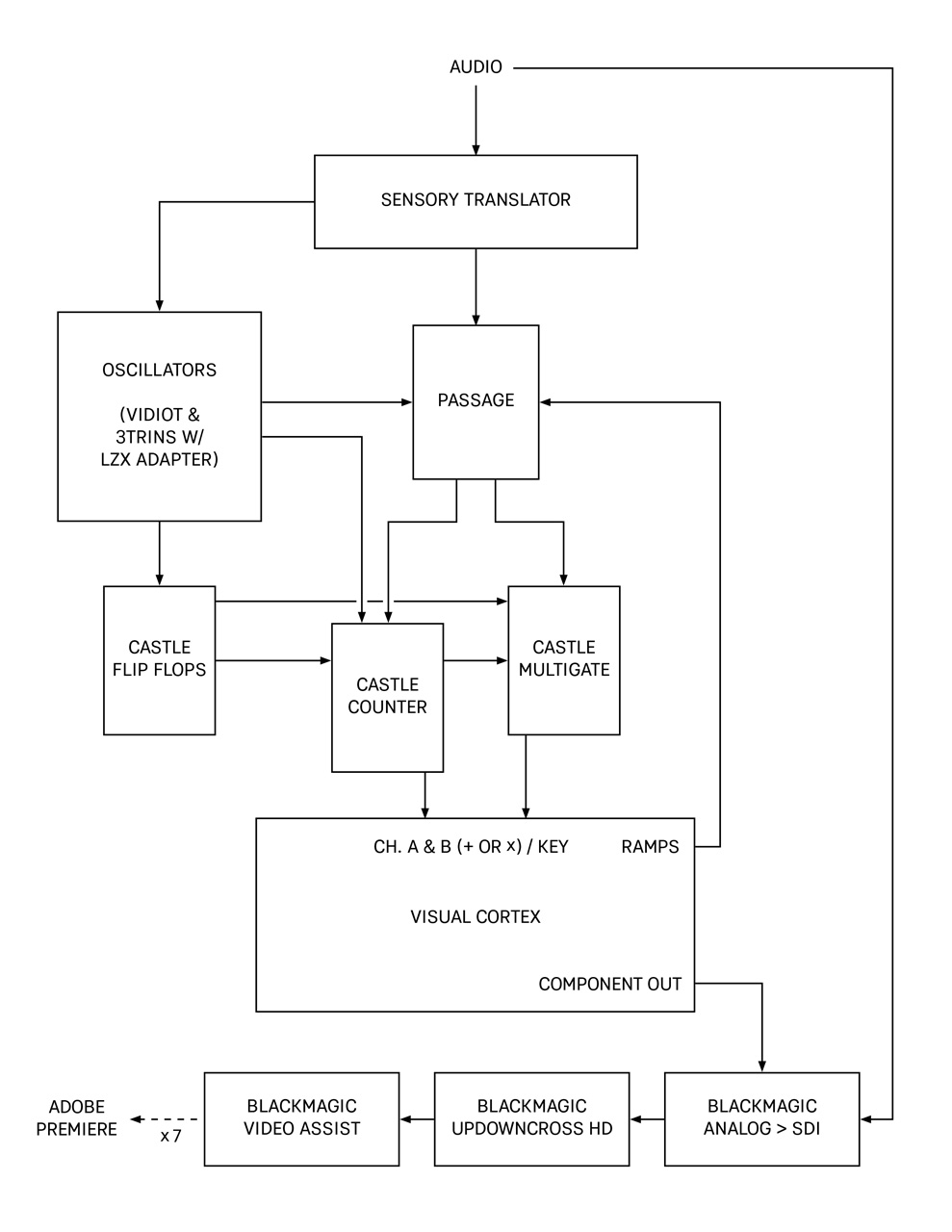

@Robbertunist Did not take photos of any of the patches used, but they were all some variation on this general signal flow:
DotMatrix_SignalFlow_2
Sometimes a module or two more was involved. Sometimes less. But mostly it was this general schema, with different oscillator settings (and osc CV settings) and different outputs from the Counter and Multigate creating vastly different results.

Excellent video above, and really appreciate the signal diagram too
:heart_eyes:
It shows that three or four Castles can be used to great effect, when supported by regular video oscs and utilities.
Whilst I’m planning to build all 8 in one go, if I had to pick and choose (and already had a few oscs), the Counter, Multigate, FlipFlops and Shift Register can all be used with any signal… a mixer or two to bring them all together could be an alternative to the DAC module

Thanks for taking the time to draw up the diagram @sean
:+1:t3:
It really helps to mentally visualise it much better than a written description. What software did you use to create it?
#25 — sean · 2020-10-21
To make the diagram? Used InDesign for that.
