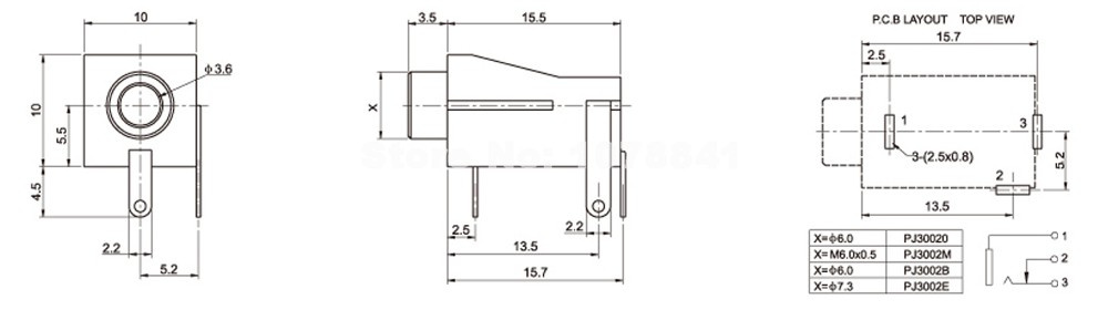

I soldered this:
red jack TIP -> green jack SWITCH
green jack TIP -> blue jack SWITCH
The SWITCH pin is located on the side:
last drawing:
1: GND
2: SWITCH
3: TIP

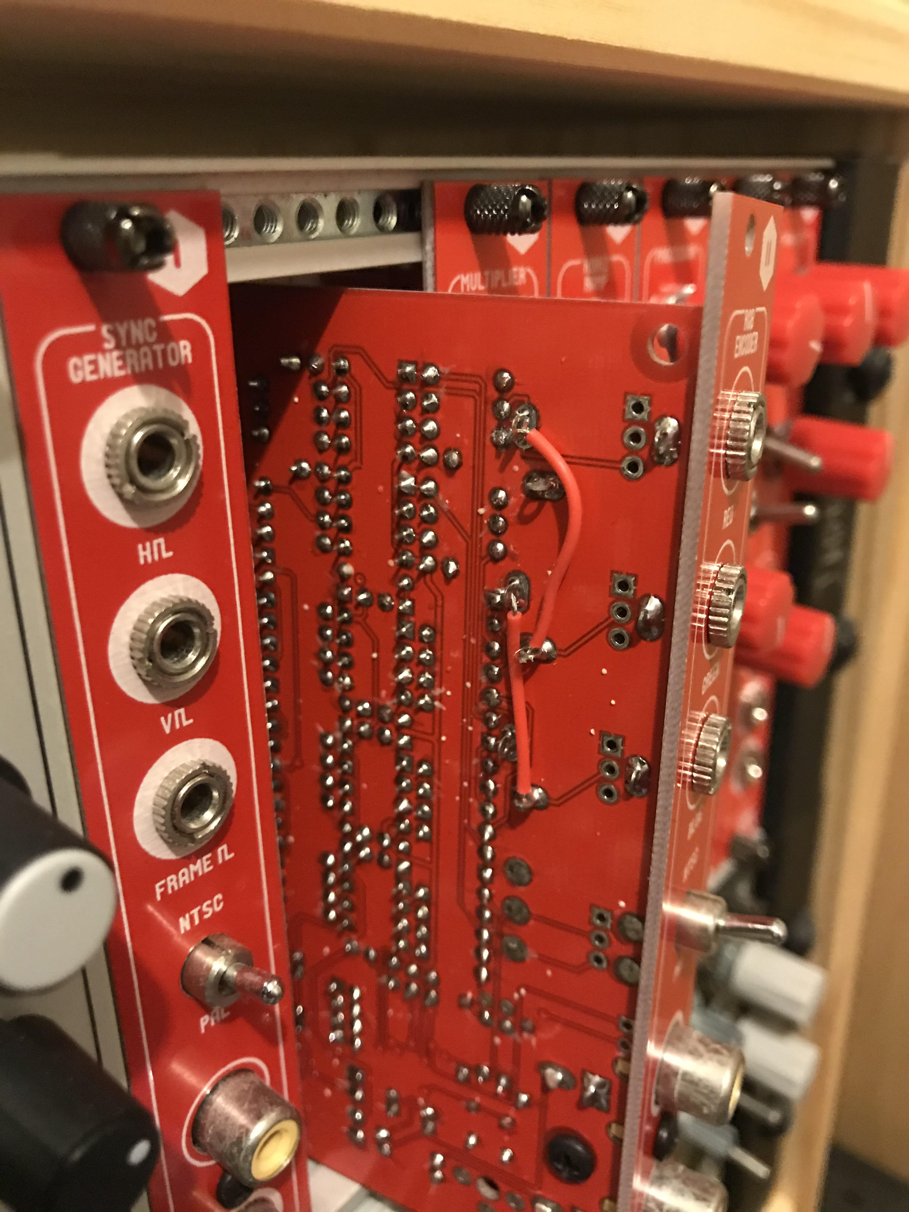

I did the same mod to mine - I highly recommend it. I found it easiest to solder my little wires on the bottom of the board, not the top, in case anyone was wondering which side to do it on. I did a cascading method where the R jack normals into the G jack and that G jack normals into the B jack. (You could also normal B into R and that way plugging into any single jack normals to the others if they don’t have anything plugged in, or you could normal R to G and R to B, or some other configuration. So many choices!)
Here’s a pic of what I did (R to G, G to B):
rgb mod
