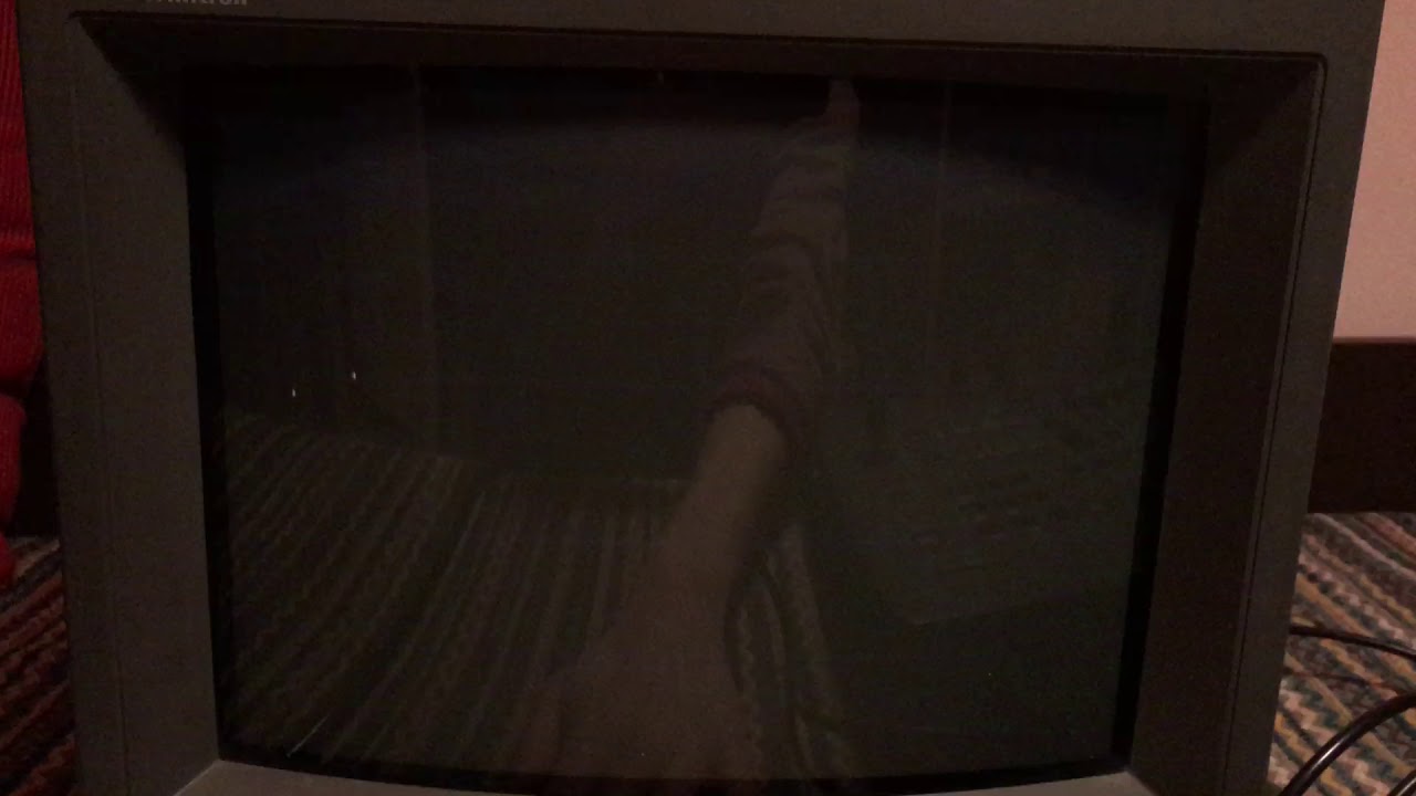

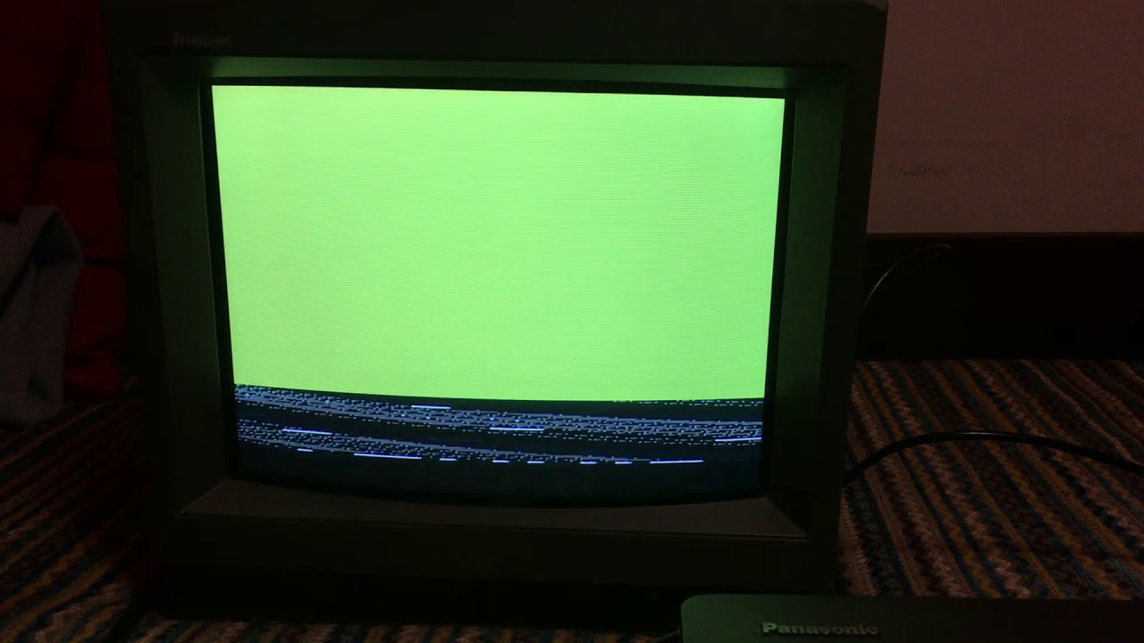

By observing the video output I’m not able to tell what is happening. The pass-through circuits are working, seen in the video below. It appears to be some sort of sync and chroma issue. I have tested both the Component inputs - outputs and S-Video inputs-outputs.
I have tried both camera, visual cortex and video game console inputs into the WJ-AVE5, both with composite video, and S-Video when possible. The same issue is present in both channel A and B. The internal wipe effects is working properly, as tested with one of the channels’ video set to back colour mode.

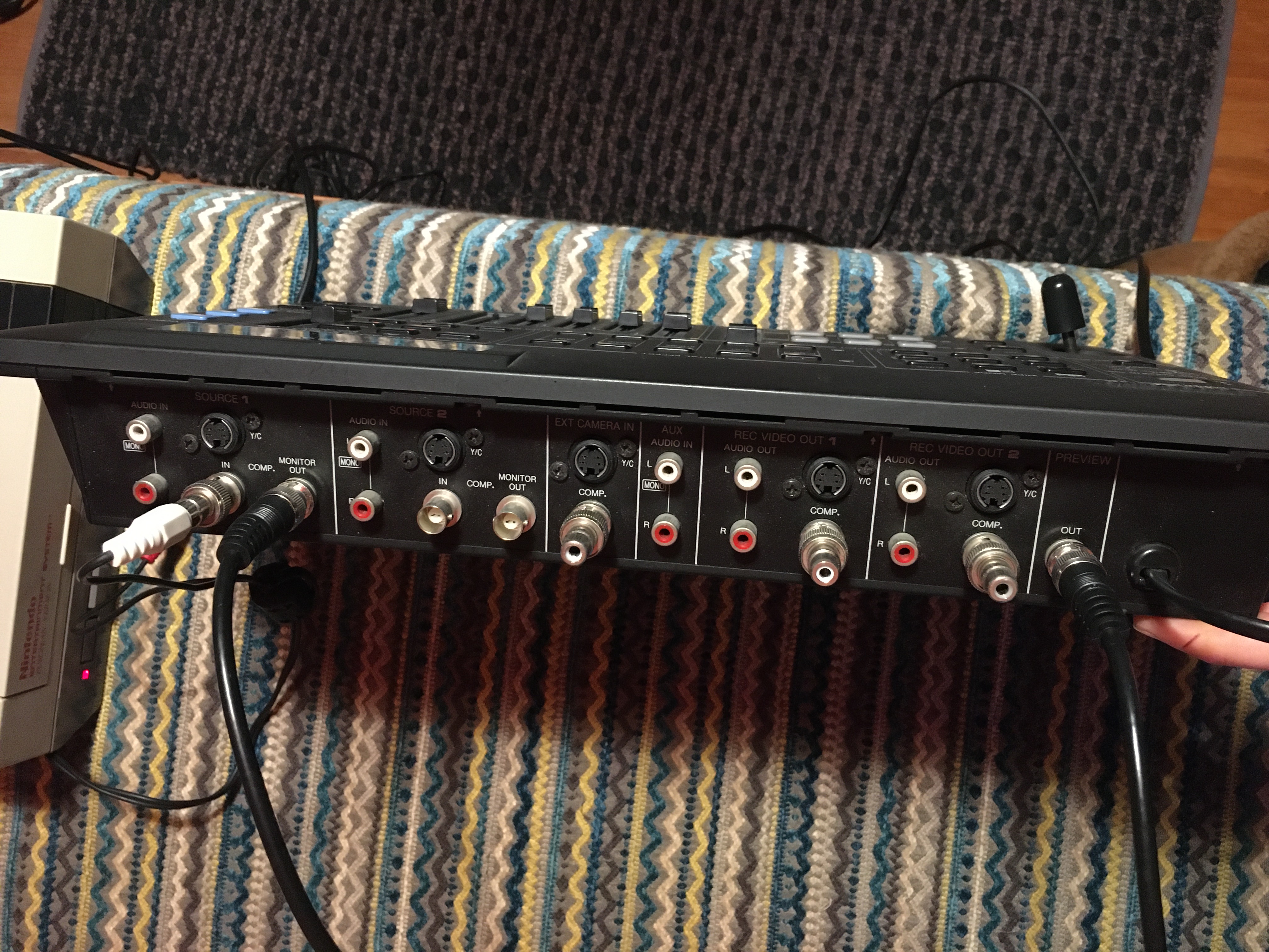

https://www.youtube.com/watch?v=8IHm-swQhnEA photo of the input and ouputs in the WJ-AVE5:
IMG_6842

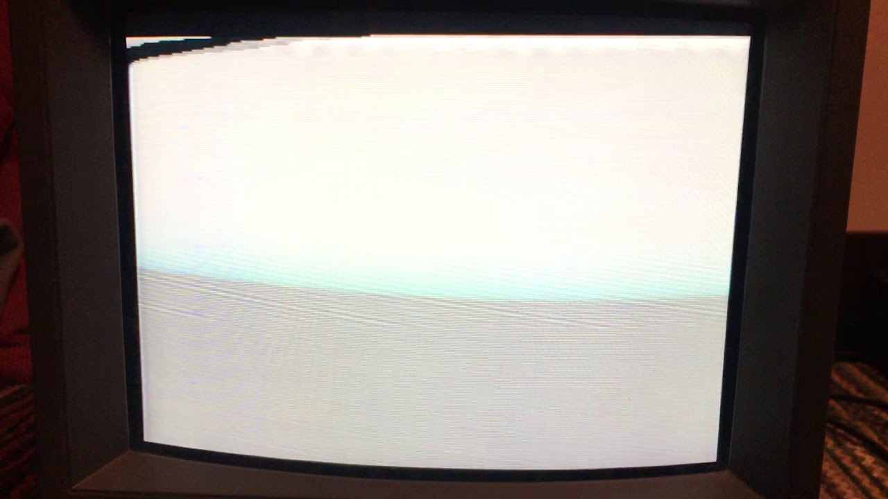

In the video below I input Visual Cortex’s Composite Output into Channel 1 of the Panasonic WJ-AVE5. Cortex’s [Chan. A Mix] switch is on and the video is initially white. I then proceed to zero each color channel and putting it back to max in turn. Red, Green, then Blue.
Note: Strobing is caused by digital camera recording.
https://www.youtube.com/watch?v=gqrvE04clrY
