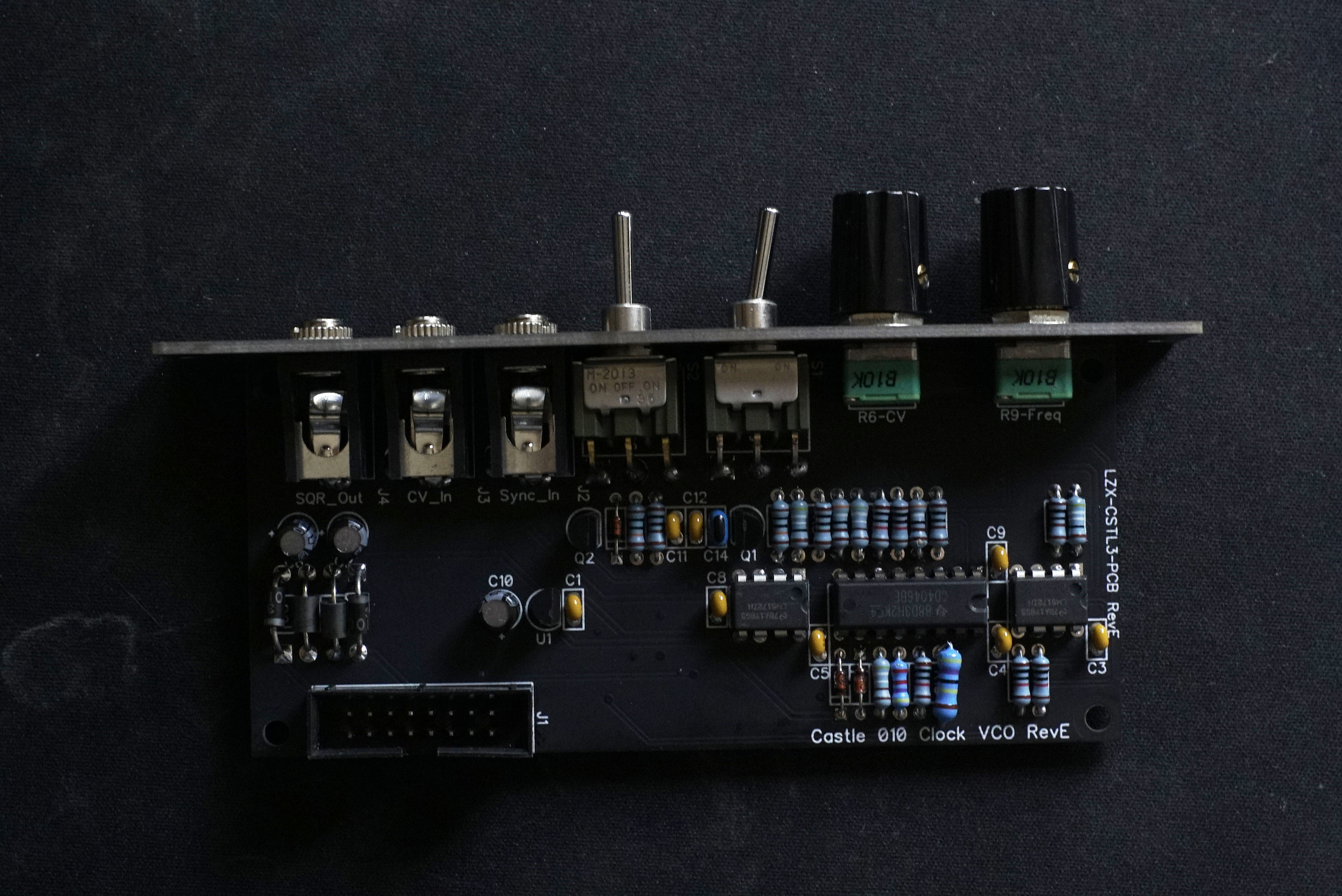

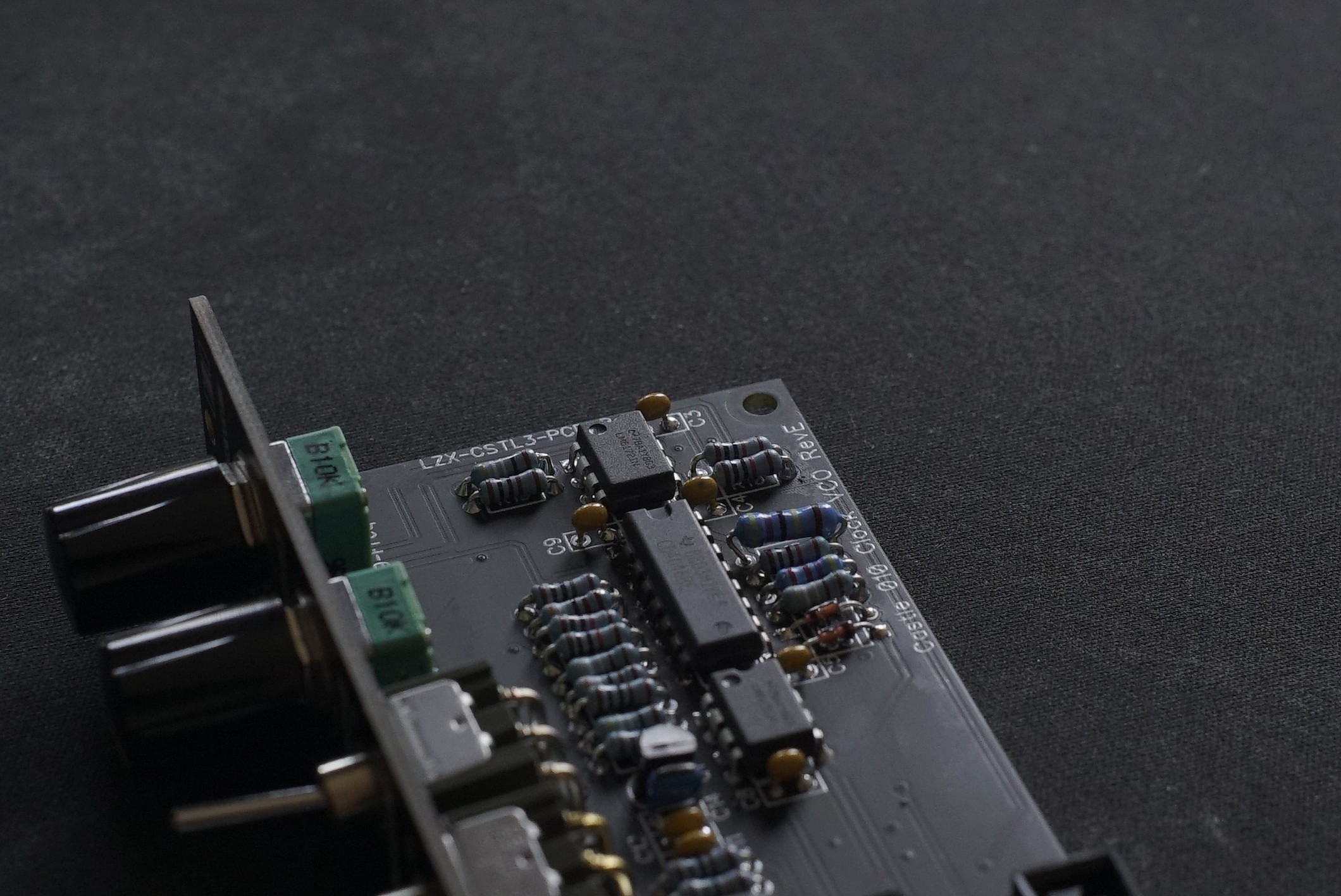

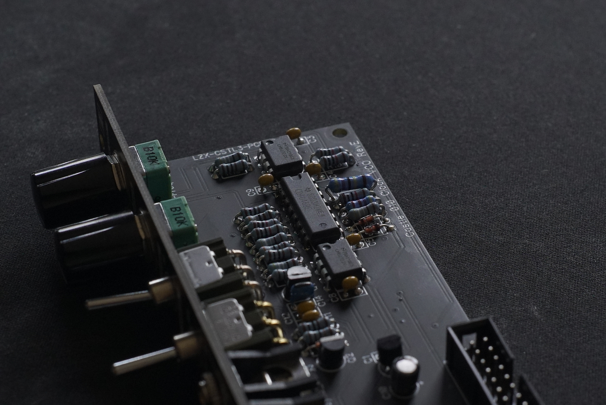

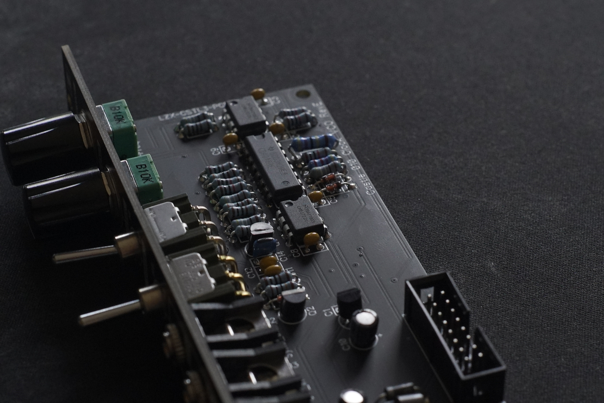

Hey ya’ll! I have a couple Cadet VCO RevE boards that are exhibiting the same issue. I have linked a video to illustrate my issue and a couple photos showing the build itself. Anyone who is willing to lend an extra set of eyes would be greatly appreciated.

Hi Kharmasabits,

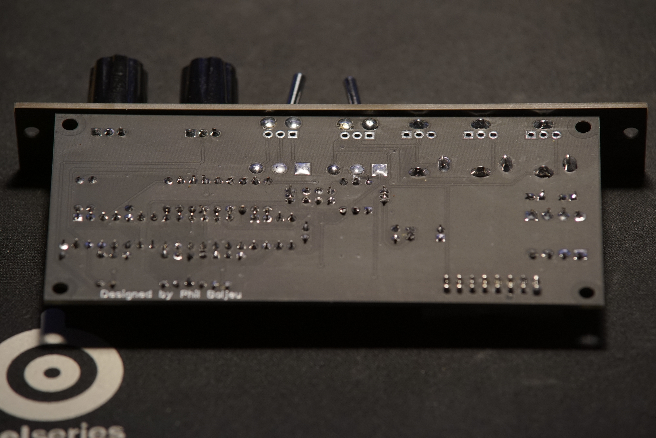

The first three images in your post are the same angle repeated - is that what you meant to post? Could you please upload a solder-side photo if available?
Some of the Castle (not Cadet) VCO behaviour in the video looks a bit glitchy, but the only thing that looks actually wrong to me are the parts of your video where the VCO oscillation is black on the left side of the screen and only starts on the right side. I’m not exactly sure what might be causing that…

Hi aladan, thanks for your reply. Each image is simply a different depth of field making each chip legible. I forgot to mention I originally built this module using the RevD BOM and schematic. I have recently changed out the 1N5711 diodes to the 1N4148. I was expecting the functionality to be similar to that of Prismatic Ray or Cadet IX. In the video I go through several functionality tests. When synced horizontally the square wave stays right justified and only allows limited scaling of the lines. When the board is synced vertical the lines seem fragmented and unstable. In this case the scaling is also extremely limiting. Later in the video I add some VC using both horizontal and vertical ramps. Unfortunately, I don’t have an oscilloscope for testing any of my equipment and my technical vocabulary is almost nonexistent. I’ve never seen one of these modules being used directly so I’m not sure what to expect. I have built many of these and all work great with the exception of these two. I’m sure I am missing something.

#5 — VisibleSignals · 2020-03-10
Look particularly at C11, R13, R14, R15, D5 - they’re part of the sync circuit. A wrong C11/R13/R14 might cause the sync to stretch and the oscillations to start late, or something like that? But I’m just guessing.
#6 — Kharmasabits · 2020-03-10
Thanks for pointing that out! I think I swapped R15 and R21. I will update this as soon as I get them swapped out. Thank you for helping me out. Just got to the point where I couldn’t stare at it any longer… Ha!

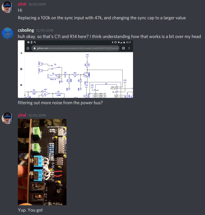

These are not quite the same as the symptoms on my Castle VCOs but I do have some fuzziness / sync glitching like I think I’m seeing in your video. I had a conversation with Phil on Discord a while ago where he recommended replacing R14 with 47k and C11 with 10nF for sync issues:
I have still not got around to doing this actually (it’s been 3 months?!
:grimacing:
