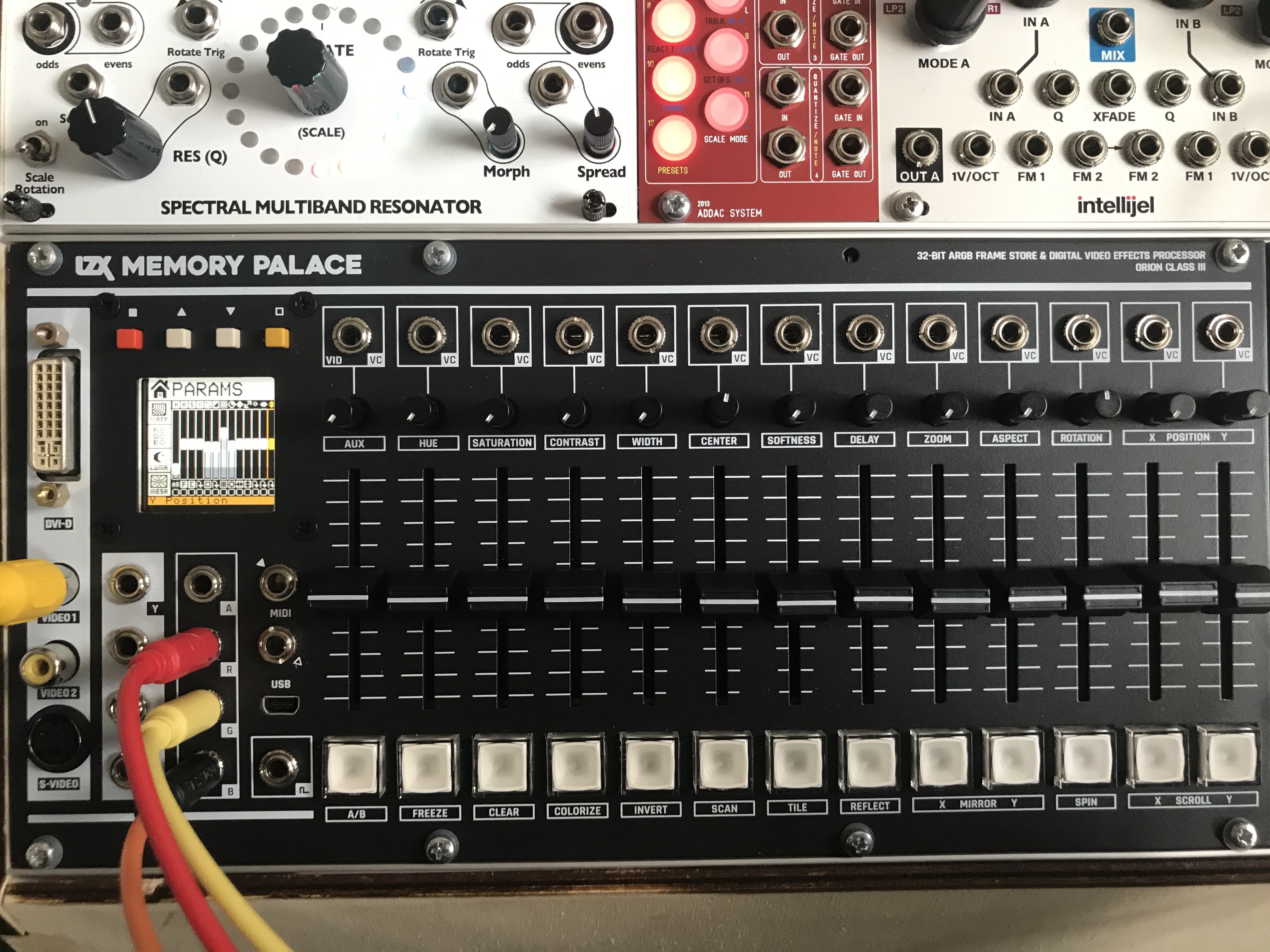

Lastly (and I’m not sure if this is just a default setting) if I center the physical Softness Slider, it is not centered on the Display.

“Lastly (and I’m not sure if this is just a default setting) if I center the physical Softness Slider, it is not centered on the Display.”
Could you share a photo of the display when the softness slider is centered? Have you tried restoring defaults in the menu?

Softness Setting - Can see the slider is noticeably higher than the others in the display
Softness
I have tried restoring to defaults

#13 — Tundra_Tides · 2020-04-15
@Z0NK0UT Any ideas why the softness slider is much higher on the display?
:face_with_monocle:
#14 — Z0NK0UT · 2020-04-15
That’s a V19 bug. Already fixed in upcoming V20 revision.
