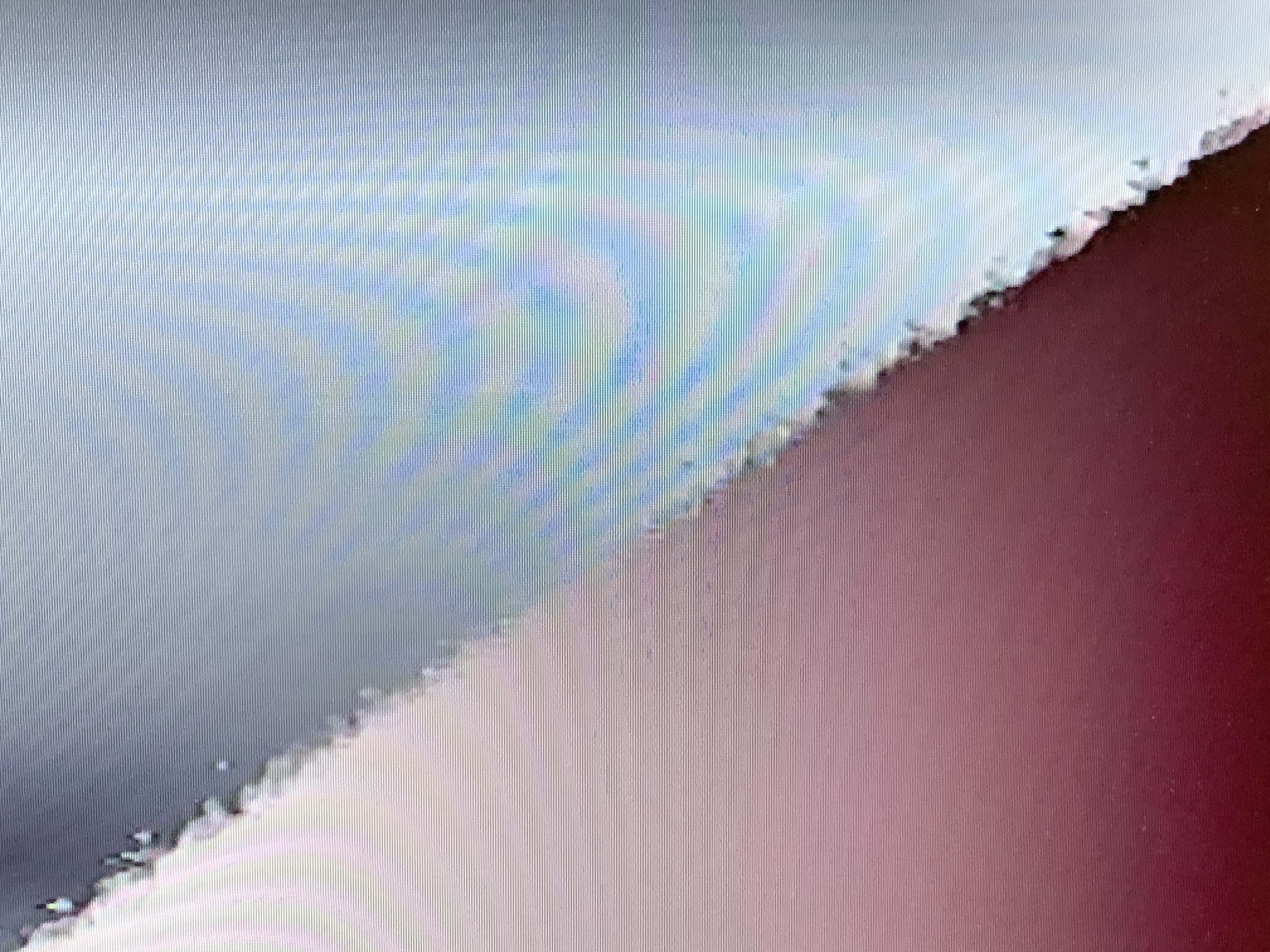

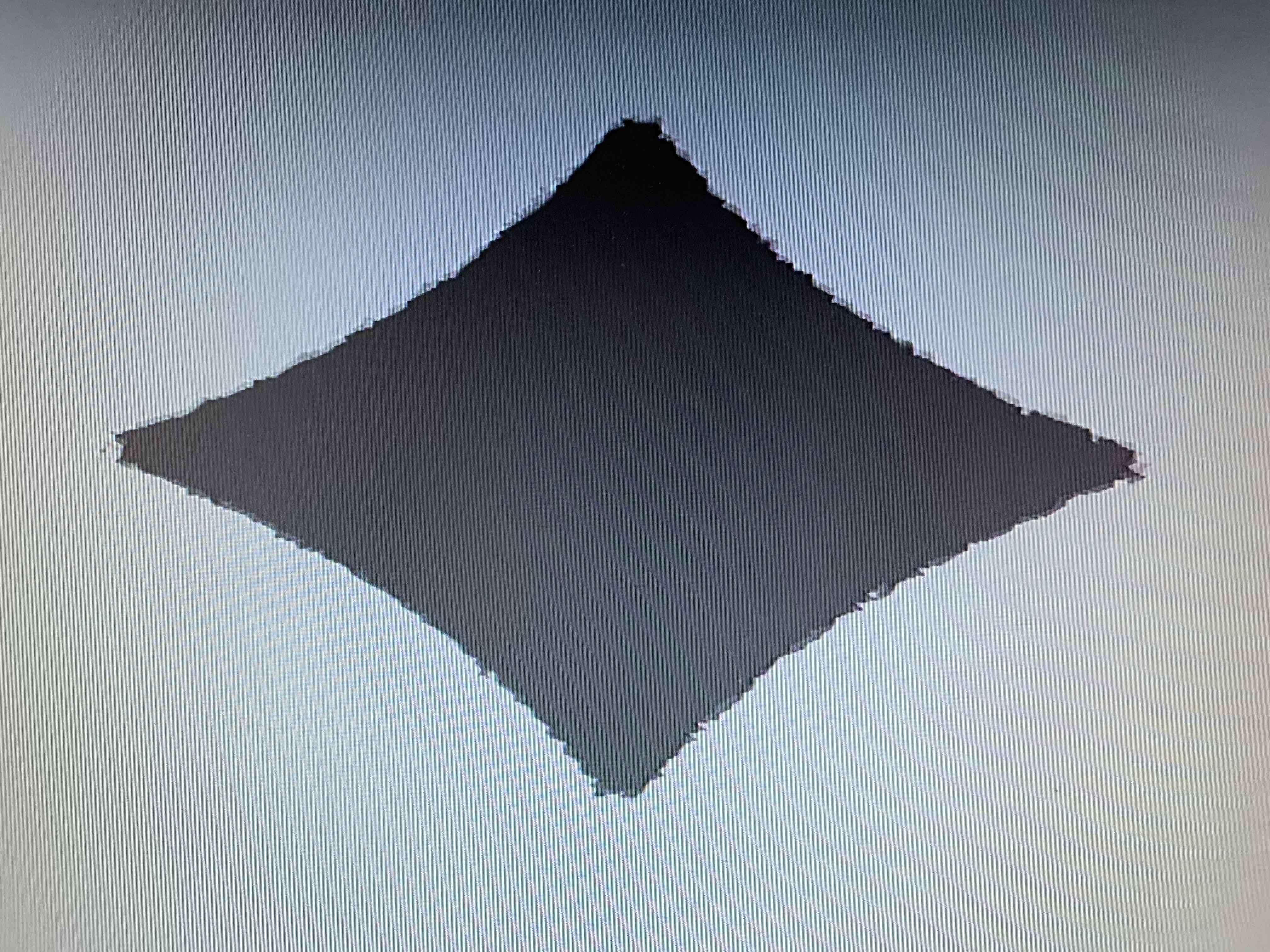

Using Vidiot together with Diver, the quality of the edges seems to be quite poor. In the images you see Diver’s output patched into Vidiot’s key 2 input. In the Vidiot + Diver tutorial video with this exact patch it doesn’t seem to be so bad, so my main question is if this is normal or what I can consider to improve it.

#2 — Z0NK0UT · 2020-04-09
Dirty edges like that usually indicate a noisy power supply. What power solution are you using?

#7 — giantmecha · 2020-11-09
@mauiey Did you ever figure out why you were getting the rough edges with Diver? I’m having this issue as well, and I don’t think it’s the PSU giving the issue…
#8 — mauiey · 2020-11-10
I upgraded my power supply to a Doepfer PSU3, which helped. I now also have a V4 (for a different issue described here) in the chain. Probably it does nothing for the edges but the Vidiot + Diver performance is much better now.
#9 — giantmecha · 2020-11-10
Ah interesting, thanks for letting me know. Strange that my Diver’s edges seem much rougher than other modules on the same PSU, but maybe it’s more sensitive because of its particular circuitry.
