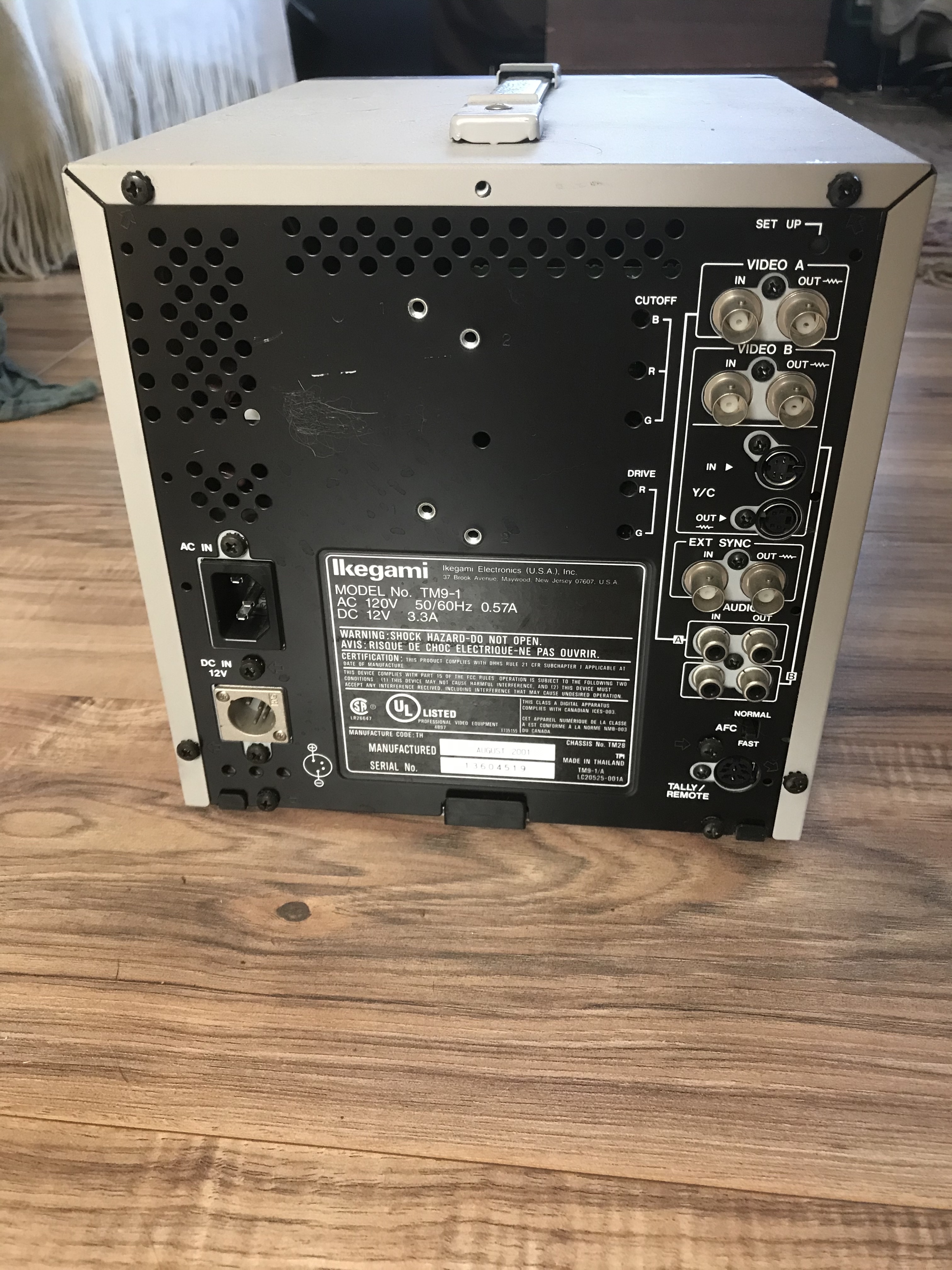

Hi, just getting started with my vidiot and have this basic question. I tried and failed but would like to know why, e.g. what input is the Ikegami missing, do I need an adaptor of some sort, etc.
Thanks in advance for the help!
Ikegami

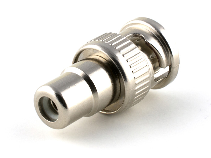

You need to convert from the RCA out on the Vidiot to the monitor’s BNC input (VIDEO A or B). Assuming you have an RCA cable, you just need an RCA to BNC adapter.
rca-to-bnc
#3 — vrtx · 2020-05-10
Awesome-- Thank you!
