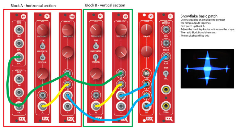

Hi
I’ve made an Illustrator LZX Cadet module patch sheet template with knobs and switches that can be rotated / moved.
With this, you can make patch sheets. Add jack connections with the pencil tool. Set caps to round!
[http://www.reverselandfill.org/uncategorized/lzx-cadet-patch-sheets/]
It is an Illustrator file. (download link on the site)
I’ve made a few example patch files with these:
(and will try to do more in the future!)

This is the kind of documentation work we need to be doing across all our modules. Fantastic work, and thank you.
