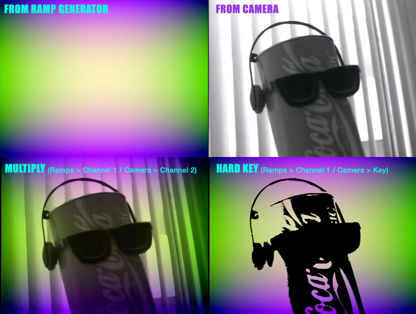

Here are a couple options using just a Visual Cortex:
VC_Compositing
But, again, other modules — Marble Index, Cadet Fader x3, Passage, etc. — can achieve similar effects (though you may need an adtl. module to create that hard key mask).

Dang this is a great visual! Would be cool to see more of this

Thanks. But I’m not trying to do it with the vidiot alone, I’m asking what other modules would I need to be able to do it? The picture above is similar to what I’m envisioning but how would I do it with the Vidiot and other modules even? My point is that I can’t separate the color out of the vidiot. There’s no way to just get the color processor out and put it into a key because the key is don’t process color right?
