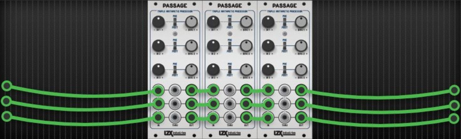

A potential option would be to use three cascaded Passages. You end up with same features but with expanded input possibilities and control. What you give up in rack space you gain by having these for other purposes when not being used to emulate Color Chords. This could also be done with nine Cadet VII Processors and a lot more patch cables.
#4 — JunkRhythm · 2020-05-28
It would look like this or the OUT to THRU would also be another option.

I’m trying to wrap my head around how this would work like a matrix mixer but I’m just not getting it… Are the cables on the left the inputs and the cables on the right the outputs? And if so, how do you get a signal from input channel 1 to output channel 3? Isn’t the first channel only connected to the first channel in all three modules, since the cables in all those jacks break the normals to the lower jacks?
I don’t yet have a Passage, so maybe I’m misunderstanding how the Passage works?

Picture above is not how I would do it.
Output and thru input are RGB, input 1 mults to all 3 outputs with separate gains for setting color. Then you can cascade outs to thrus to get more inputs with more modules.
Even one Passage lets you mix RGB and one signal that you can set the color of.

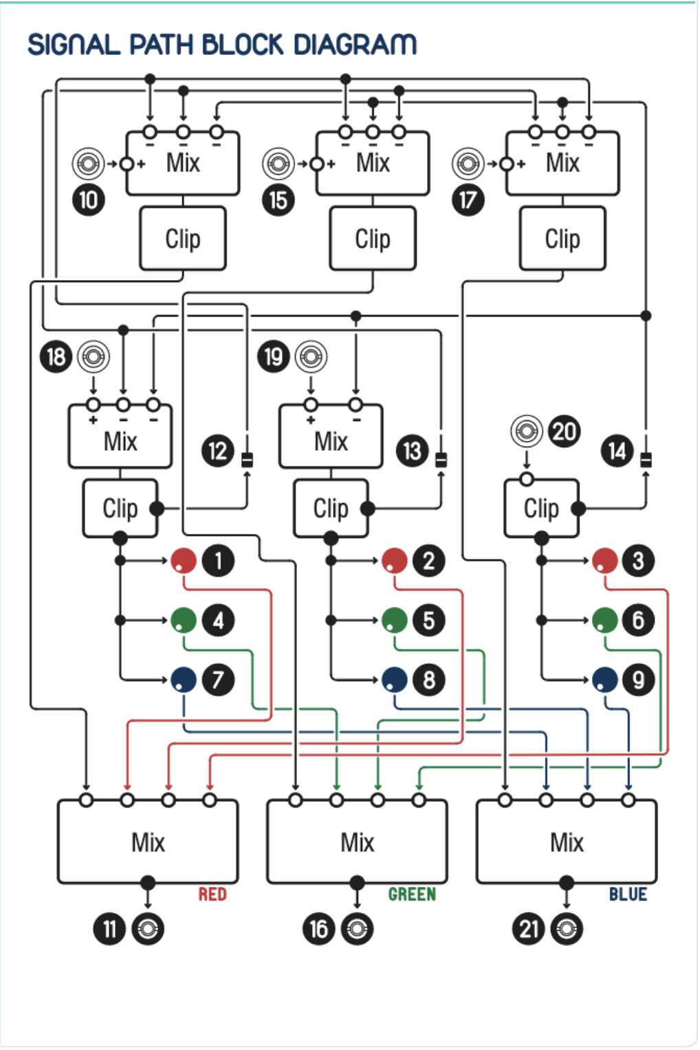

Check out its block diagram signal flow on this chart:
Screen Shot 2021-02-27 at 3.07.38 AM
Say if you patch a centered, white diamond shape into Layer 3 (18) of Color Chords, i.e. you turn all of the RGB offsets (1,4,7) fully CW. Then you patch a centered circle into Layer 2 (13) and set it to be only red, i.e. 2 is fully CW and 5 & 8 are fully CCW. If Layer 2’s opacity fader (13) is all the way down, you likely will not see that circle appear until you adjust the fader. As you increase it all the way to its top position, the brightness from layer 2 will be subtracted from layer 3, allowing the red circle to be visible in the middle of the white diamond and not just go over 1V which the encoder will clip. There are many useful in between spots on the fader opacity positions but if you’re trying to stack a bunch of patterns, pushing them all the way up will remove any blowing out to white problems where all pixels are >1V.
