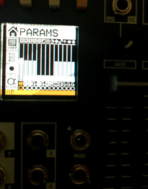

https://www.youtube.com/watch?v=jY4b899_fHAThe final thing I’ve noticed is whilst you’re in the following settings WARP / ARGB / CHRO / ALPHA.
The A/B Slider on display only goes as high as half way, then it gets stuck. Moving the slider all the way up still leaves it half way on display.
Screen Shot 2020-06-01 at 8.36.35 pm
Not 100% sure if this is just my unit that this fault is showing up on or if it’s a bug in the firmware.
Would love it if MP users could also try it out and see if you get the same result.

The Softness slider visualization and AUX slider bugs have been fixed in the upcoming firmware revision. As stated above, Colorize automates the Hue control, so that is normal.
