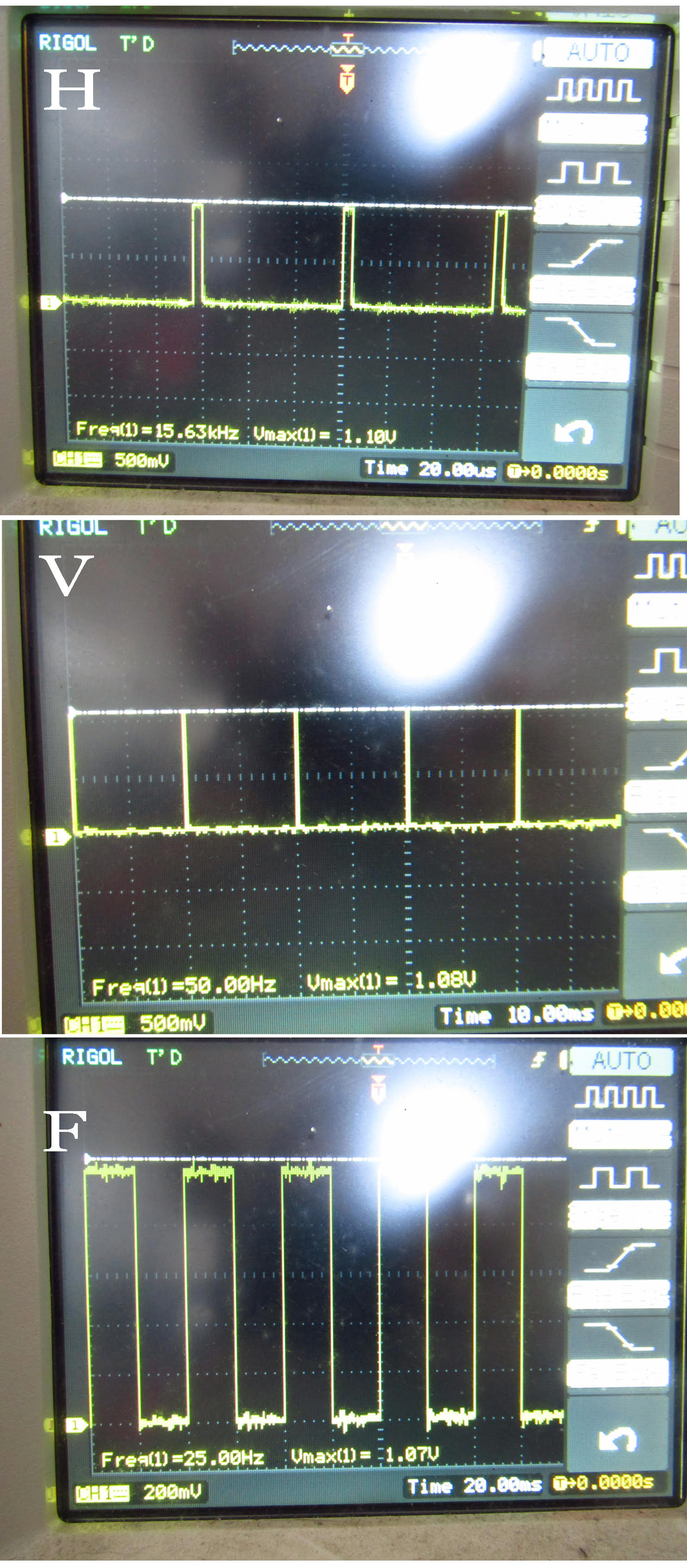

power up C1 and measure (scope) the sync outputs of the frontpanel (H, V and Frame)
You should see pulses like these: (take note of the frequencies)
