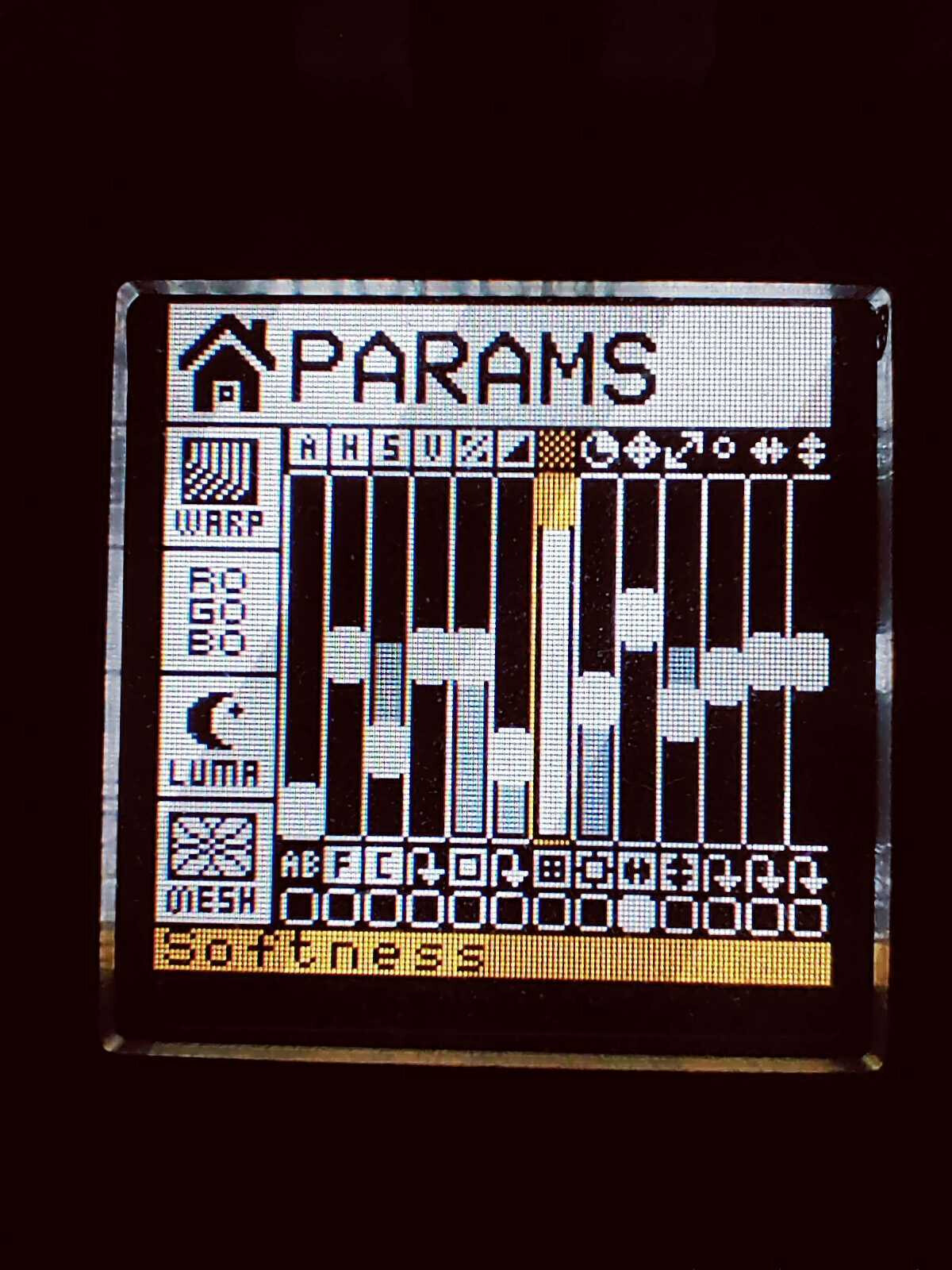

In PARAMS window not seeing much in the way of source options other than media and RGB. In the key mode there is an option for alpha masking ext source. Route options don’t include an ext source. The only imagery I can access is whatever is loaded from media.
Hey Mike, you have to select the RGB mode in the source menu to see external imagery that’s plugged into the MemPal’s input jacks.
#16 — Z0NK0UT · 2023-03-20
Here is what the menu looks like in the current firmware. The second square down on the left controls the input.

That did the trick! Video signal on A and B busses is streaming into TBC2. Thank you for the final key. I had been fiddling with rgb ports earlier before I learned about the sync switches on the back of the module. The rest is up to me now for implementing MP whatever way.
