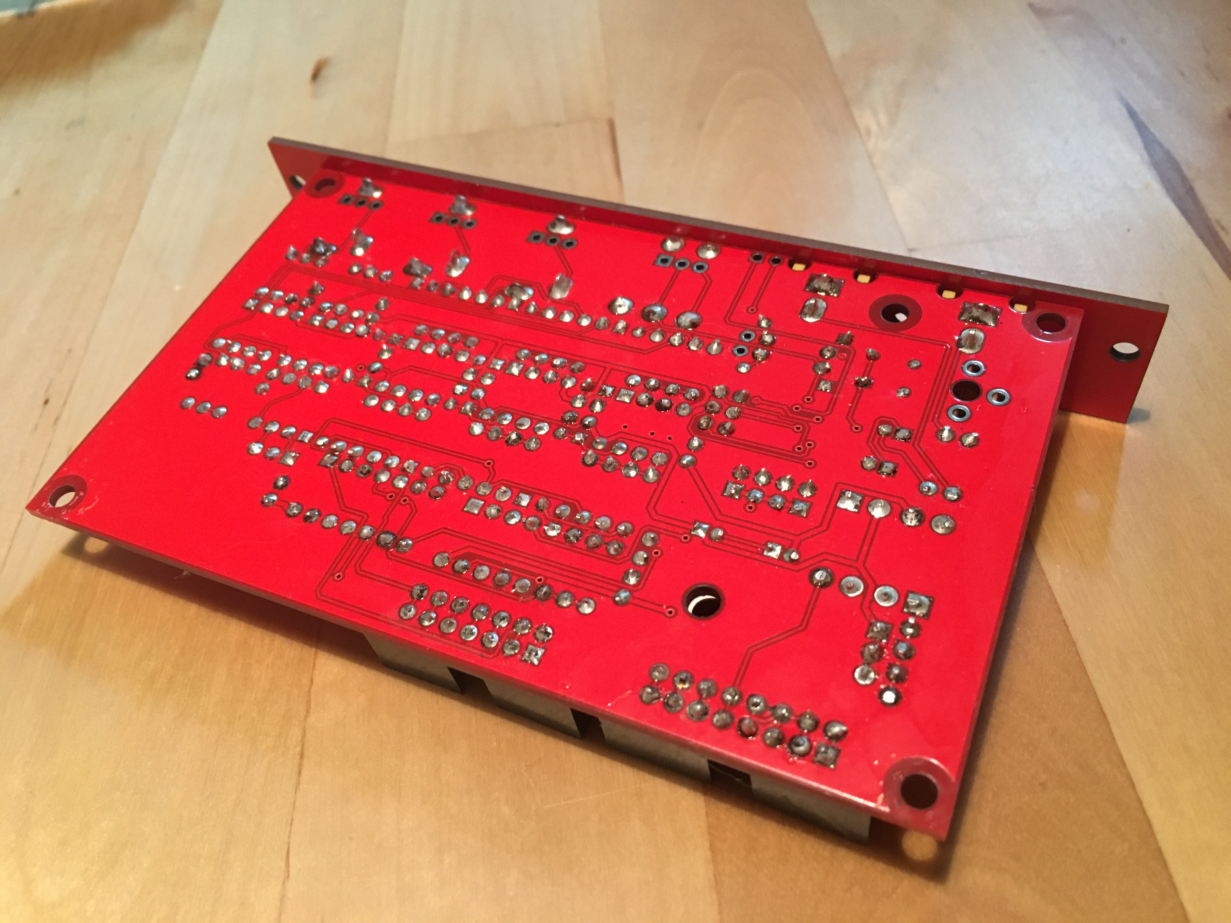

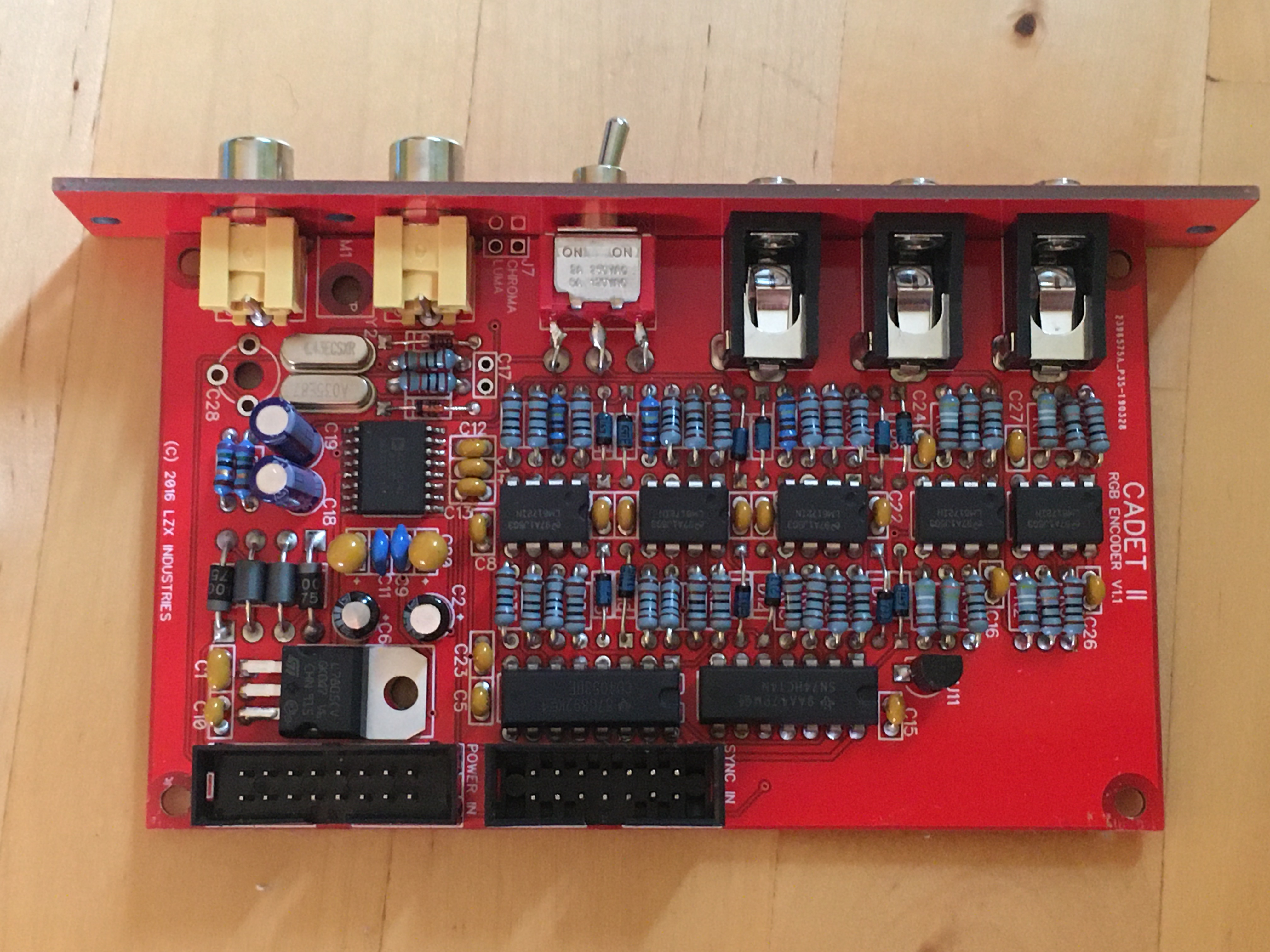

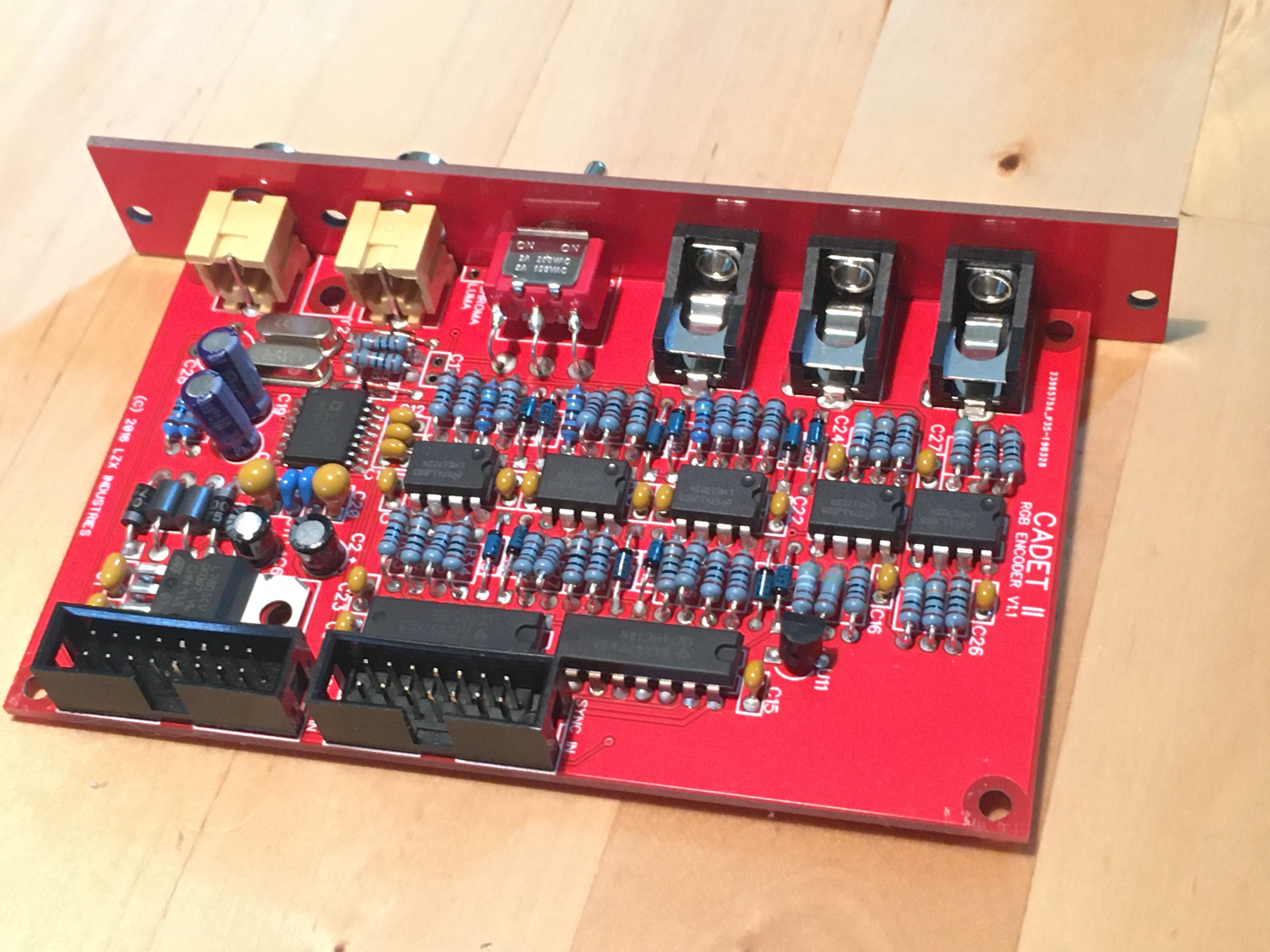

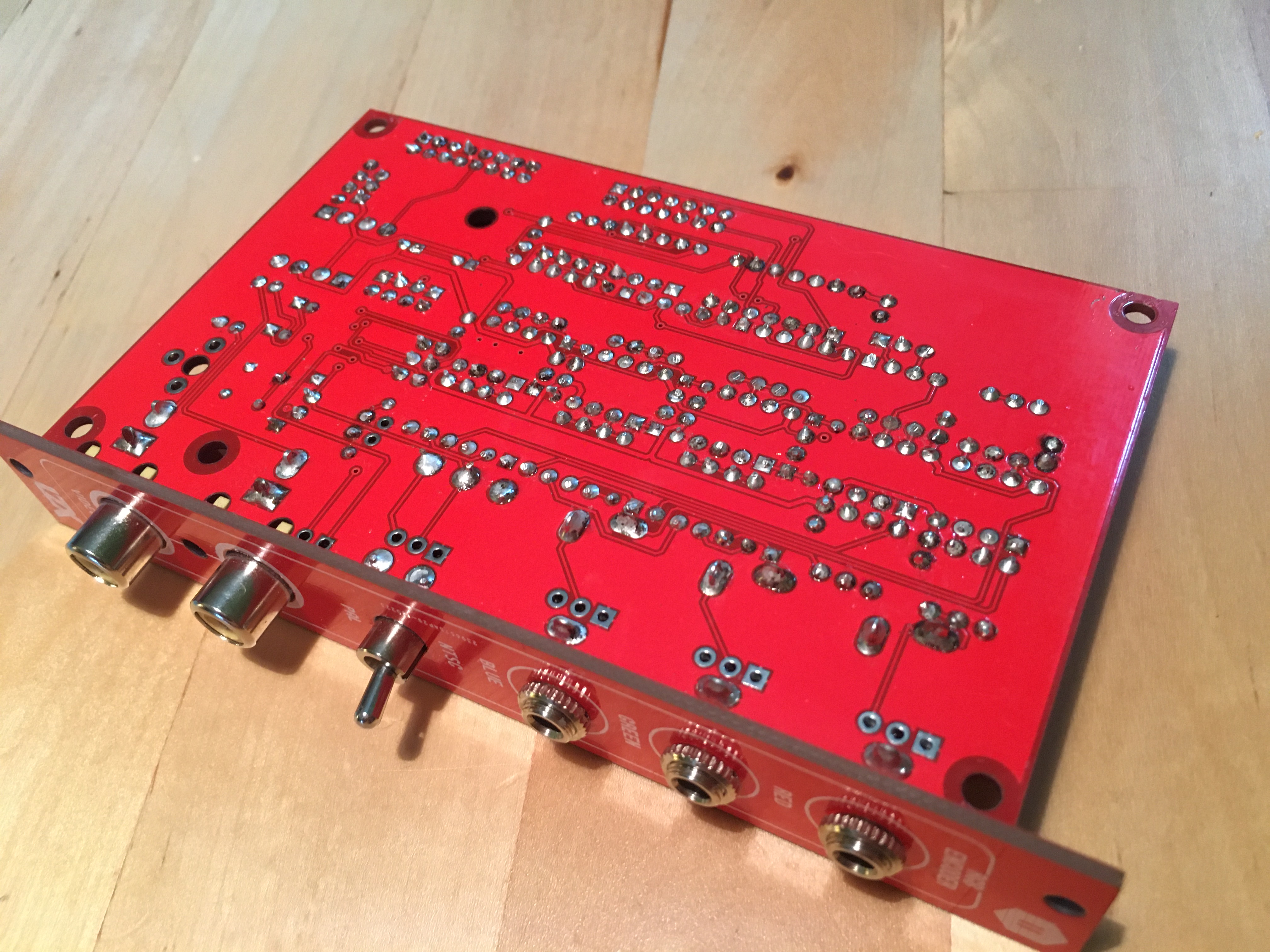

Hello I’ve currently built one of each Cadet except V, VI and X and have been experiencing a strange problem with color output.
First of all the colors don’t seem to correspond to the inputs labeled on the RBG Encoder (I’m using this demonstration as a reference). The VCO output, when plugged into Red on the RGB Encoder makes green, into Green a desaturated red, and into Blue a yellowish-green.
Also the colors seem to gradually become increasingly desaturated over time after I power up the modules until around 10-20 minutes after power up the output of the encoder suddenly becomes completely black and white. After turning the eurorack power off and on again the output is back to the original color and this process repeats itself.
These problems seem similar to the ones described in this post:
I reflowed some points on the RGB Encoder, and checked everything around the rbg to composite encoder and the crystals. The parts placed seem to be correct and i got something like this: >  >  > The image quality is kinda crap sorry about that, i was in a rush. Those are not white bars they are rather reddish/pink. But im still getting only this output, it does not matter in which color i plug the vco. > Next up im going to check everything again according to the BOM and Schematic and reflowing e…>
I’m using the correct region setting on the RGB Encoder and Sync modules, using a Doepher A-100 power supply, an lzx sync distribution cable, and have the output of the Encoder going directly to a CRT.
I’m wondering if this is salvageable, if I should get another PCB and parts and try again (afraid I’m starting to make things worse the more I try to resolder stuff as I’ve been trying to fix this for a while) or if there’s someone I could buy a properly-functioning pre-built RGB Encoder from or pay to build one.

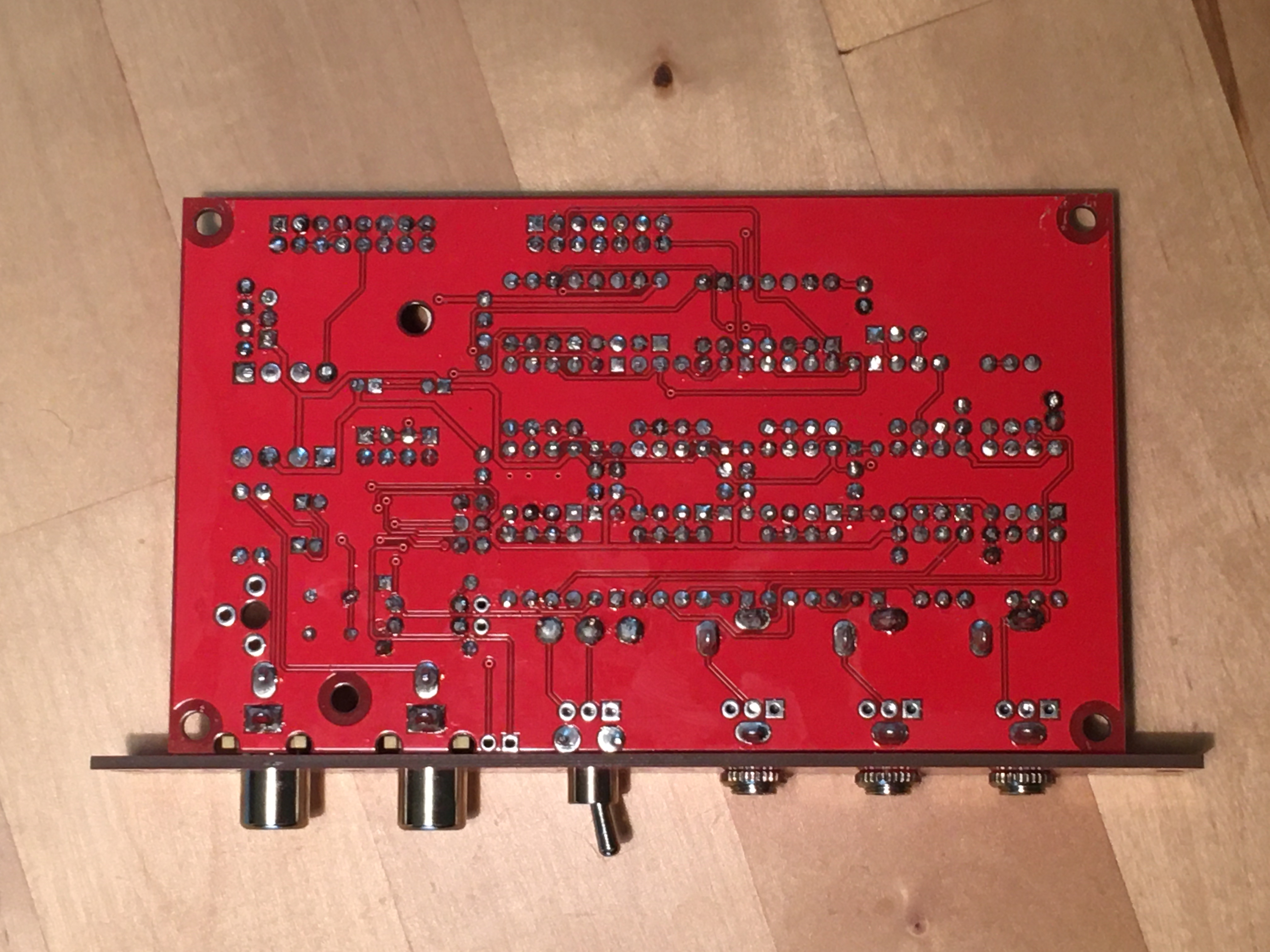

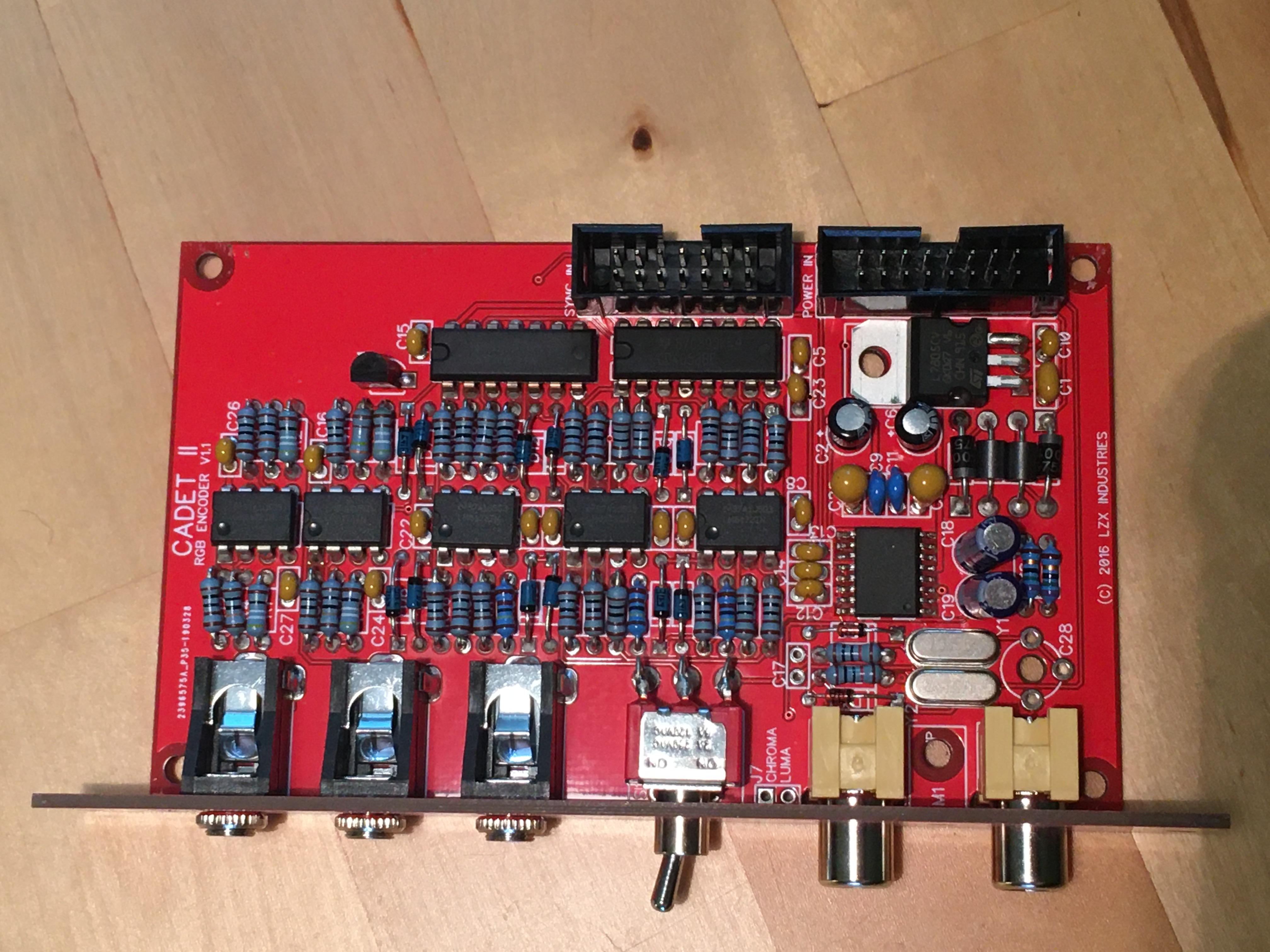

Attached are photos of the RGB Encoder as I imagine that’s probably the module that’s malfunctioning. I’m happy to provide more detailed photos of any part of the board or photos of another module if people think it could be a problem other than the Encoder. Thanks!

All the parts locations look ok, I referenced it against mine

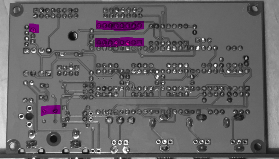

Some solderjoints look like they could use some reflowing. pic 4 near the 7805 and some of the lm6172 pads.

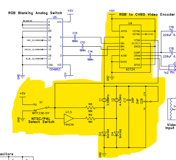

The fact that B&W video still works means that the error more or less must be in the yellow area here:
I’d do a sanity-check with a voltmeter at the middle terminal of the switch, but i wouldn’t have very high hopes of that being the issue.

That translates to this bit
and this IC: image

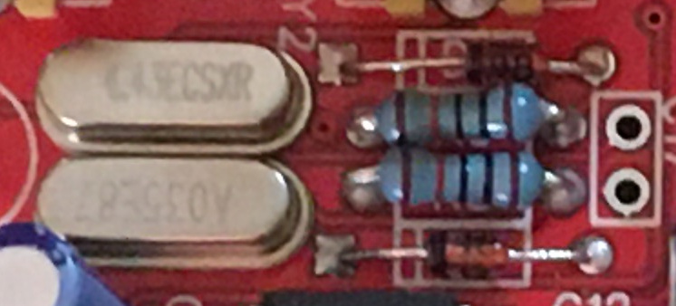

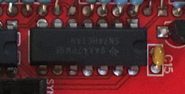

As well as the smd IC and the switch.It’s hard to tell from the pictures, but there might be some cold joints in these areas:
The top left one is the 5V regulator, this is probably not your problem, but a little extra solder on that pin can’t hurt.
Top right - This is the inverter that drives the crystals - I don’t think these are to blame, but some of those joints look like they may not have proper solder wetting (Make sure the soldering iron connects properly with both the pad and pin, hold it steady for around 3-4 seconds until the solder sticks to both the pad and pin all the way around the pin)
Bottom left: This is one of the crystals - there is something funky going on with the soldering here. If you’re unlucky, you’ve managed to short it to the plane beside it. Either way both pins look like they could use some careful cleaning, inspection, and re-soldering.
