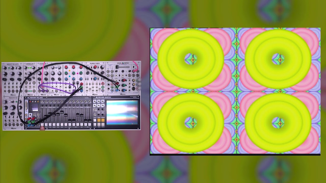

Escher Sketch is the best possible envelope for video because you can “draw” the envelope on the screen and then store it for looping or retriggering.
https://www.youtube.com/watch?v=4bkBOmJjhY4
