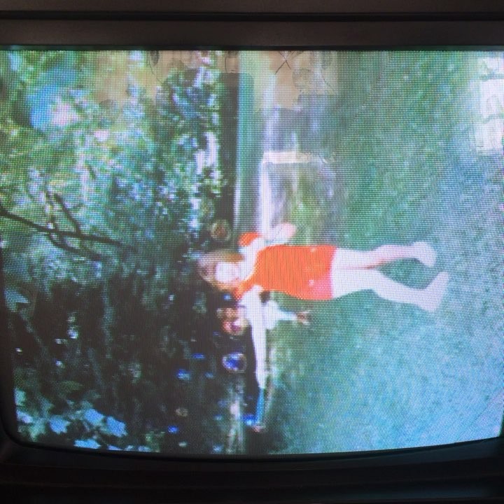

instagram.comhttps://www.instagram.com/p/Bnba422gQPwimage
https://www.instagram.com/p/Bnba422gQPw#lzxpolarfringe #lzxindustries #lzx #lzxvisualcortex #videosynth #videosynthesis...Link: @nicholepichon
so you are wanting to do something like this? https://www.youtube.com/watch?v=icVRkEx_7aI is this the video you are talking about?
the very first patch shows how one color video is composited over another using a key into the opacity input
as said above or shown in the video you can use a doorway
I have been using a polar fringe and topogram to help shape the key

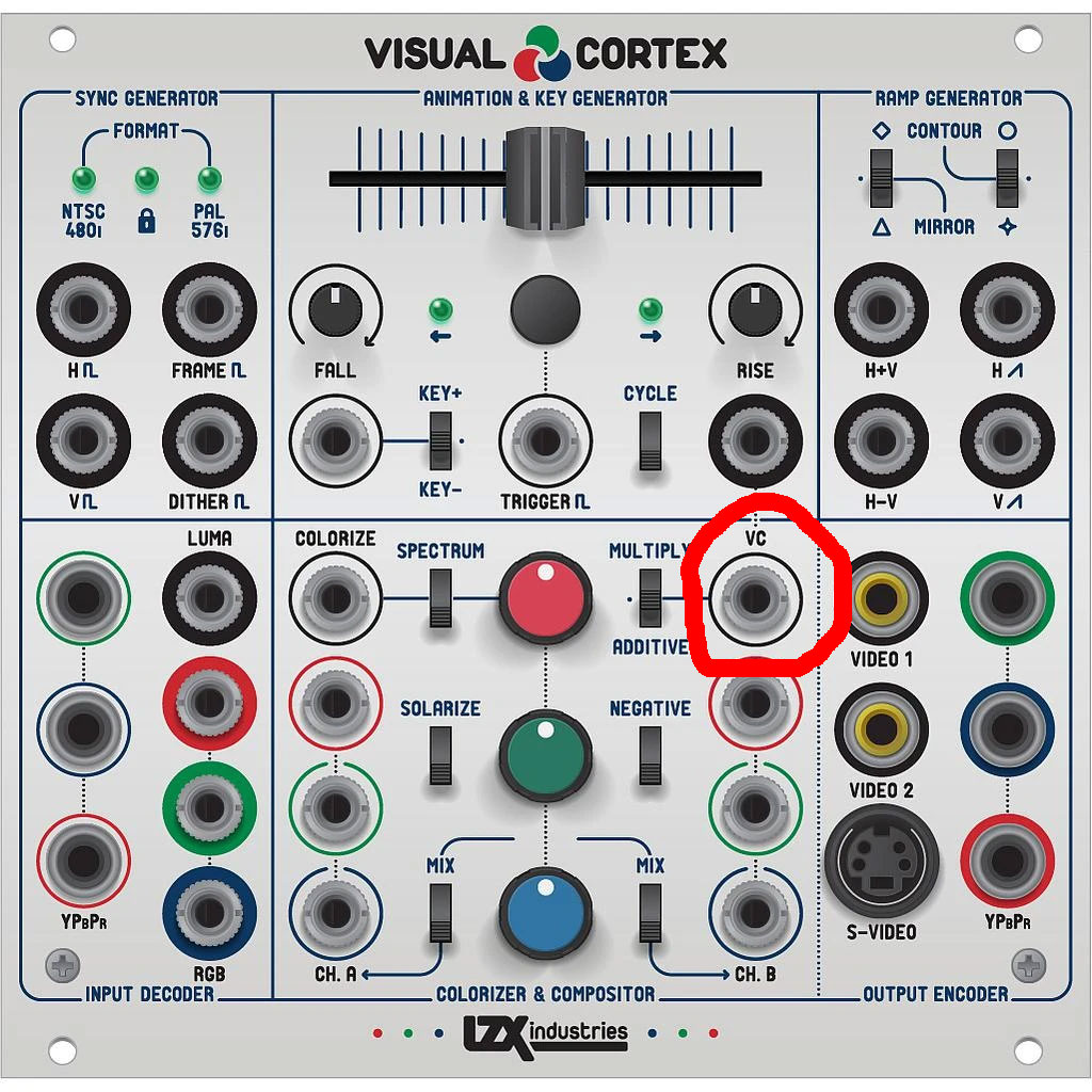

Just want to clarify this because I purchased a visual cortex and misunderstood what you were saying. I assumed the visual cortex key input would allow me to input the output of the doorways soft key but that is not the case, the key is still hard.
#15 — sean · 2020-07-17
To get a soft key, route the signal from Doorway into the “VC” input on Visual Cortex (this is alternatively labeled “Composite” on some Cortexes). This is the voltage control of the mixer.
VCinput
Composite mode switch should be at its center position.
#16 — Genlok · 2020-07-17
Oh my god how did I not know this? I was under the impression this was VC for modulating between different mixing modes, wow I completely misunderstood lol
#17 — sean · 2020-07-17
Its panel placement doesn’t exactly make this intuitive, for sure.
