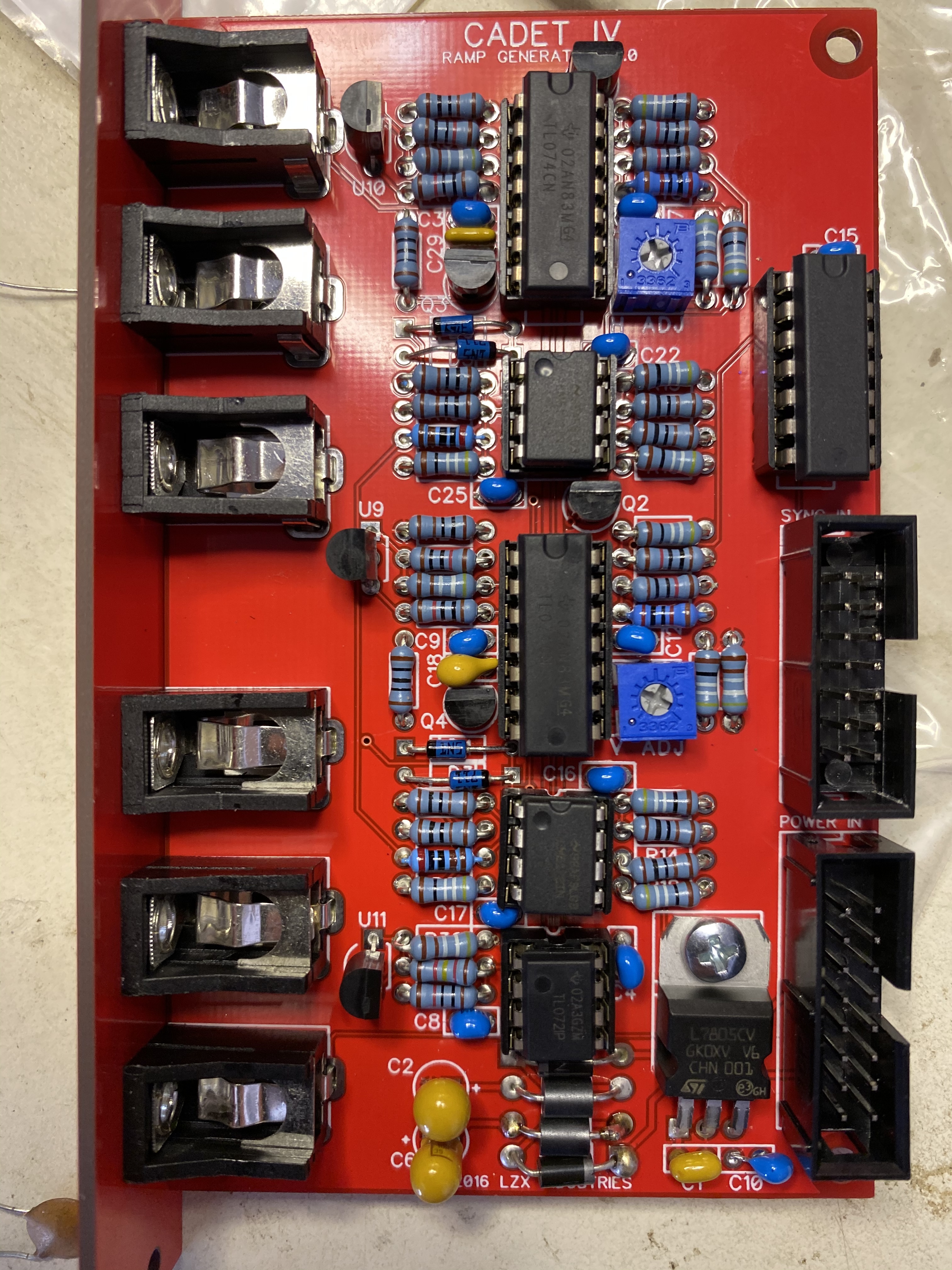

Hey folks, quick question. Building a Cadet IV Ramp Generator and the horizontal section appears to be functioning correctly. However the vertical section looks like I goofed something up. The top jack outputs a flat color without a gradient, the middle jack outputs nothing or black and the bottom outputs something identical to the top. I have been checking my board and I can’t seem to locate a problem. Thanks in advance.
#2 — rempesm · 2020-07-02
Can you post a hi res shot of the back of the board as well?
#3 — VisibleSignals · 2020-07-02
Great photo - excellent resolution!
The horizontal and vertical circuits are basically separate and essentially identical. If one works and not the other then there’s likely just a component or solder point in the horizontal circuit that’s at fault. Could you please post a photo of the solder side of your board so we can peer at it and critique your work?
Check the soldering on R20, R29, D4, U3. Also D2 looks ugly (but is probably fine). Some of your other solder points look like they could be heated a bit more to flow the solder better. You might have a dry joint?
Also try reseating the ICs - those sockets aren’t the best (the ones with rounded holes are better).
If nothing’s obvious from the photos then the next step is to start checking voltages. Do you have an oscilloscope?

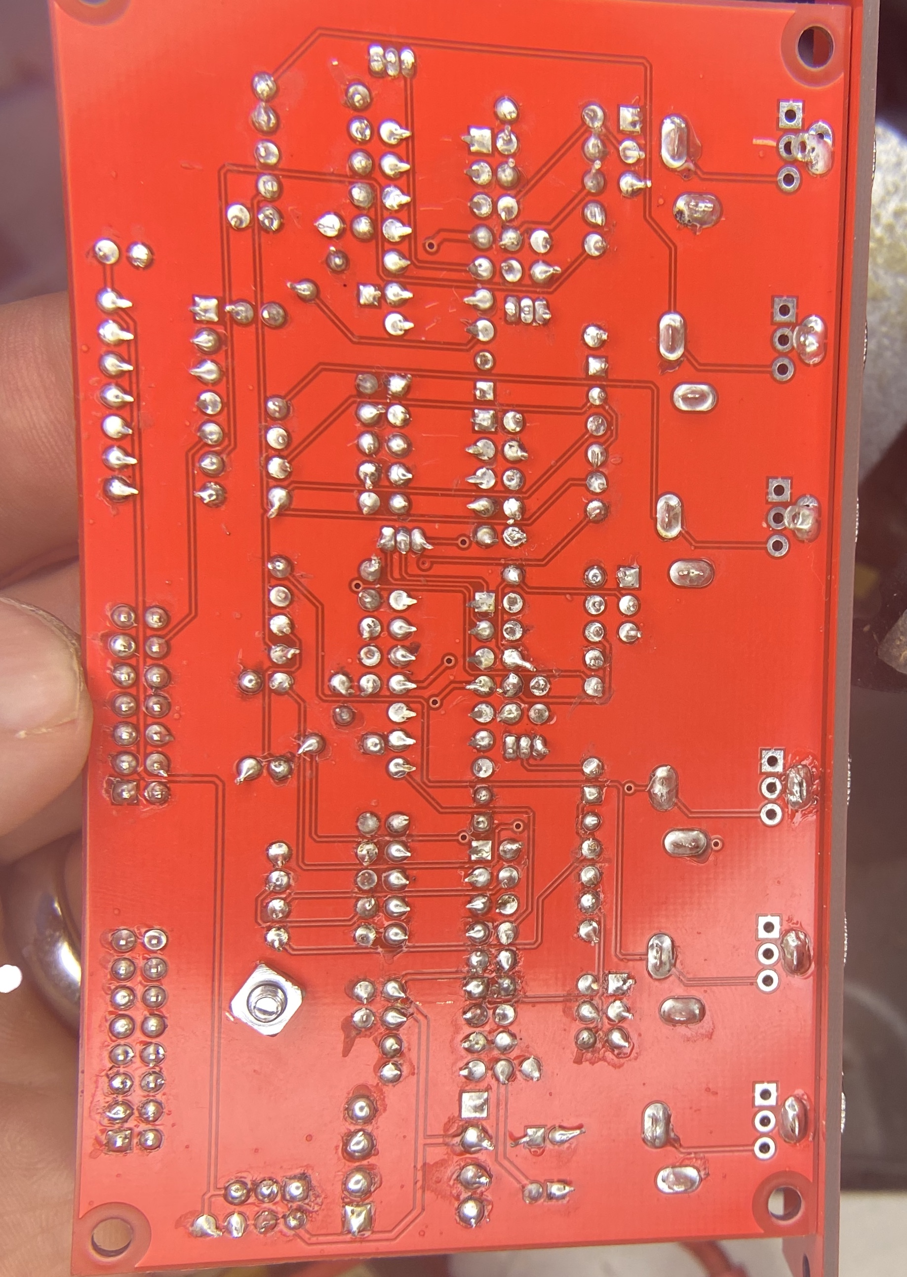

#4 — BittahWizard · 2020-07-02
Thanks, I will check those. I don’t have an oscilloscope but that be something I will be needing in the near future. Here is the back of my board.
#5 — VisibleSignals · 2020-07-03
I can’t see any obvious dry joints from that side, which is a good start.

Check you didn’t mix up the transistor (BS170 Q4, 2N3906 Q2) and the voltage references (TL431 U9). They all look the same.
Is there a missing bit of track near the base (middle pin) of Q2? It looks like it’s missing in the photo, but it could just be shadow. That would probably cause the problem you’re seeing.

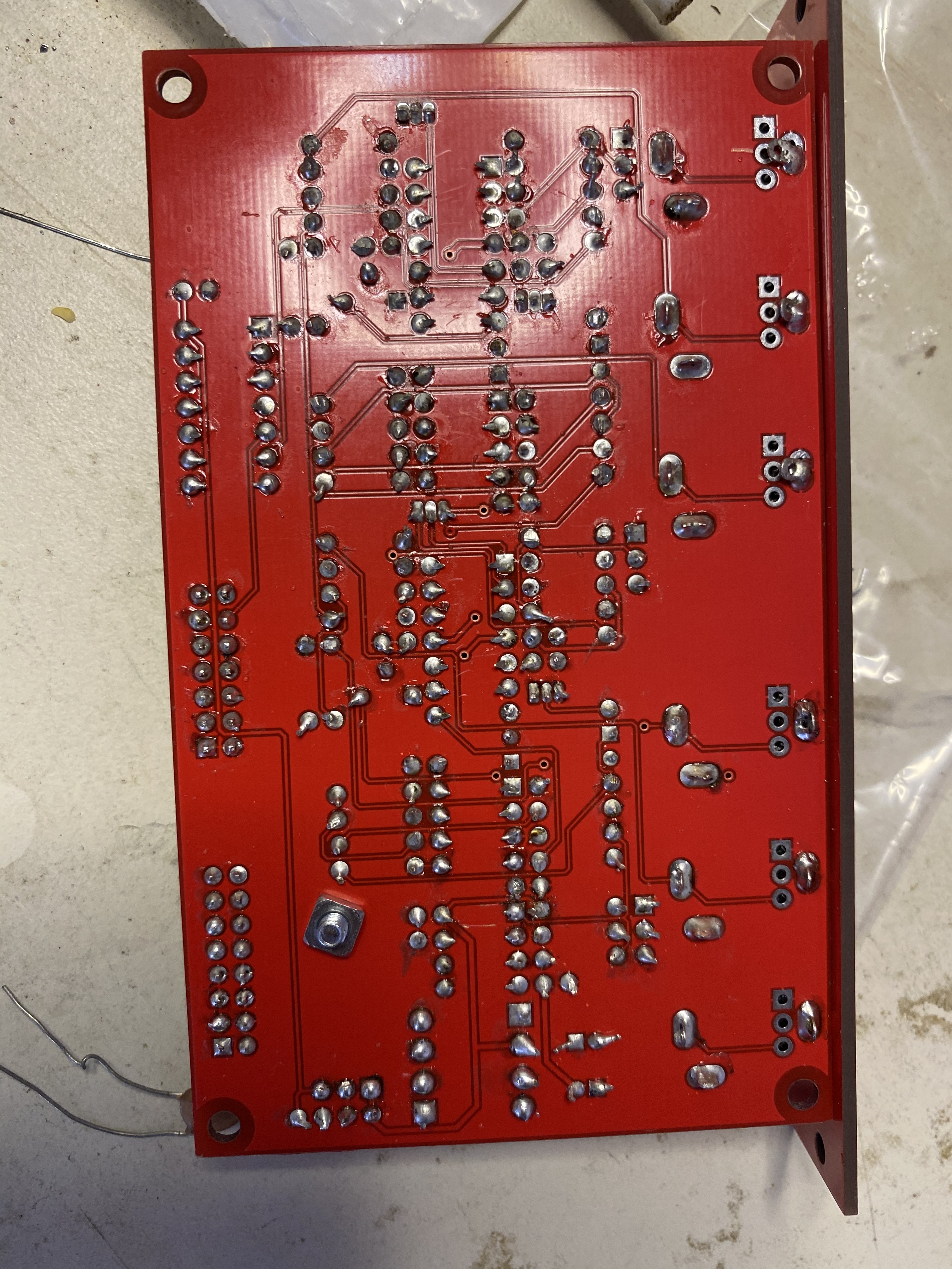

#7 — BittahWizard · 2020-07-03
It is the shadow on the photo unfortunately, I have gone back through and re-flowed solder as many places as I could think of and the places you have recommended. I tried switching the IC’s and it’s still the same. I tested the sockets and they are working (I used my multimeter to test that legs from the IC’s were connected to the solder joints).
Just to clarify, I am having issues with the vertical section, not the horizontal.

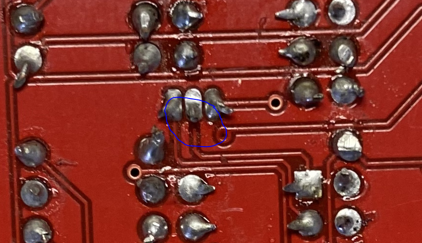

clean your pcb. some pads seem to have tin residue between them
in general, use a bit less tin and snip off your wire leads shorter.
all pads should look like this:
parts placement seem to be ok, as far as I can tell.
